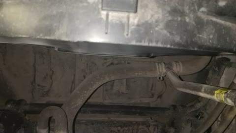

My vehicle starts vibrating, few seconds after I turn the A/C on.
So, I heard that the cooling fan may be the cause for that, I had a video recorded and might help diagnosing that.
I am in doubt whether this is the cause or something else.

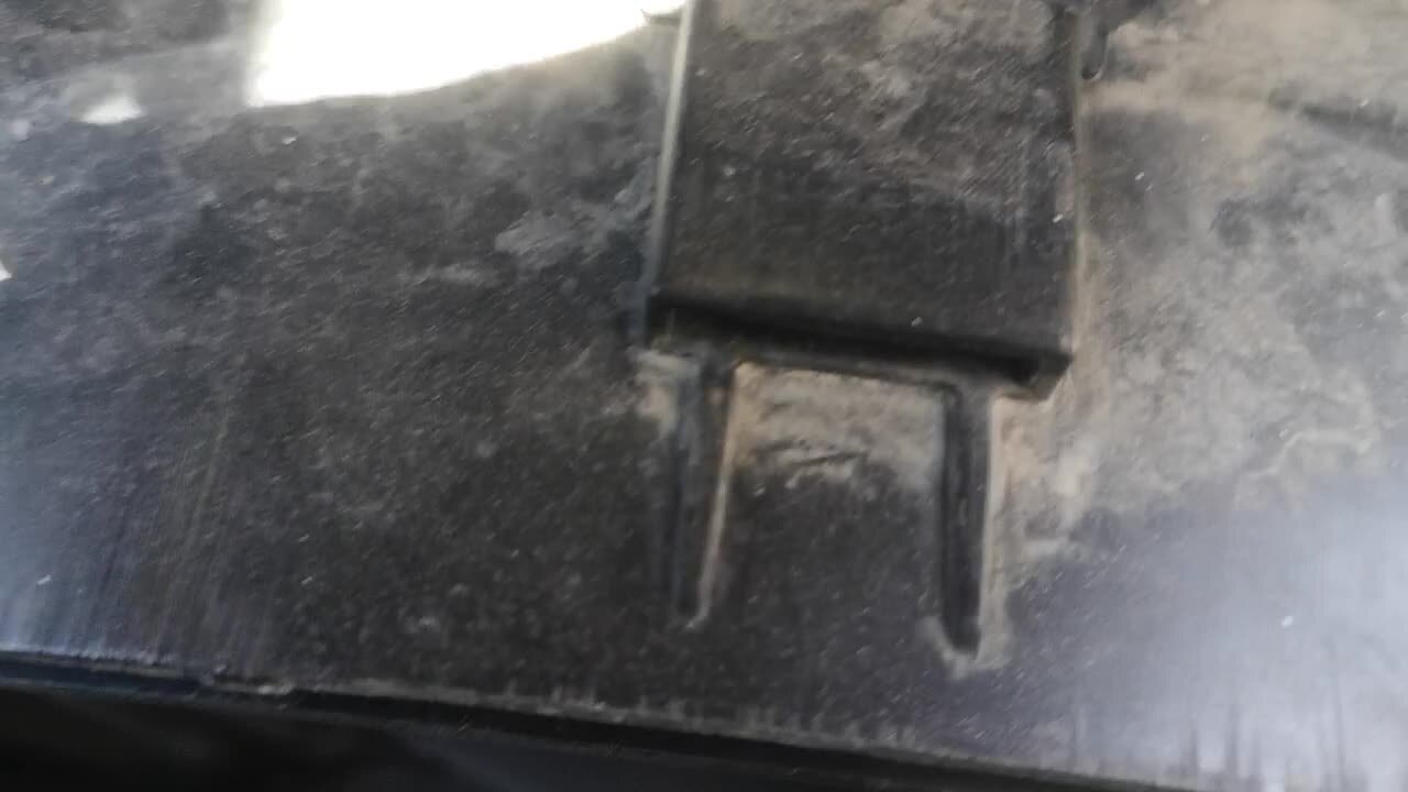

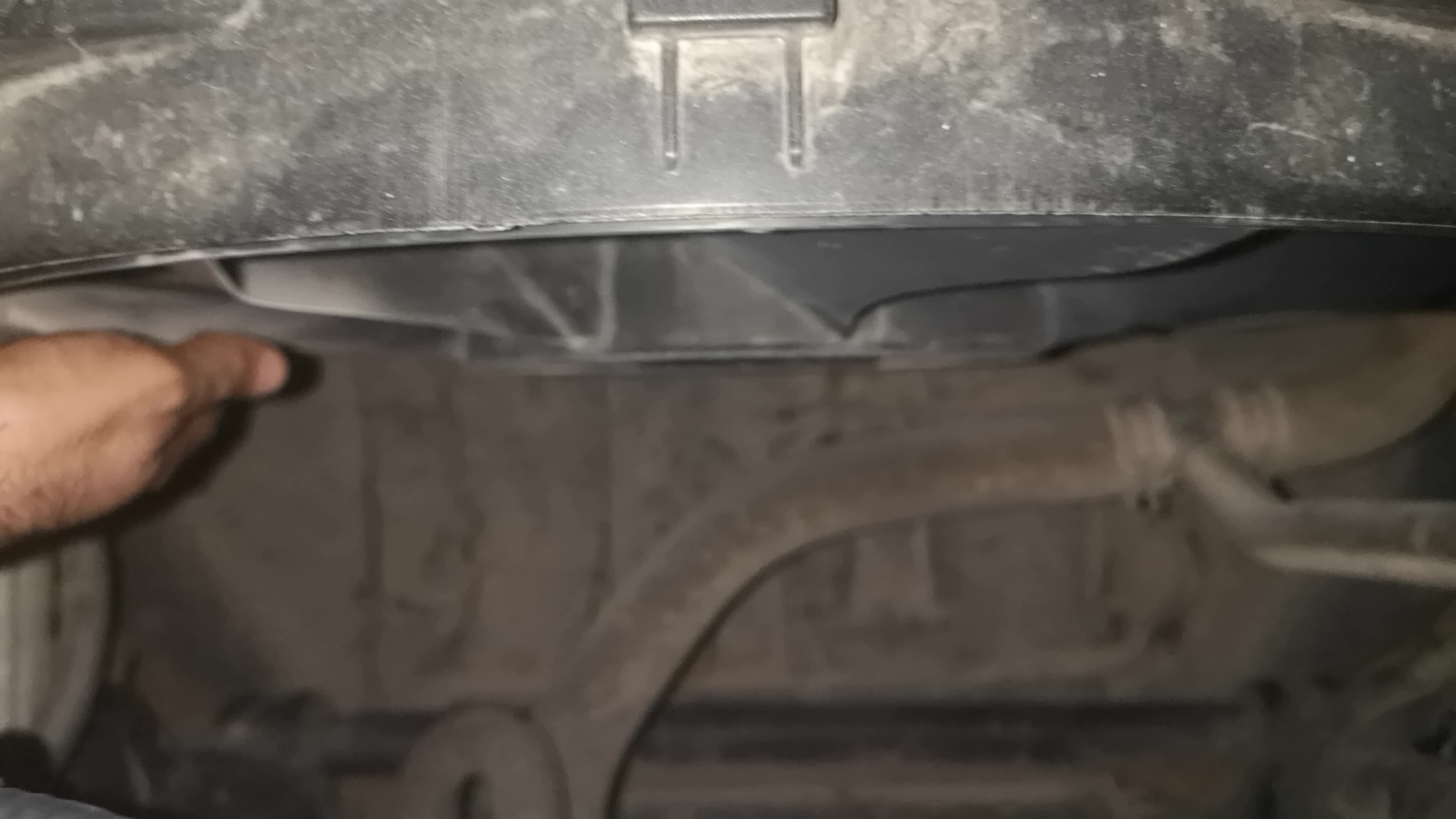

Is there play in the fan blade? In other words, can you wiggle it on its mount? Also, that really doesn't look too out of the ordinary. How low do the engine RPM's get when the A/C is on, and you notice the vibration?
Do me a favor. Start the engine and turn on the A/C until you feel the vibration. Increase the engine RPMs slightly (approximately 1,500 RPMs) and see if the vibration stops.
Let me know what you find.

sir, the vibrations end even at 1,000 RPMs, but related to what you said about if the fan wiggles around its mount, I attached a video sir.
thanks again.
Jul 28, 2024 at 8:22 PM
  • 110,244 POSTS

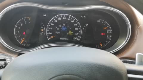

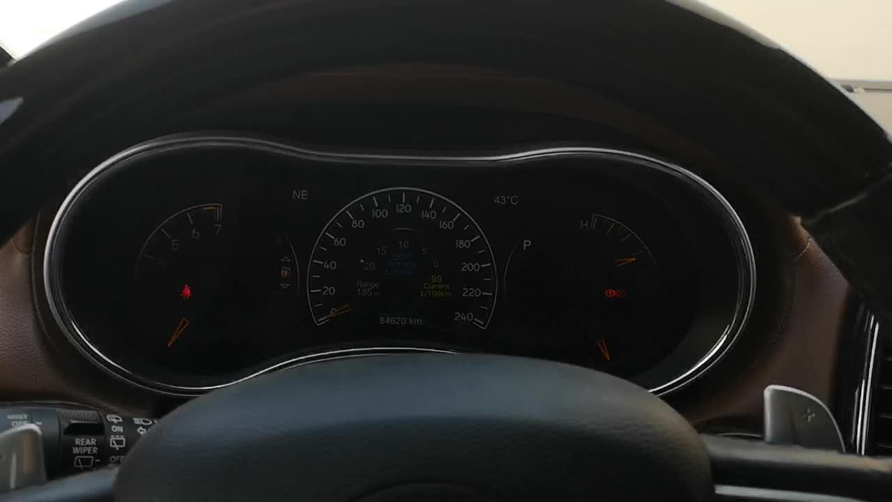

The movement in the fan seems okay and not excessive. When the fan is on and you feel the vibration, how low are the engine RPMs? If the vibration goes away at 1,000 RPMs, that leads me to think the engine idle speed is too low when the load from the A/C compressor is added. If it was the fan itself causing the vibration, it would continue even after 1,000 RPMs.
Jul 29, 2024 at 3:37 AM
HASSANMAHMOOD
  • 24 POSTS
sir, I think it does not increase on ac start!!!
I have a video recorded for that..
Jul 29, 2024 at 8:01 AM

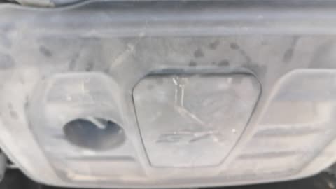

The engine speed appears to be fine. Do me a favor. Check to make sure nothing is loose. Check the mounting bolts on the A/C compressor itself.
Jul 30, 2024 at 4:46 AM
HASSANMAHMOOD
  • 24 POSTS
sir, the bolts are tight already ...I made sure of that ..

I see you spinning the fan which looks okay from this angle, but I have seen a piece of plastic break from the fan blade which will cause it to be off balance. Also, if the A/C system is over charged or has too much compressor oil in it the system will vibrate, let's go over this video to see what the pressures should be:
