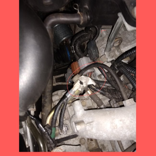

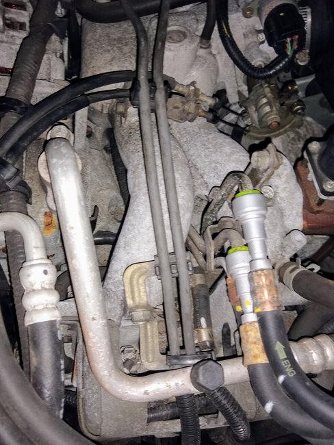

I do not have a "Test Port" on Fuel Line.
I understand I need to "Tee In" to Fuel Line, but I do not know where to put Tee.
Here are images of left and right fuel rail where do I Tee in for Pressure Test? Pressure Regulator is circled in Red.

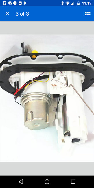

Fuel Pump Assembly.

You are correct about the T. There should be a quick connect between the fuel rail and the full supply line. That is where I normally do it. I disconnect the two and install the T at that point.

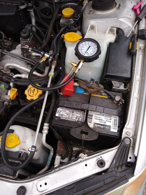

I removed fuel filter and retested.
0 PSI
Will get new pump and filter and strainer and retest.
Here is image of pressure test setup.

It looks correct. If nothing is plugged, the pump is running, you have everything connected correctly, and you have no pressure, the pump must be bad.
Let me know the results with a new pump.
