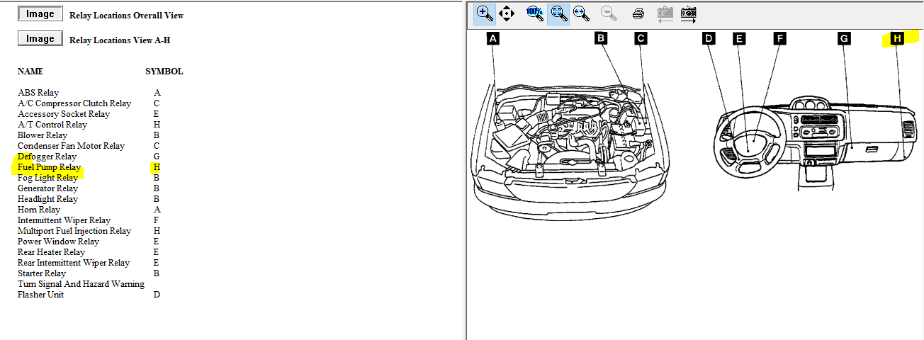

it seems you have fuel supply problem. lets start by check the fault codes:

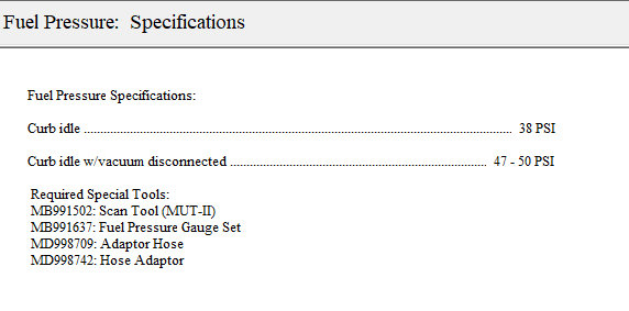

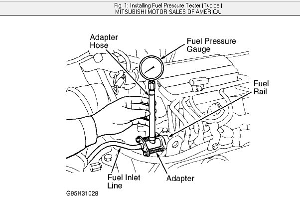

You can install fuel pressure gauge and check the pressure when starting the engine check fig1 and fig2.
use our guide for checking fuel pump:

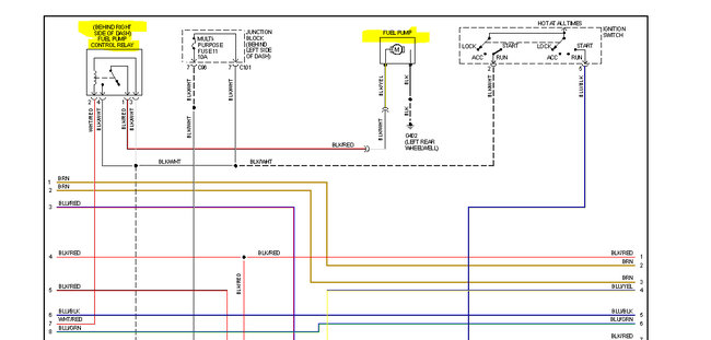

If you have no fuel pressure check the fuel pump relay. check fig3 jump relay connector 1 and 4 ignition on fuel pump must be activated.if the engine starts then you might have relay problem or signal problem from control unit that prevents to activate fuel pump relay.
