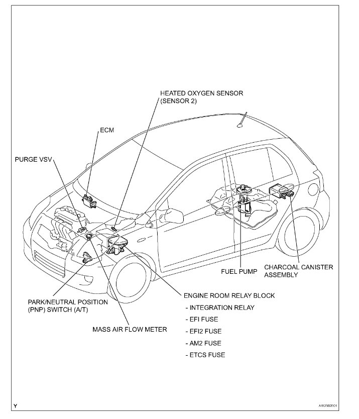

I don’t know what’s wrong with my car, sometimes if i park it and turn off the car it won’t start immediately until I wait for like 20-30 minutes.
Sometimes as you are driving it will just turn itself off, you have to wait for another 20-30 minutes before it starts.
I replaced the crankshaft sensor and another sensor I forgot the other sensor name but is like is beside the car battery and the had to remove water pipe before they pull it out but it’s still giving me same problem.
What can I do please?

Do you have a check engine light on? If so, we need to scan for codes, this guide can help:

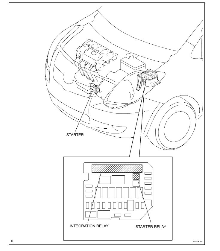

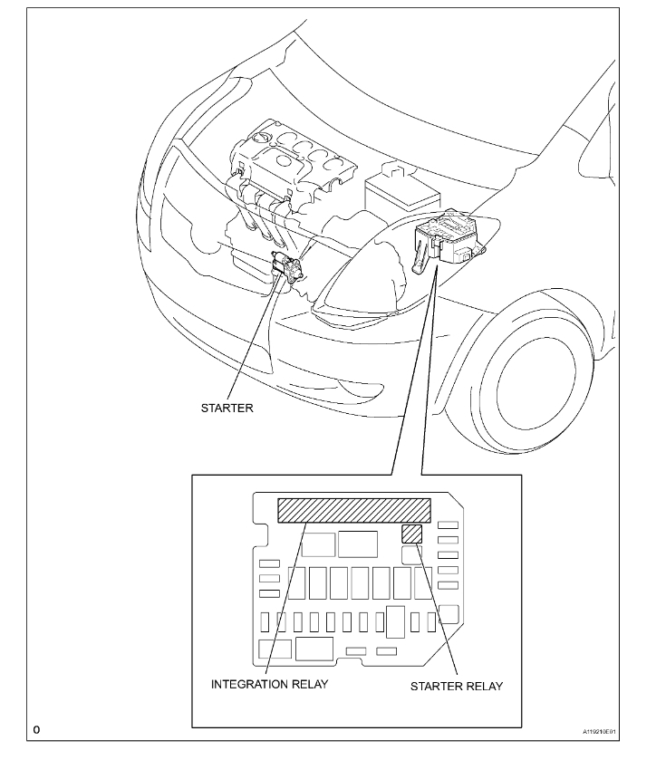

If no codes come up it sounds like you have a fuel pump or integration relay that is going out. When the engine won't start can you hear the fuel pump running in the tank for about 5 seconds?
Here is a guide that can help us fix it:
https://www.2carpros.com/articles/car-not-running-advanced
Also tap on the integration relay to see if the engine starts, here is the location in the diagrams below. Check out the diagrams (below). Let us know what happens and please upload pictures or videos of the problem.
