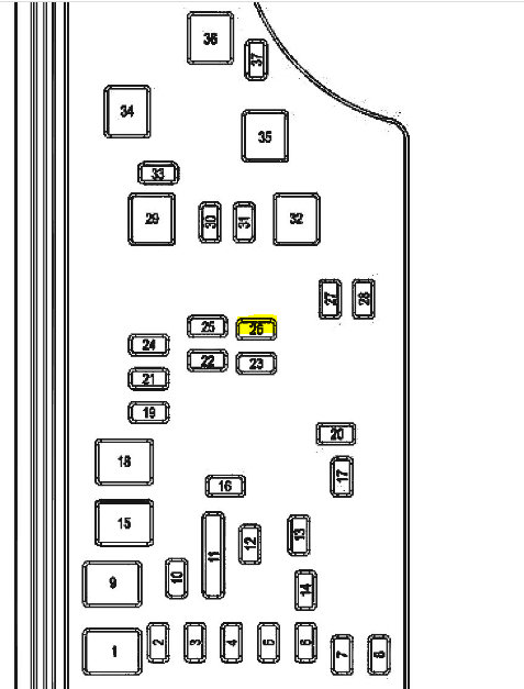

i rebuild the engine and it was running for 7 days. Now it doesn't want to start. i replaced the intake runner sensor, (2) camshaft sensors. The TPS light blinking and won't start. I checked all fuses, and they are okay. It has no spark and no injectors power. Is the crankshaft sensor related to spar or the injectors?
Sep 27, 2022 at 3:56 AM
  • 110,248 POSTS
Have you checked all connections at the PCM? Have you checked the auto shutdown relay and fuses? Is the starter turning the engine or not responding?
Let's start by checking fuse 26 in the under-hood fuse box and the ASD relay. In addition to checking the fuse, confirm there is power to it.
Here are two links you may find helpful when checking:
I attached a pic below of the fuse box and highlighted the fuse to check.
Let me know what you find.
See pic below.

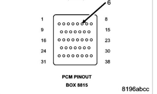

Hi Joe, everything was going well, fix the engine intake runners, and now po700 and po755 are on. The transmission is not shifting at all. i changed the filter and transmission fluid, from this point i need help. i do not feel like pulling the transmission out and spending more money for new transmission. Help!

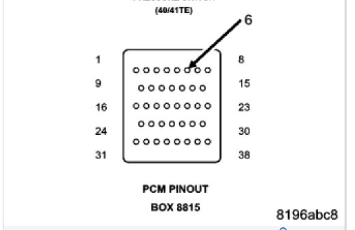

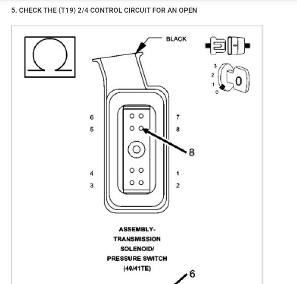

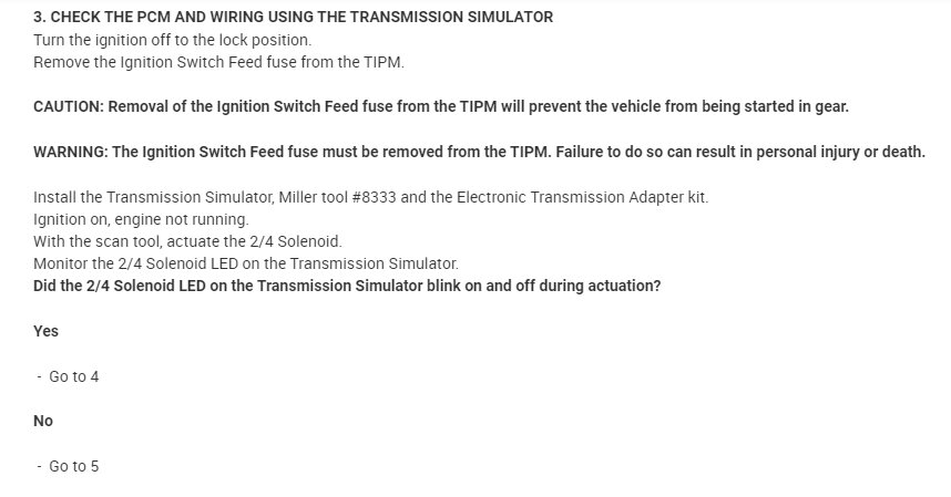

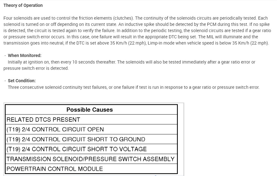

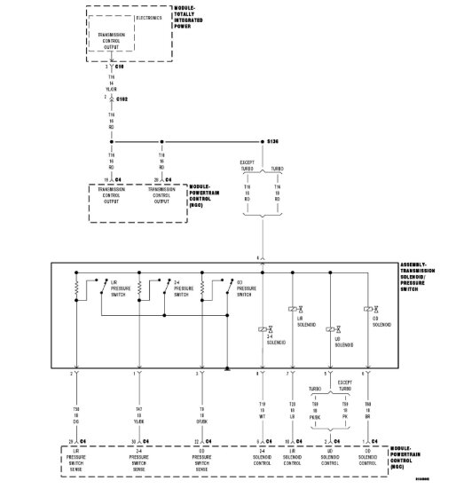

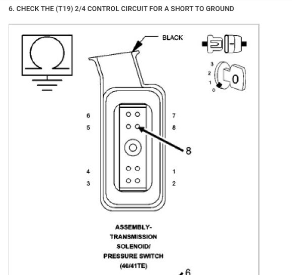

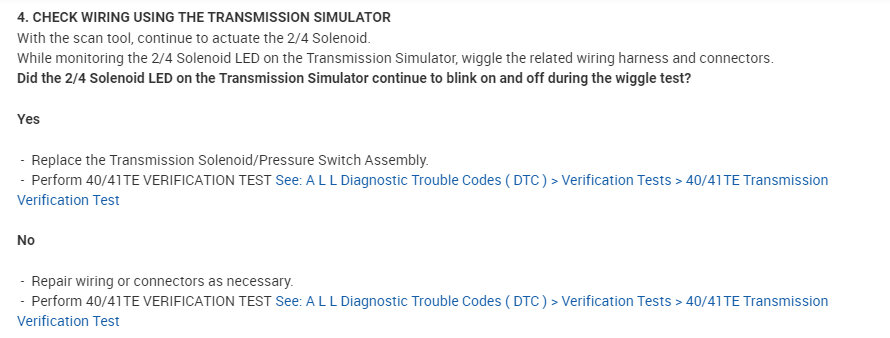

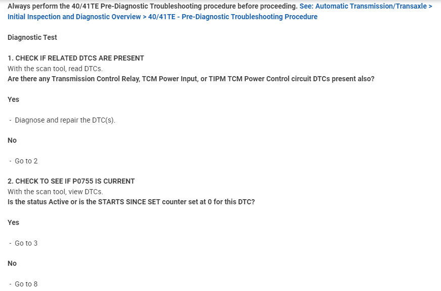

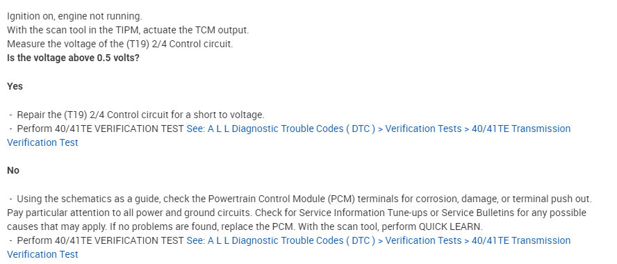

Hi Joe, the codes po700 and po755 steal coming on even after replace solenoid pack with Mopar OEM it is in limb mode and stock in second gear, i tried to scan the gears and reset is show cool transmission all the time and won't let me calibrate the gears only gear shift will calibrate. i hope is not PCM. thanks
Oct 14, 2022 at 9:14 AM

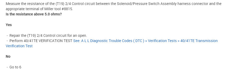

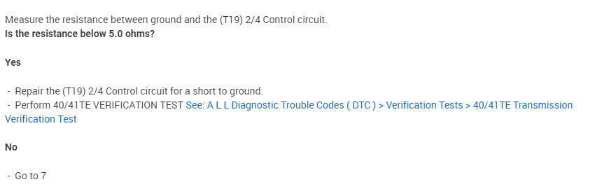

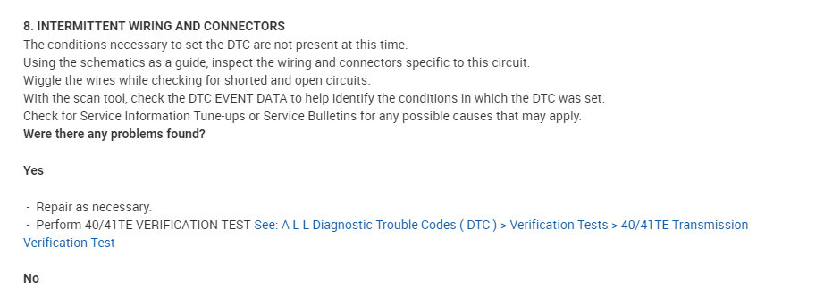

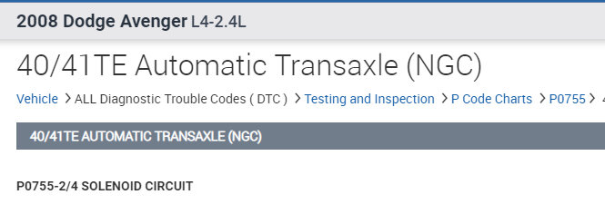

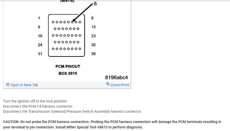

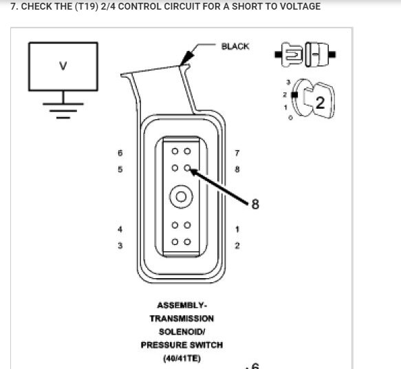

  • 110,248 POSTS
I attached the diagnostics specific to the P0755. Take a look through them and let me know if they help.
Take care.
Oct 14, 2022 at 3:24 PM
KRZYSZTOF
  • 32 POSTS
HI THIS info is not apply to dodge avenger mi car have different wires colors there is no black ,the one on picture is yellow,blue strips. i found faulty speed sensor,(replace)and check all the wires nothing is brook ,mine next guess is pcm on trans side,thanks
