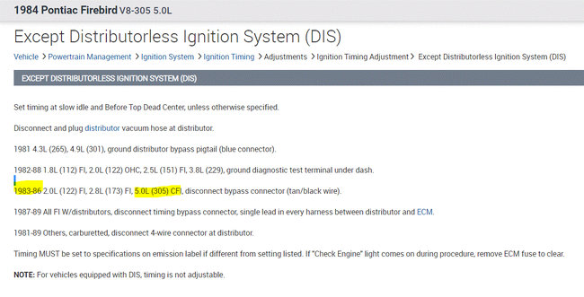

smog tech disconnected the 4 wire connector to my distributor and said he had to to test the timing and ran my engine "My shop manual says "not" to disconnect the 4 wire connector and to disconnect the single wire connector that comes out the wiring harness. Well since the smog tech did that my car doesn't drive pass 45 mph now. Why?
Dec 2, 2020 at 11:32 AM
  • 110,248 POSTS
If it is a fuel-injected vehicle, only one wire is disconnected. If it is carburated, then a 4 pin connector gets disconnected. See attached pic 1

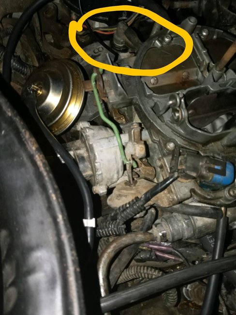

I'll take a video of the car and how it runs after I install the new secondary air injection pump
This picture that I'm sending you with the yellow circle circling around that ported valve towards the back of the firewall into the manifold I don't know what it connects to. do you know by any chance?
Dec 9, 2020 at 8:22 PM
  • 110,248 POSTS

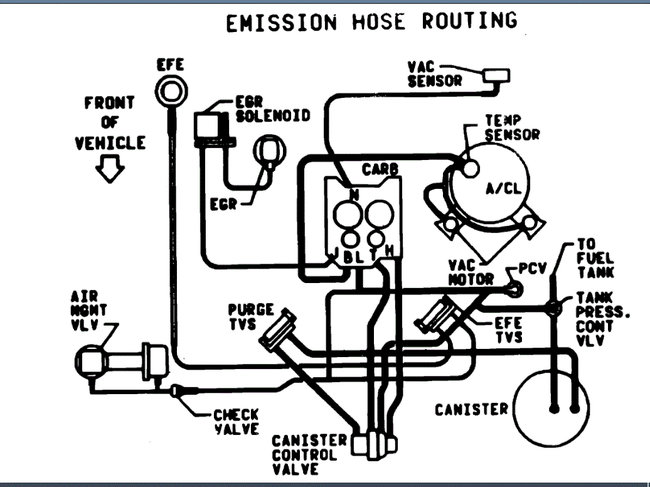

It's been a while. LOL I see the hoses. Can you follow them? There was a thermal vacuum control valve that ran to the intake and was designed to prevent the EGR from opening when the engine was cold (below 60°F if I recall). It would block vacuum to the EGR until the temperature was reached.
See if you can follow it to any point. If you look at the attached pic, it shows the EVAP system vacuum schematic. See if that helps.
