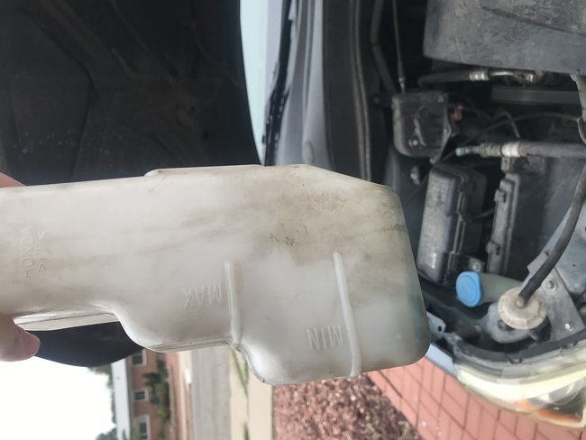

My car has been throwing smoke for the last two weeks when I let my car sit on park with the engine running for more than 10-15 minutes, and when I put it on drive and leave. if it’s less I don’t see it throw smoke once I start driving. I noticed this the day before I got an oil change and even after oil change it still throws smoke when I drive it after engine was running and sitting in parked. Please help. any ideas what it can be? Can I still run my car or am I at risk of it breaking down? The meters on the dash board are all good. Also my check engine light was on for a while and my key would not work with my ignition because it was bad. I didn’t know this and took it to a mechanic and he checked out the car and I don’t know what he was doing but there was a loud boom that sounded like something fell. but he was able to help me get my car started from the inside of the hood so I can drive it to a key dealership. My check engine light never came back on since. Don’t know if I should throw that scenario in there.

MELISSA MORELAND
Thank you for telling me to check the coolant! I checked it and it’s almost empty! It has very little coolant. So can the smoke be the coolant leaking? Also when you mention about smell a while before I did notice a strange smell but I wouldn’t necessarily say it was sweet... it smelled really strong and horrible almost like a dead body but I don’t know how that would smell either so I’m not too sure, lol. But I did notice a bad smell very strong for a few days random times for about a month or so and never have since. This was probably back in July or August. Should I just keep adding coolant for the meanwhile?
Nov 8, 2019 at 4:27 AM
SCGRANTURISMO
  • 4,897 POSTS
Hello again,
LOL. Yes, you should keep it filled up coolant as you don't want your vehicle to overheat and cause a whole new set of problems. So, a blown head gasket is probably going to be the culprit here. Here is a link explaining in a little more detail what is going on:
https://www.2carpros.com/articles/white-smoke-or-steam-coming-from-the-exhaust-pipe
Please go through this guide and report back here. We can go from there to get this remedied, but whatever you decide to do, make sure to keep an eye on the coolant and keep it filled.
