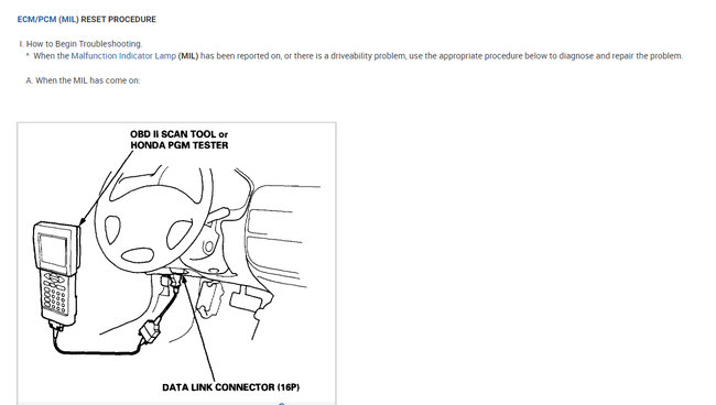

Also, if the check engine light is on, have the computer scanned for diagnostic trouble codes. Here is a quick video showing how that is done:
https://youtu.be/b2IJGfImVvw
____________________________
I realize most people don't own a scan tool, but oftentimes a parts store will do it free of charge.

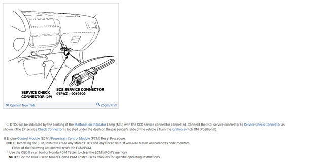

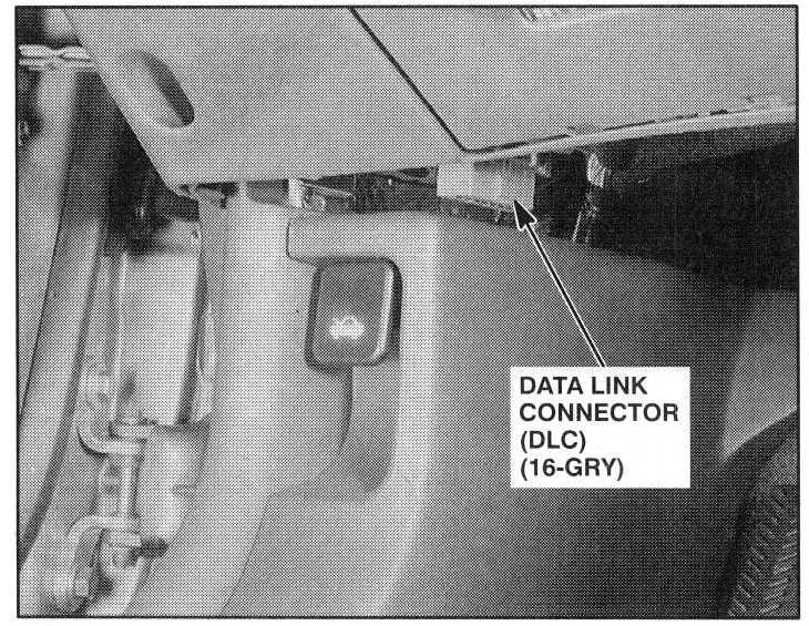

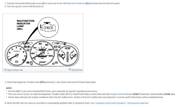

Did you check for the data link connector? I attached a pic below showing the location.
Check to see if it there and if there are wires attached to the rear of it.

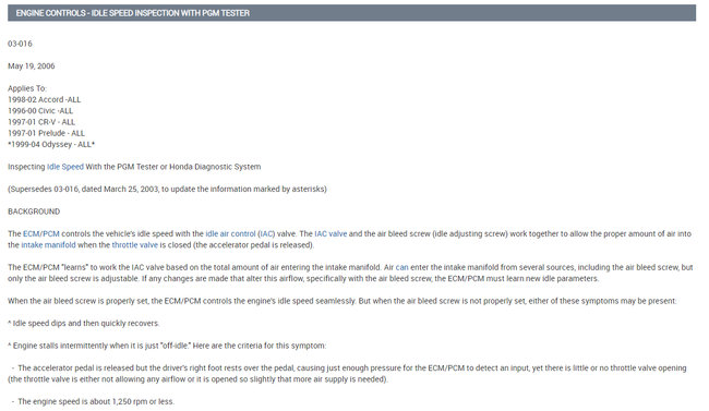

Also, when you replaced the IAC, did you check to make sure there wasn't excessive dirt or carbon in the throttle body? Here is a link that shows how to service one:
https://www.2carpros.com/articles/idle-air-control-valve-service

This sounds like you have multiple issues, every issue has to have a new topic started. Your connector is there you just have to look for it.i suggest reinstalling original idle motor(when at idle and park and still have issues with idle ) you have to scan vehicle (try another parts store) also when installing a idle speed motor you have to clean the intake side of the idle motor.
(carbon build up).

Yes, it fluctuates and revs high a little bit sometimes, it does it everytime in reverse heavy surge, but the auto parts store said they can't hook a scanner up because my obd2 thingy majig isn't hooked up.
Feb 28, 2021 at 2:27 PM
NICKOLAOSF
  • 69 POSTS
I would go to another parts store, it is possible then connector has been push up and it is behind, and just can see it, you have to look for it.
