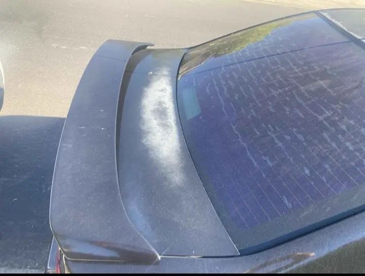

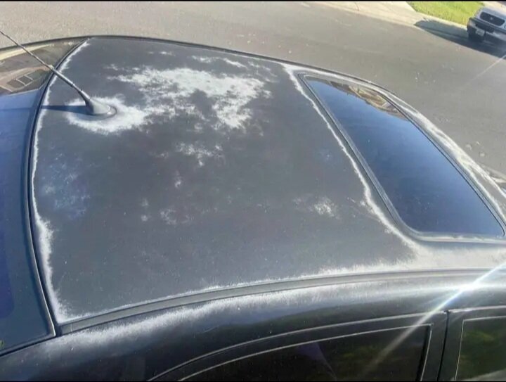

How bad is this car's sun damage?
Jul 9, 2024 at 12:28 AM
  • 110,248 POSTS
The clear coat has come off the base coat (color). This would require the clear coat to be removed, and the vehicle repainted.
Let me know if that helps.
Jul 9, 2024 at 11:39 AM
AARONN
  • 125 POSTS
How much you think it would cost?
Jul 9, 2024 at 11:08 PM
  • 110,248 POSTS
I'm not sure where you are located, but chances are it will need fully repainted' otherwise, the paint may not match. I'm in PA and would expect it to be approximately $2,000 if there was no body work that needed to be done.
Jul 10, 2024 at 11:49 AM
AARONN
  • 125 POSTS
I am in California.
Jul 11, 2024 at 3:09 AM
  • 110,248 POSTS
I wouldn't know what to tell you there. I know the shop rates here are just under $100 an hour.
