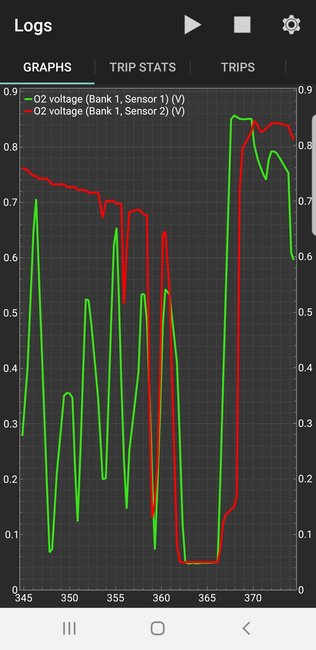

my car, during reverse it stumbles, and when taking off from a stop it's jerky. so to compensate for the problem to not happen, I have to hit pedal hard, the car never shut off on me, no check engine light, new ACdelco fuel pump, new spark plugs, and coil pack, new exhaust manifold gasket, new valve cover gasket. by the way this car model does not have a fuel filter, it's built in the pump. new throttle body, why because TPS sensor is connected to it, 2 new fuel injectors, I have a obd to look at my injectors it looks right, new down stream o2 however I think this may be the problem .I'm not that advance to no how to read trims to spot something. forgot to mention static fuel rail pressure was checked and it's holding no more then 3 psi loss in a minute. the picture of both o2 sensor while driving 45 mph. Also I have the ability to do a video of the reading live.

Hello, have you checked the EGR valve for proper operation? The EGR is not used at idle only higher rpm's, make sure it's closing all the way and not hanging open at lower rpm's. Also what are the fuel trim numbers at idle and 2,500 rpm? There's not much data to go by here, just what you're telling us. Those 02's look active, but there is that lean drop out there (lower voltage reading). So fuel trim numbers and 02 readings at idle and 2,500 rpm's to start with. A video of the live data would help much.

Okay, so I've watched the videos a couple of times and it's very hard to see the screen, but I see a couple of things right away. That fuel trim at idle, long term trim was at -12.5%. this means the ECM is taking away 12.5% of fuel at idle, that's too much. And the short term fuel trim of 99.2% is off as well. First thing I would try is cleaning the mass air flow sensor. But be very careful with it, they're fragile. Buy some mass air flow cleaner and a little brush. Make sure there's no carbon build up on the resistors. Another thing I see is that bank 1 sensor 2 02 sensor, it's pegged out full rich at 0.7 volts. This is the 02 sensor after the catalytic converter, it shouldn't be that rich. A back pressure test at the front 02 sensor (removed) should be 0-2psi at idle, any more than that and the catalytic converter is no good. But just remember I'm only going by what data I can see. But start with cleaning the mass air flow, give it a good look. The carbon build up is kind of hard to see.

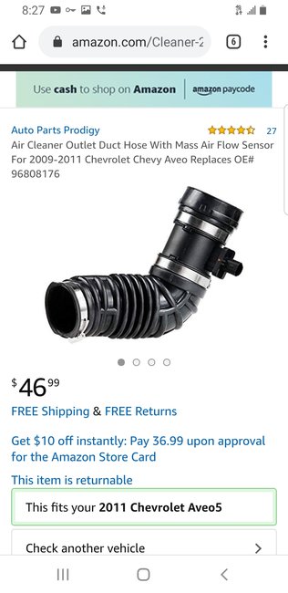

Also, I need to mention the downstream o2 sensor was replaced a year ago it was a ACdelco it was about $100.00 got it from amazon box was damage but part was sealed that why they sold it so cheap. p.s the mass air flow sensor I bought is in the pic I'm posting now, it's a aftermarket not a Bosch which was on before replacing could this be the problem?

Okay, I would have a good look at that intake air tube, Make sure there is no cracks or holes in it. That down stream 02 should be steady 0.5 volts or less, it's reading rich which might explain the negative fuel trim numbers. As for the mass air flow, it looks correct according to volumetric efficiency Chart but could still be an issue, I think you can unplug it and the car should run on a default strategy and see if that rear 02 comes down. Also make sure fuel pressure is 55-60 psi at idle and of course check for vacuum leaks (smoke test the intake if necessary). One last thing is how do the spark plugs look? If it's running rich they will have black carbon build up. I am concerned about the catalytic converter also, a back pressure test at idle should be no more than 0-1.5 psi. That rich reading post catalytic converter is a worry but cats are expensive so back pressure test first.
