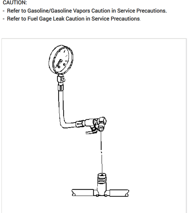

This sounds like the fuel pump is going out when it heats up, lets check the fuel pressure which you can do by following this guide and using the instructions in the images below.
Fuel Pressure (Key ON, Engine OFF) .................... 384-425 kPa (56-62 psi)
You can rent a fuel pressure gauge set at the auto parts store for free. Check out the images (below). Please let us know what happens.

It gets around 57 to 58 psi and then it starts going down
Aug 30, 2025 at 8:23 PM
  • 55,427 POSTS
Does it go down when the engine is running or just after the fuel pump stops? If it goes down after the pump stops it seems like it is okay. I have seen the coil pack short out on these cars FYI, there is no codes for this problem. Have you replaced the spark plug wires? Also, I would replace all of the spark plugs as well.

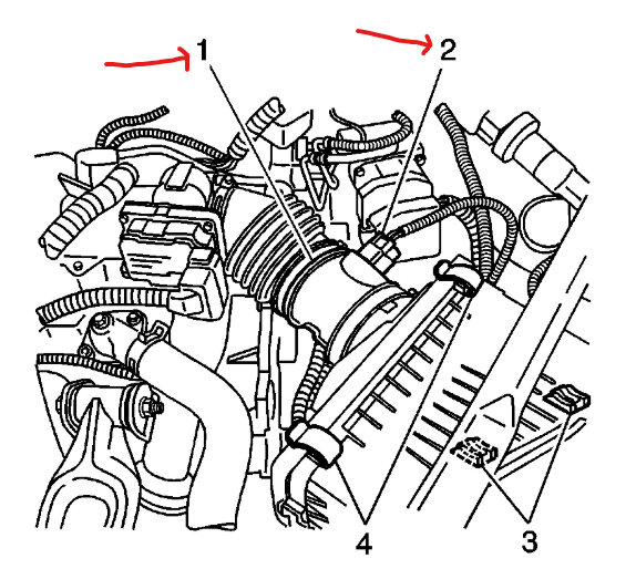

One popular problem with low power issues is a bad MAF sensor, also I would double check the catalytic converter. This guide can help, also go over the engine lower power guides as well.
and
https://www.2carpros.com/articles/engine-has-low-power-output
Here is the location of the MAF sensor, if the sensor is weak cleaning it will not help, it must be replaced. Check out the images (below). Let us know how it goes

I think it's the maf sensor. I unplugged it after doing some research and drove to work didn't have any issues going uphill where I usually do. Only thing is it gave me the p0300 code again when accelerating up to highway speeds but that was it
Sep 3, 2025 at 6:56 AM
  • 55,427 POSTS
Yep, the bad MAF sensor will cause a P0300 code. Good find, I would order a new one.
