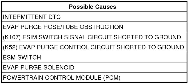

What I think is happening is either the pressure switch is bad or the purge solenoid is bad allowing fuel to enter the EVAP system and causing a hard start when you refuel.

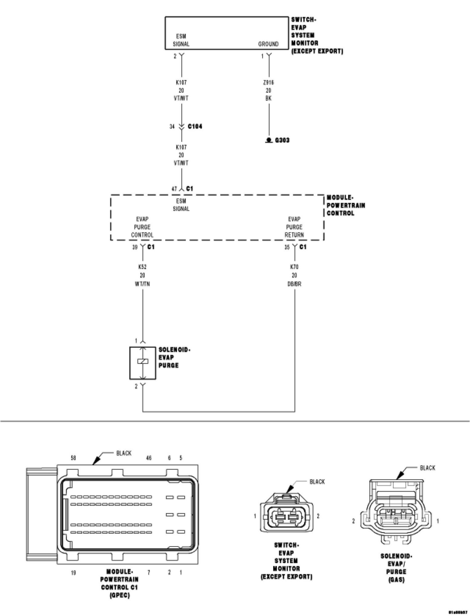

I attached a picture to showing possible causes for the code and a schematic of the system.
Now, I have to say, most likely the purge solenoid is bad. However, here are the diagnostic checks. It will require a live data scanner.

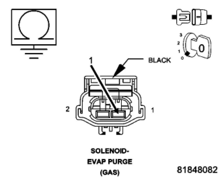

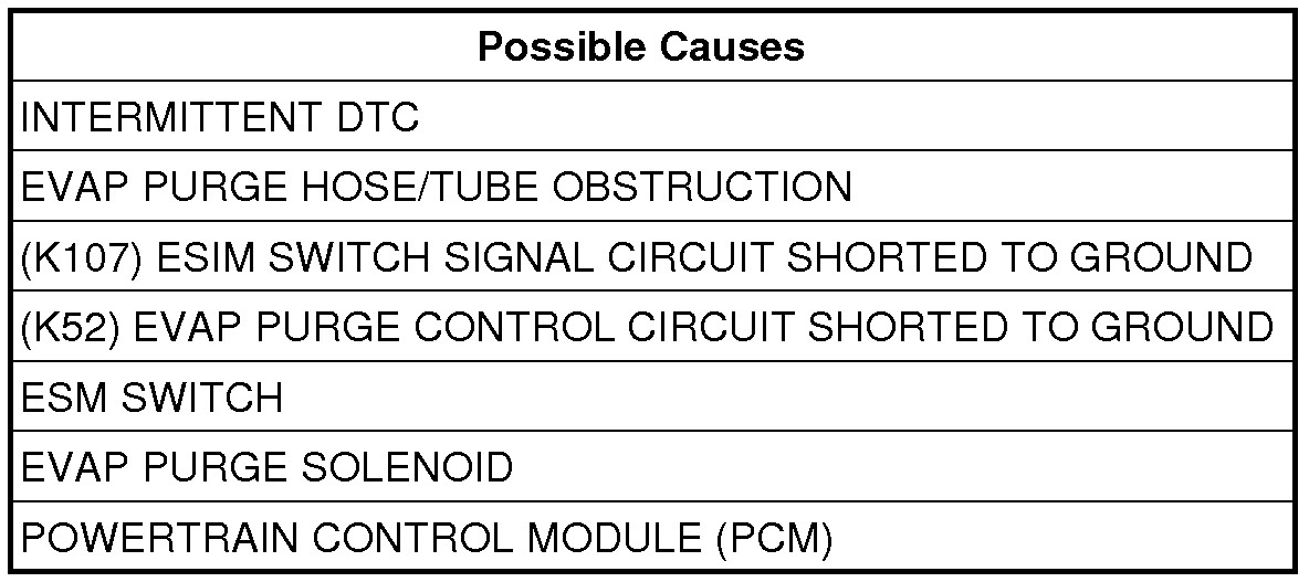

Here are the directions. They are somewhat involved. See pictures 3 and 4
For a complete wiring diagram Consult Diagrams/Electrical.

6. EVAP PURGE SOLENOID
Using the wiring diagram/schematic as a guide, inspect the wiring and connectors between the Evap Purge Solenoid and the Powertrain Control Module (PCM).
Look for any chafed, pierced, pinched, or partially broken wires.
Look for broken, bent, pushed out or corroded terminals.
Search for any Technical Service Bulletins that may apply.
Were any problems found?
- Repair as necessary.
- Perform the PCM Verification Test Ver. 1See: A L L Diagnostic Trouble Codes ( DTC ) > Verification Tests > Powertrain Verification Test.
- Replace the Evap Purge Solenoid.

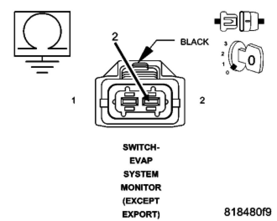

7. ESIM ASSEMBLY
With a scan tool, select Data Display and view the ESIM Switch state.
Disconnect the Evap System Monitor Switch electrical connector.
Does the ESIM Switch state change from CLOSED to OPEN when the switch is disconnected?
- Replace the ESIM Assembly.
- Go to 8

9. POWERTRAIN CONTROL MODULE (PCM)
Using the wiring diagram/schematic as a guide, inspect the wiring and connectors between the Evap Purge Solenoid and the Powertrain Control Module (PCM) and between the Evap System Monitor Switch and the Powertrain Control Module (PCM).
- Replace and program the Powertrain Control Module (PCM).

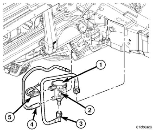

If you determine the purge solenoid is bad, here are the directions for removing and replacing it. The remaining pics correlate with these directions.
________________________________________________________________________________
EVAP PURGE SOLENOID - REMOVAL
REMOVAL
1. Disconnect and isolate negative battery cable at battery.
2. Remove the PCM, See: Engine Control Module > Removal and Replacement > Powertrain Control Module - Removal.
3. Disconnect electrical connector (5) from evaporator purge solenoid (1).
4. Remove purge hose (4) from evaporator purge solenoid (1).
5. Remove quick connect fuel tank hose (3) from evaporator purge solenoid (1).
6. Release tab (2) to remove evaporator purge solenoid (1) from bracket.
__________________
Replacement
1. Install evaporator purge solenoid (1) to bracket. Make sure the tab (2) secures the solenoid (1) to the bracket.
2. Install quick connect fuel tank hose (3) to evaporator purge solenoid (1).
3. Install purge hose (4) to evaporator purge solenoid (1).
4. Connect electrical connector (5) to evaporator purge solenoid (1).
5. Install the PCM, See: Engine Control Module > Removal and Replacement > Powertrain Control Module - Installation.
6. Connect negative battery cable, tighten nut to 5 Nm (45 in. lbs.).
