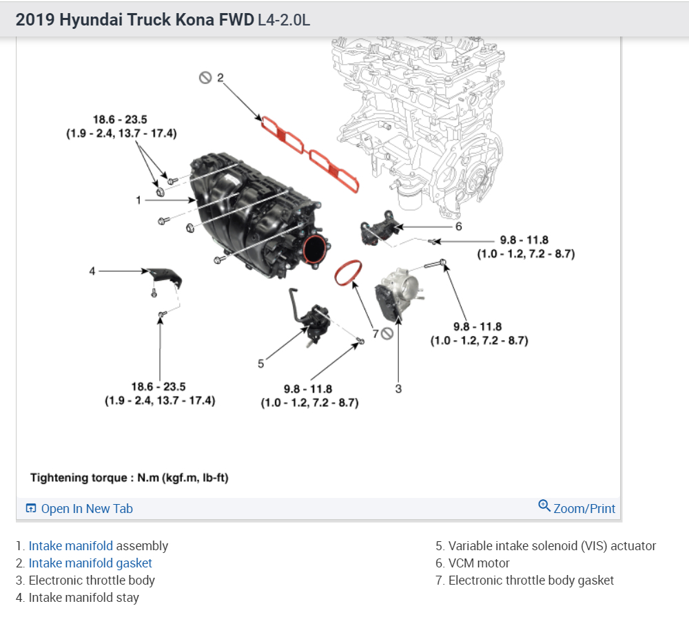

When I drive for a while and get ready to come to a stop it cuts off but starts right back up. no engine light on. What could be the problem?

This can be a dirty throttle body or a vacuum leak.
here are three guides we need to go over to help us fix the problem:
and
And this guide test with the engine cold only:
Check out the images (below). Please let us know how it goes.
