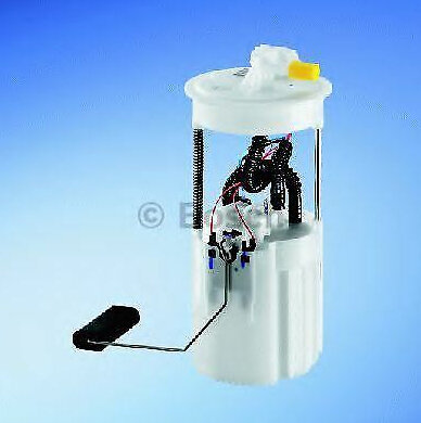

The vehicle has an in-tank fuel pump, see image 1 below.
To check if the engine has no fuel supply simply remove the intake pipe from the air filter housing and spray some starting fluid into the intake pipe. Next try starting the engine, if it fires up, it should fire up and run for a few seconds, then this proves that the fuel supply is not working.
