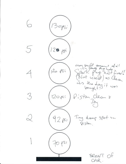

I did the compression test on the cylinders and here is the result of a dry compression test.
You will notice that the front two cylinders are the worst with 70 PSI in cylinder #1 and 92 PSI in cylinder #2.

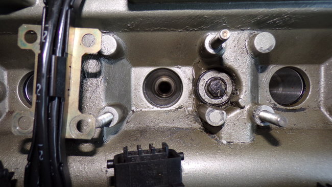

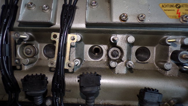

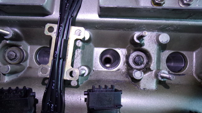

Here are some of the spark plugs starting with cylinder 2 (near front of engine) as somehow I forgot to do spark plug #1.
Jul 23, 2022 at 4:37 PM
CHRISTOPHER SA
  • 255 POSTS

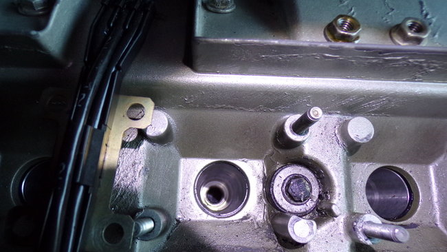

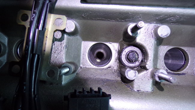

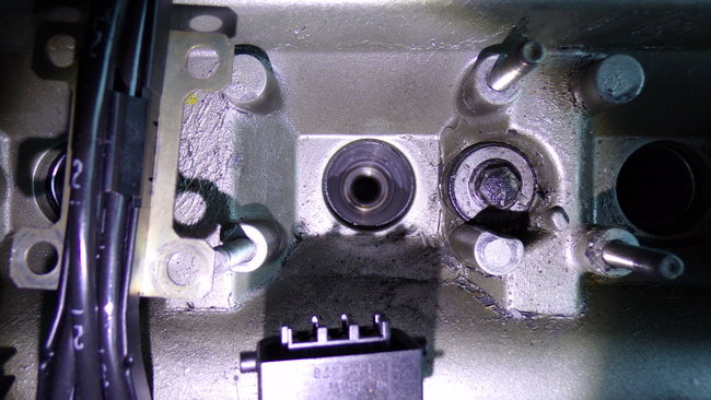

Hole for spark plug from cylinder three as it had some oil in the tower. Very difficult to see though.
Jul 23, 2022 at 4:41 PM
CHRISTOPHER SA
  • 255 POSTS
Cylinder 4 - the spark plug from this was totally clean, and looked brand new in fact. It looked like it had never been used. Very surprising. There is also a short video of the spark plug hole.

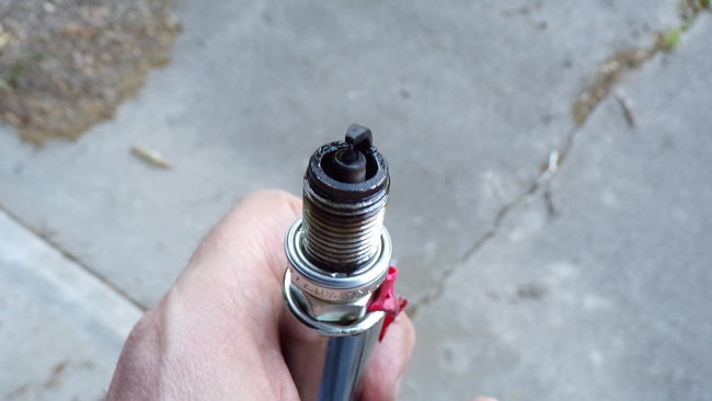

Spark plug #5.

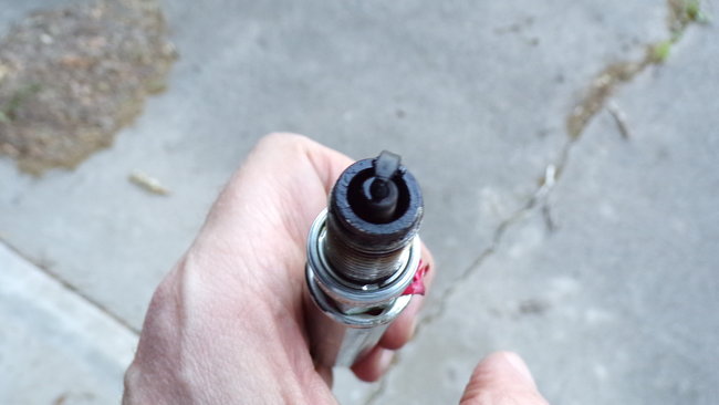

Spark plug #6.

I was then asked by Joe to do a wet test which I did. All the cylinders increased their PSI by a fair bit especially cylinders 1 and 2, which both registered over 150 PSI but dropped from that rapidly to hold for a few seconds around 90 PSI before slowly dropping. The videos show the wet test for cylinder 1 (2 videos) then 2.

When doing these tests, I noticed that the valve cover gasket was protruding a tiny bit into the tower of spark plug holes 1, 2 and 6 and after having cleaned them out the first time when doing the inspections and tests noticed that tower 2 had filled slightly with oil again. The gasket was showing, and one could see it was wet from oil. You can see the gasket showing near the top of some of the holes in this video. That ends the mystery of where the oil comes from. So, I purchased a new valve cover gasket. It is waiting to be put on.

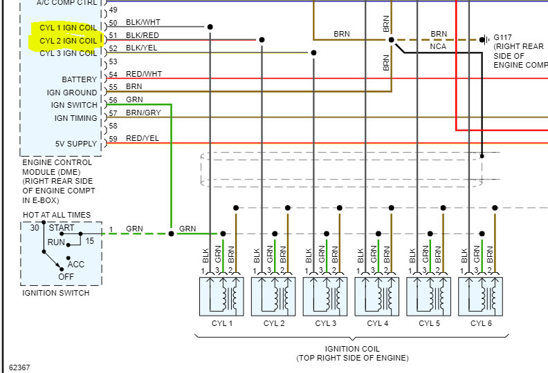

This particular model has three wires going to the plug - green, black and brown.
I'll have to go and purchase a testing light.
Jul 25, 2022 at 9:37 PM
  • 110,194 POSTS
Looking at the schematic for a 325, the black should be the trigger ground. The brown is a ground as well, but not for the purpose of firing the coil.

You are very welcome. I wish I had the exact schematic so I personally felt more confident. But, it appears they are very similar.

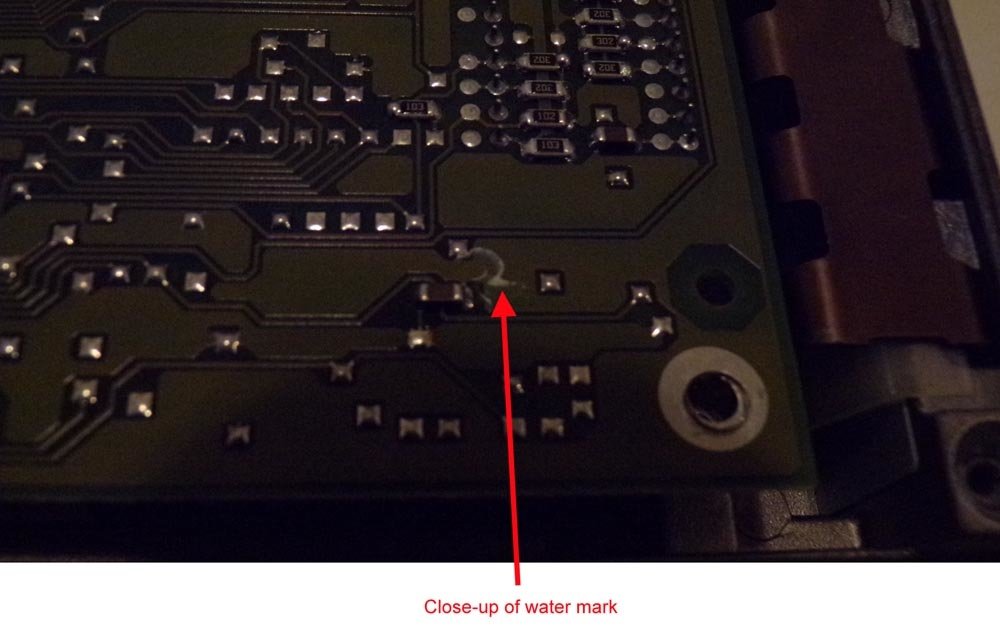

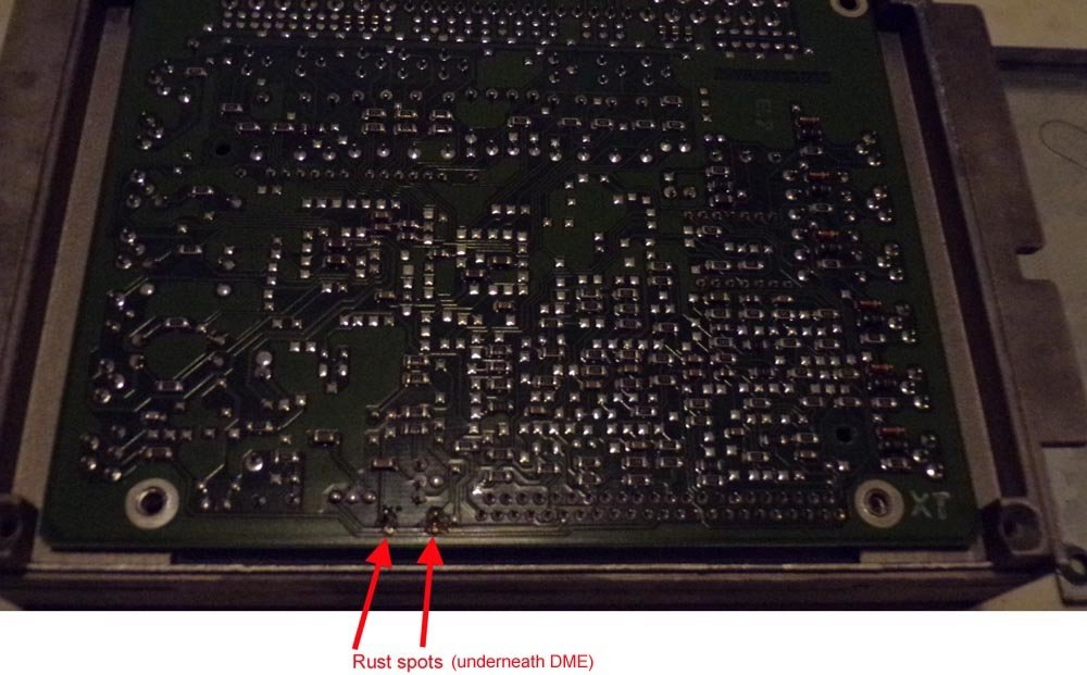

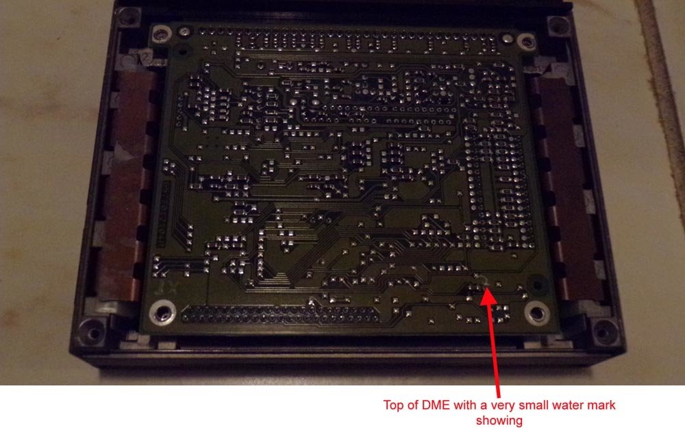

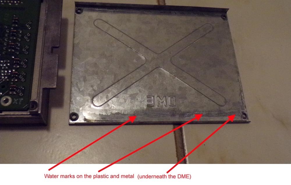

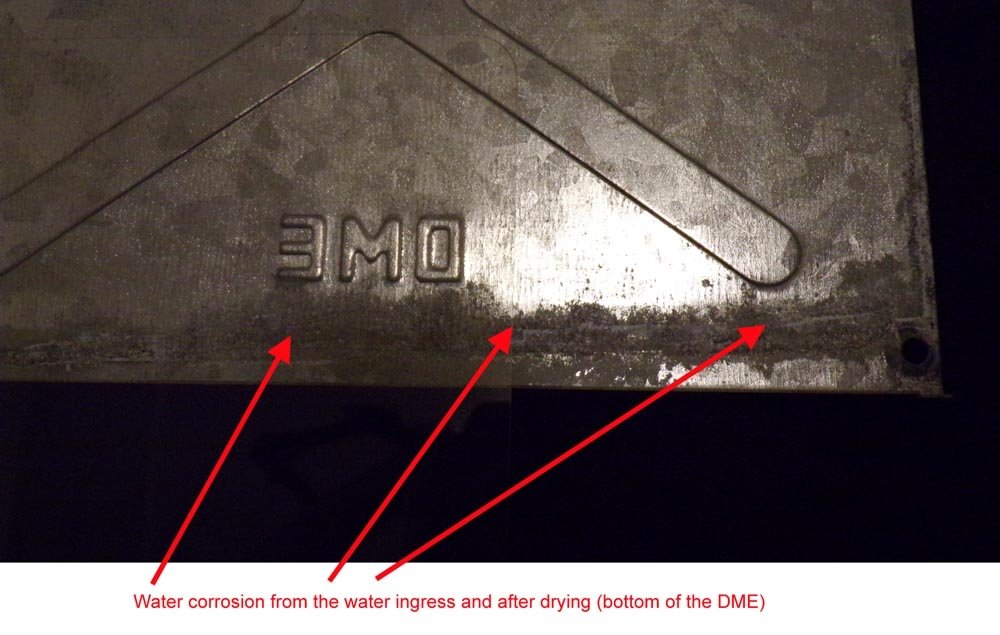

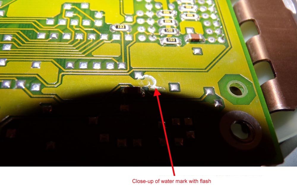

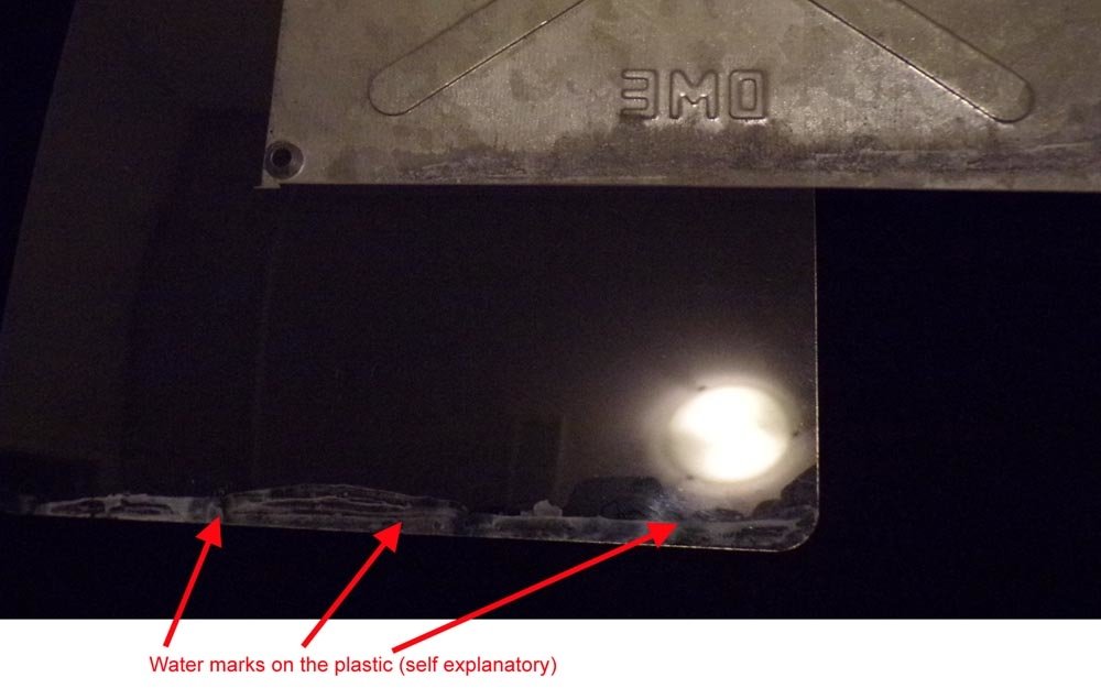

I finally got around to opening up the DME today (Friday, 16th September 2022). Not great news. I have been sold a unit that has had water ingress. I have posted the images of what I found (just before my batteries failed) with text explanations of what one is looking at. Now it's a question of whether I send it off to get repaired or get another refurbished unit entirely (very expensive!). Considering that my original unit quit working of the same causes I am surprised that it worked at all.
As a side note I am always puzzled why manufacturers assume that water will not get into one of these units and don't encapsulate them in resin. It would save customers lots of money.
Sep 16, 2022 at 3:57 PM
  • 110,194 POSTS
Wow. That will do it. Have you tried finding someone online that has refurbished ones that are plug and play?
