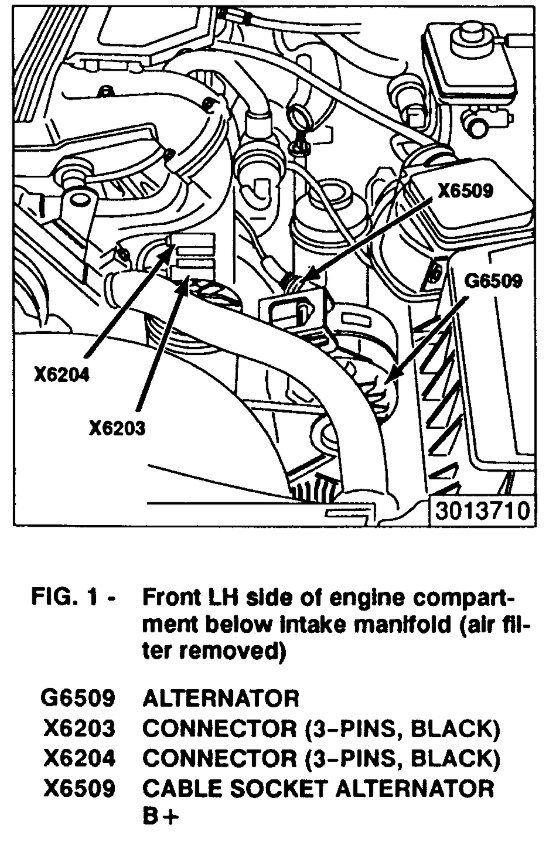

Nice work, here is the correct way to install the alternator. Check out the images (below). Let us know if you need anything else.

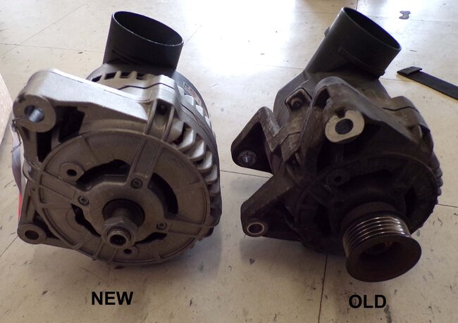

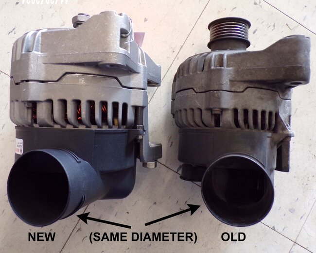

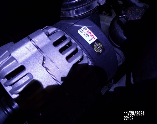

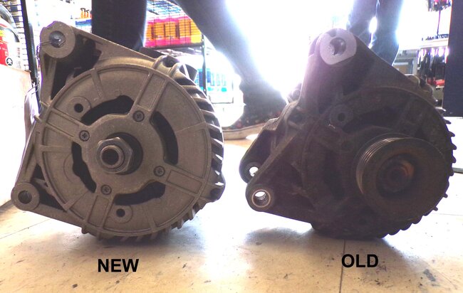

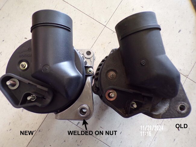

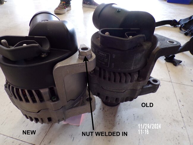

Just to finish up I have installed the new alternator, and everything works as it should/ The increase in alternator power has not caused any issues with the wiring. Here are a bunch of pics to show the difference between the 80A and the 140A:

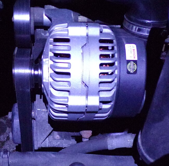

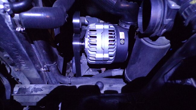

There are some images of the alternator in situ..
Dec 1, 2024 at 12:47 AM
CHRISTOPHER SA
  • 255 POSTS
two of three
Dec 1, 2024 at 12:48 AM
CHRISTOPHER SA
  • 255 POSTS
3 of 3

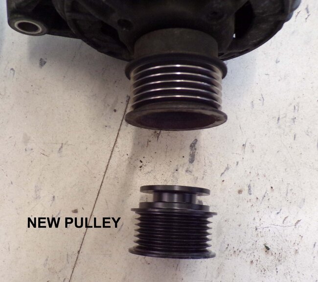

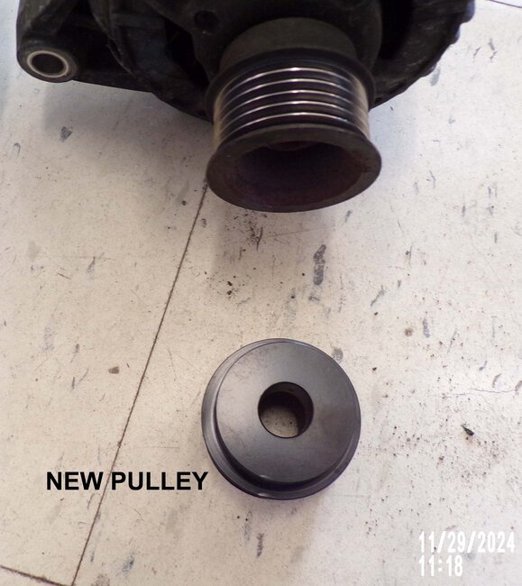

The old pulley can't be used with the new alternator and here is the new pulley.
Dec 1, 2024 at 12:50 AM
CHRISTOPHER SA
  • 255 POSTS
Even though the new alternator is larger than than the old one it just slots into place without any adjustments to anything.

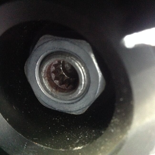

A note about tightening the nut. The nut is 24mm and the hole in the axle of the alternator needs a 12 spline T50 torx (or an M10)/star bit.
I used a shallow 1/2 inch 24mm socket, wrapped the socket end in electrical tape about ten times, gripped it with mole grips then put the T50 torx bit through the socket hole into the axle splined hole and turned this bit anti clockwise with a 10mm spanner to tighten the nut to the axle to hold the pulley firmly in place.

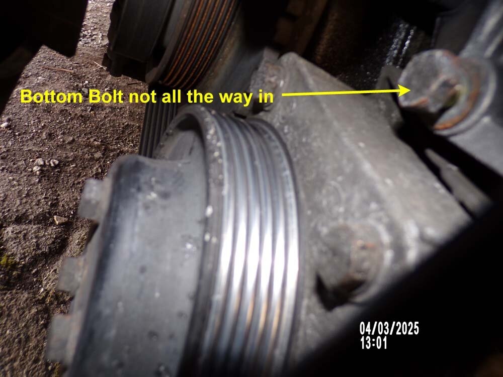

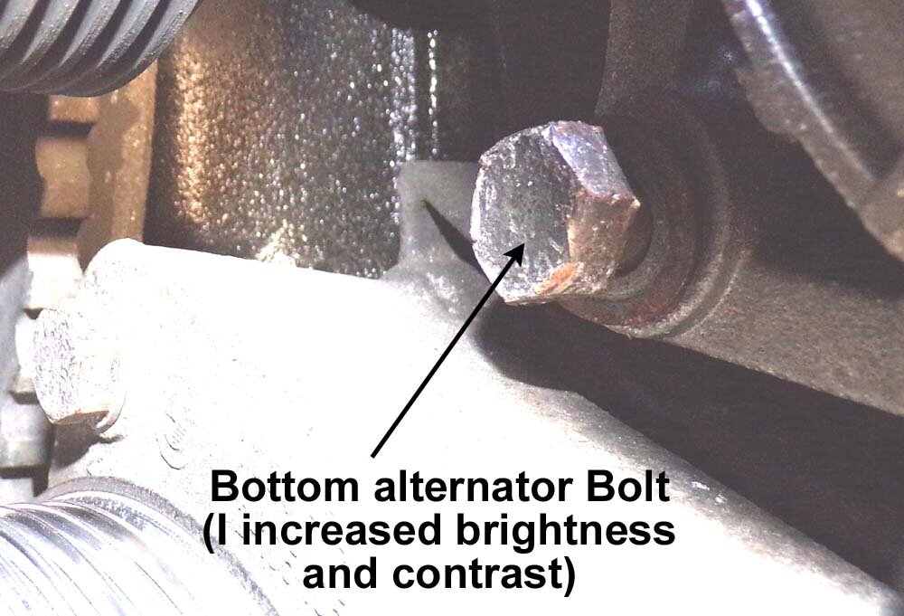

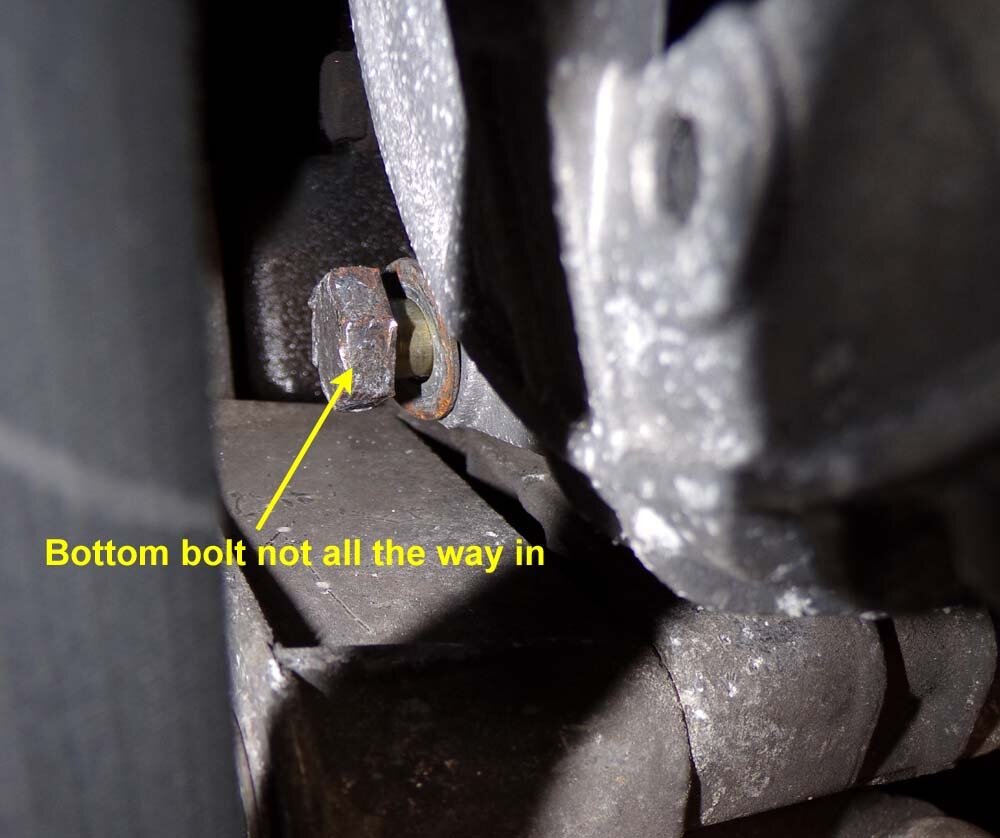

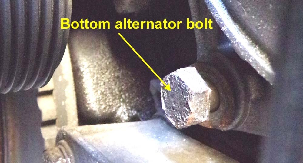

There is just one item that is puzzling me.
The bolt that attaches the bottom of the alternator to the block is sticking out by about 0.75 inches - which means that I was not able to tighten it so that it was flush against the metal of the alternator. I found that mighty puzzling as these bolts are really long and the top and bottom bolt are different lengths with the bottom one being the longest. I had also placed the bolts in different places so that I wouldn't get them mixed up. From the pictures the alternators seem to have the same dimensions so I am left with a very weird result and not sure if its okay to leave a bolt sticking out so much. At the back of the alternator the bottom bolt comes through by about 0.75 inches beyond the nut attached to the back of the alternator bracket, so its really confusing me how this has happened. With the old alternator the bolt would protrude beyond the nut by about a 1/16 of an inch!!!
There is now a slight screeching coming from the belt (which is only a couple of thousand miles old or so) but goes away after the engine warms up, and am wondering if that has anything to do with the bottom of the alternator not being tight to the engine block (since the bolt is sticking out the 0.75 inches)..

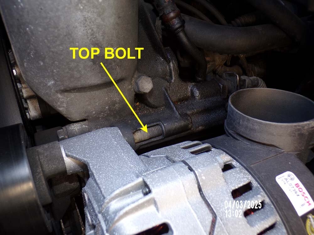

Here are some pictures showing what is going on. After these pictures were taken, I was only able to tighten the bolt so that it went half the distance that is showing it being proud of the alternator. I was worried about breaking the bolt, even though I was still able to turn the bolt, albeit with more force than normal. I have also shown the top bolt to show you that it was correct in size.
I was not able to get a picture of the back of the alternator as there was not enough room to get the camera down there. I was able to feel the protrusion of the bolt and it was about 0.5-0.75 inches coming out beyond the nut on the back of the alternator for this bolt which is a lot more than before. Very puzzling.

You are correct, the bottom bolt is not in all the way, if you won't tighten up you may have it cross threaded, or the bolt is too long. I would remove the alternator for inspection. Thanks for the images and upload more once the job is apart.
