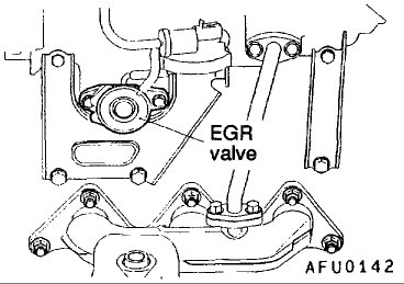

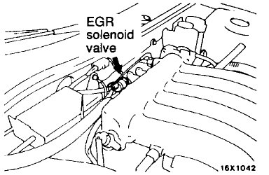

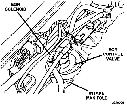

I read on your website from another person with the same car and someone suggested a bad EGR valve. Could that possibly be the problem. I have been having this problem for a while and really need to see what is going on as my wife is getting scared to drive the car thinking it is going to leave her stranded. It will start right back up but sometimes at idle it will just stall when you are stopped and sometimes while driving it will surge or buck from time to time. If you feel cleaning the throttle plate will do it I will do it again.

As for the EGR valve, There are a couple parts. The EGR control solenoid is on the rear of the engine between the intake manifold and the firewall. The EGR valve itself is just below the solenoid.
To test the EGR valve - remove it. Check to see if it is fully closed. If not and there is no carbon blocking it, replace it.
If it is closed then use a vacuum pump with a gauge on it (the small mityvac hand pumped style)
Apply 20" of vacuum and watch the gauge. If it starts to drop replace the valve as the diaphragm is bad.
Now apply a slight vacuum to the valve, 2-2.5" and blow into one of the ports. Air should not come out the other port.
Now apply 6-7" of vacuum and check airflow again. It should flow this time as the pintle valve is lifted off the seat.
