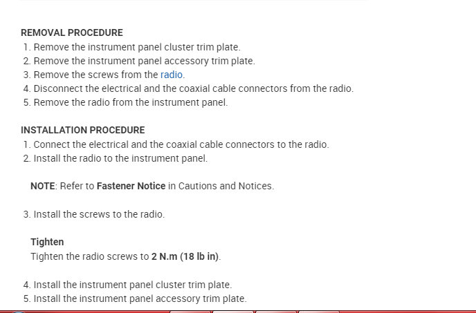

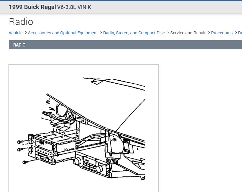

Purchasing a new 2-DIN car stereo. But before purchasing one, would like to know the dimensions so it can fit perfectly in the space occupying the factory radio right now.
I know the black panel that extends the width of the car comes out. My question is, do I have to remove the climate control unit and panels to get to the radio? I really don't want to go through that again considering I had just done that to replace the climate control unit.
Oct 1, 2019 at 8:33 PM
SCGRANTURISMO
  • 4,897 POSTS
I have included the vehicle manufacturer's instructions for the removal and installation of the radio in your vehicle. I hope this helps. Please get back to us with how everything turns out.
