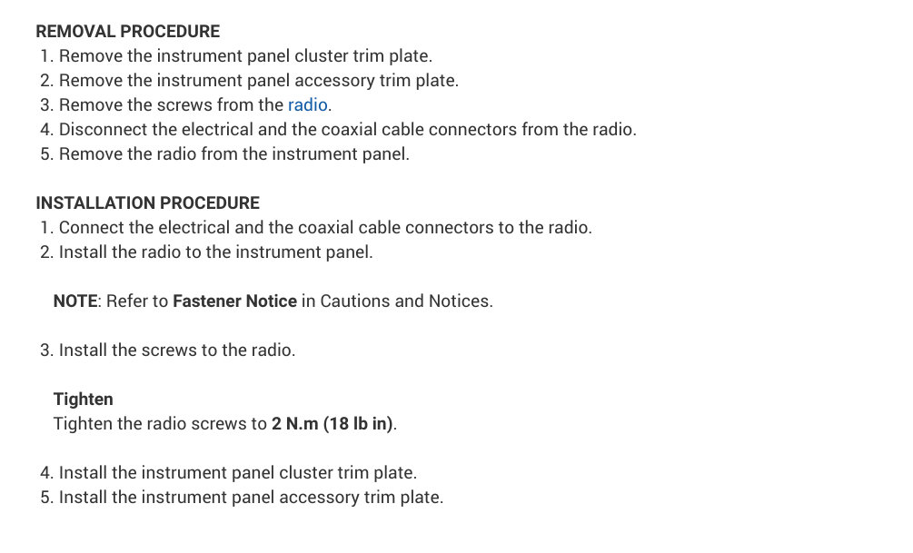

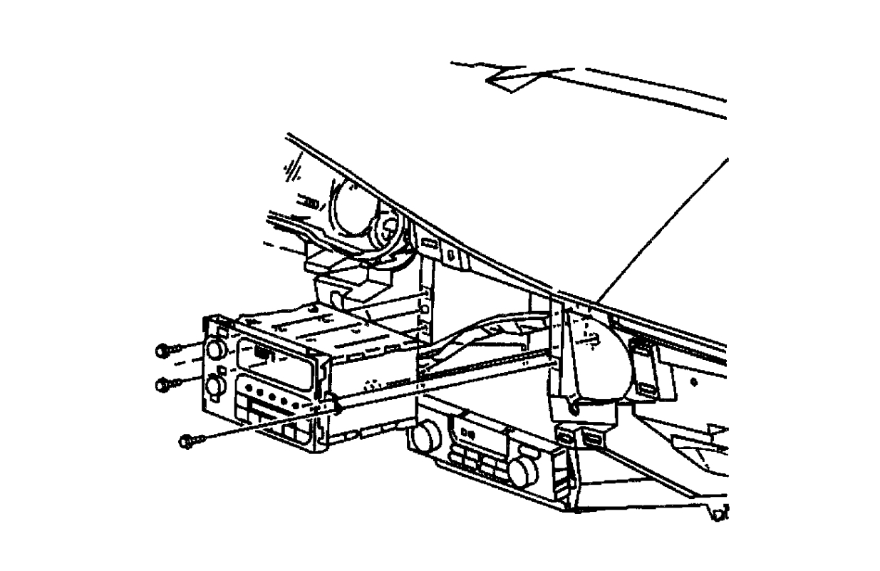

Hello again,
The best way to get the exact measurement of your vehicle's stereo would be to remove it and measure the dimensions with a tape measure. In the diagrams down below I have included the instructions for the removal and installation of the radio in your vehicle. Please get back to us with how everything turns out.
Thanks,
Alex
