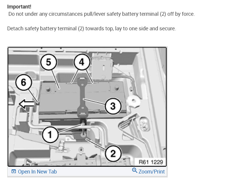

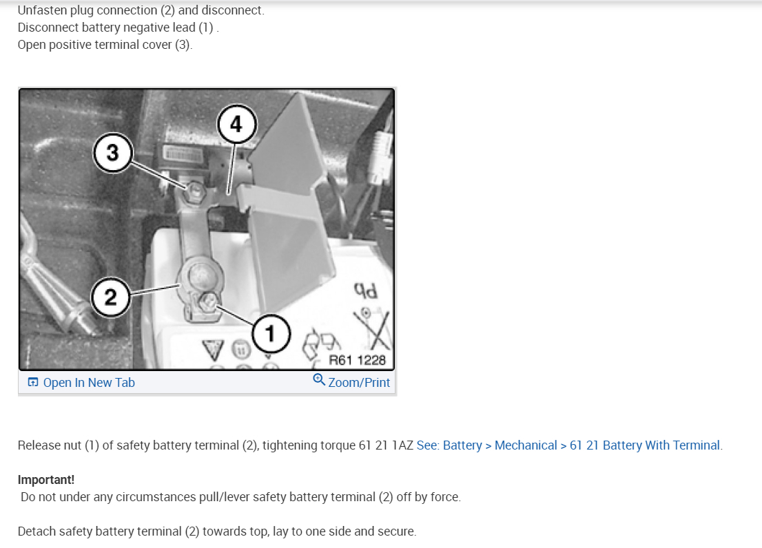

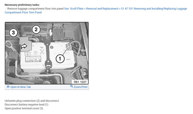

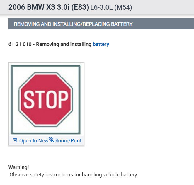

The battery voltage is low, which is what I would address first. Also, I would check the charging system.
Here is a guide to help us get started:
Also make sure the cables are clean and tight.
Here is a guide to help:
Here are guides to help you change out the battery and have it checked/replaced. If everything checks out, I would do a CAN scan which is different than a simple engine scan. You can get a CAN scanner (Controller Area Network) which will work on most cars from Amazon.
