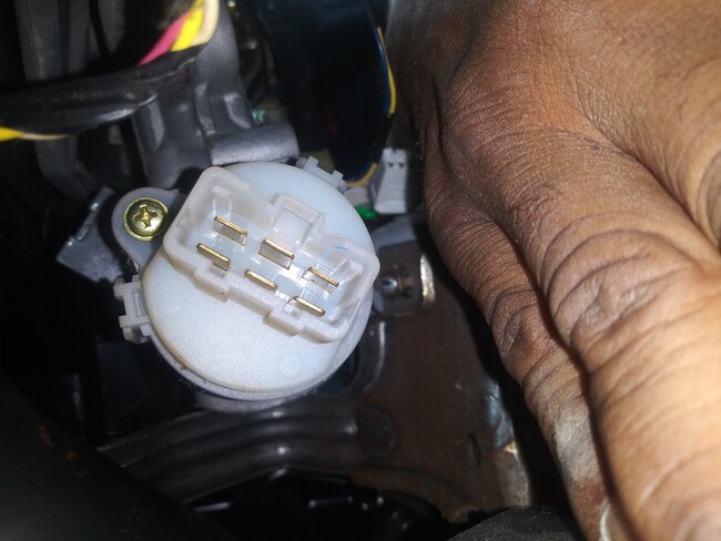

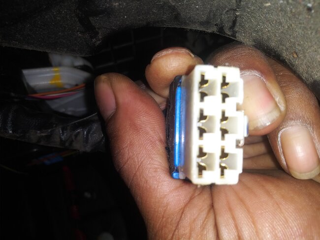

Images of connector on the switch.
Jul 10, 2024 at 10:44 AM
STEVE W.
  • 15,423 POSTS
Okay, so you pulled the fuse, and it stopped trying to start in ACC? In that case take a test light connected to ground and go to the start fuse again. Turn the key to ACC and then touch both of the contacts where the fuse was. Watch the light, now turn the key to start and hold it and probe again. If the light comes on in ACC there is a problem in the switch or its wiring. It should only come on in start. You said the switch was replaced? Was that for this same issue and is the switch OEM of aftermarket?

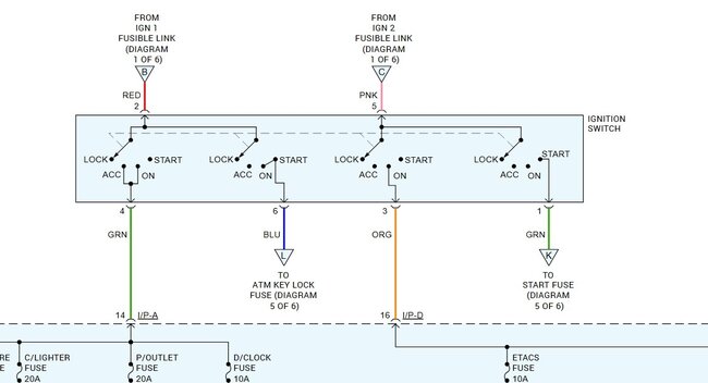

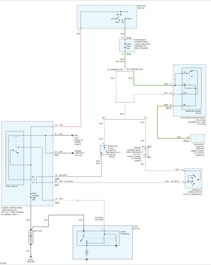

Okay, that might make it easier as it sounds like the issue is voltage feeding back through the switch. Take a test light and see if there is voltage on the green wire at terminal 1 when the key is in the on position. Disable the injectors as I had you do above (remove SNSR fuse 3) Use a pin or needle to probe into the back of the connector with it connected to test that. The green with in pin 1 should only have power with the key in start. If it has power when the key moves into the run position, then there is a problem in the wiring that feeds the switch. To verify it isn't the switch use a multimeter to check between the same two terminals with the switch unplugged. While rare it could be that the switches are made poorly and causing the problem, although I think it's more likely in the wiring harness itself.

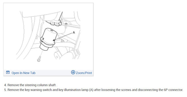

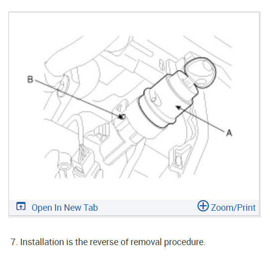

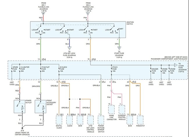

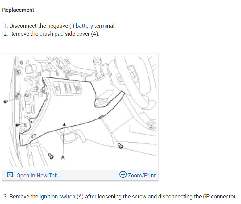

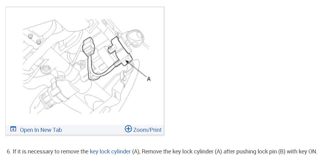

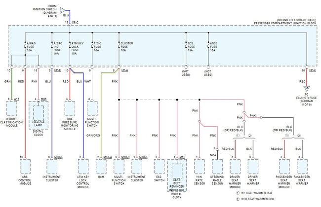

Hey Steve, before I check the wiring could it be in the electrical part of the switch not the lock and key part?
Aug 14, 2024 at 7:39 AM
  • 55,865 POSTS
Yes, it could I thought you said you replaces that. I would replace the "switch" apart of the ignition switch. Let us know what happens. Here is how to change the switch out, also if this is not the problem I have seen the junction box on the passenger's side go out and can cause strange issues like this one. Check out the images (below). Please let us know what happens.
