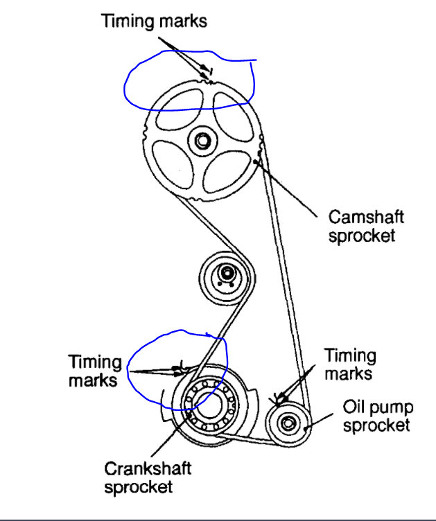

I replaced the crankshaft positioning sensor, the coil packs, the timing, and balancer belt. drove two blocks it shut off. it turns over starts again and then makes a sputter noise or backfires shuts off out again. what's the problem?

Backfiring usually comes from the timing.
https://www.2carpros.com/articles/engine-backfires-while-running

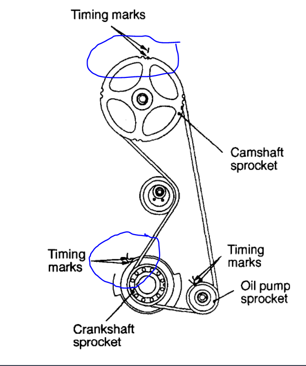

I would double the timing belt and make sure it did not move or is set wrong. Check the compression and see if you have 140-160 in each cylinder.
I attached the diagram for the marks for you to verify.
