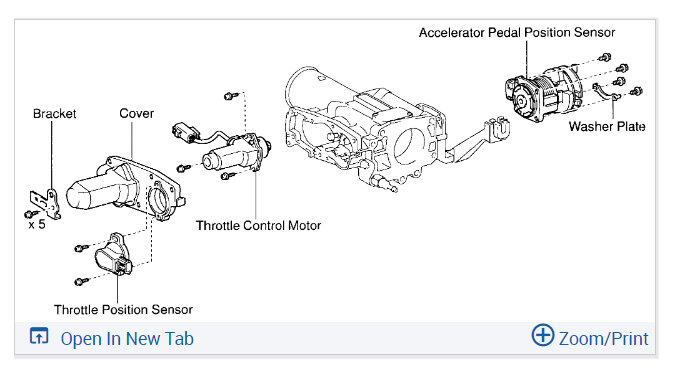

Running until I crossed jumped it. Blew fuse and replace but car would start then shut off. A/C working , sunroof working.
Jul 30, 2024 at 10:58 PM
  • 55,447 POSTS

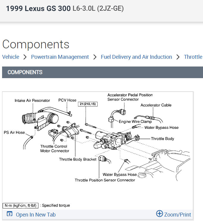

Okay, yep, the car battery does not like to be connected backwards, it sounds like the throttle bore control motor has gone out, here is a guide to help explain more what's going on:
https://www.2carpros.com/articles/resolving-reverse-battery-connection-in-cars-a-step-by-step-repair-guide
We should run the codes to see if any are stored, which can help us see what needs to be replaced.
Here is how to change the throttle body out in case it is stored for it. Check out the images (below). Please let us know what happens.
