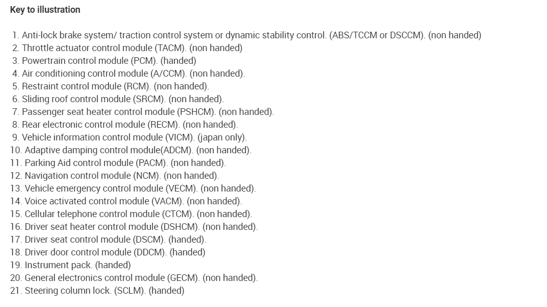

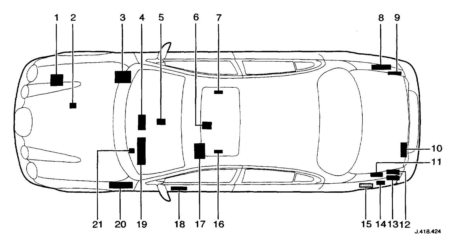

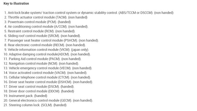

Hello good evening, can you please send me an image or diagram showing where the driver module is located on Jaguar 2003 s type car? I do not know where it is located. Thank you.
Oct 30, 2018 at 8:30 AM
  • 55,433 POSTS
Here are the locations of all the module for the car. Check out the diagrams (below). Please let us know what happens.
