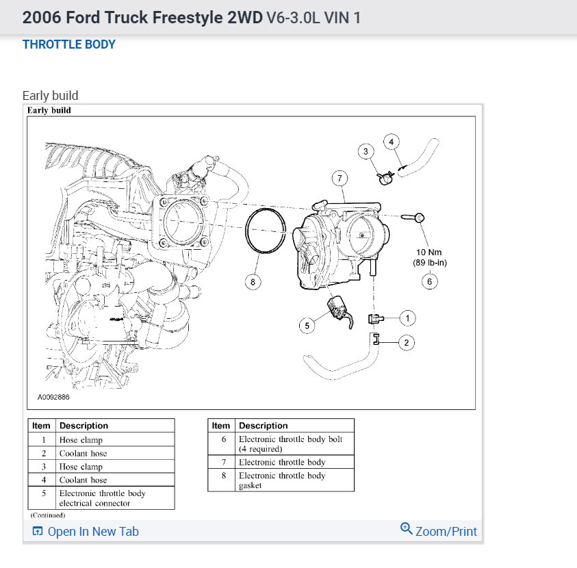

I have the vehicle listed above Freestyle. This issue started today, where the car turns over, starts and then instantly stalls. In hindsight the last few months it took longer to start than usual. Remote start would turn twice before it would run. There is no CEL and as far as my data stream all appears normal. I changed the mass air flow sensor just out of desperation, to cross something off the list. Currently I am leaning towards the throttle body but need a way to prove the problem. But I am nervous after reading about reteaching the throttle body. Any info encouraged. Thanks
Feb 20, 2023 at 12:51 PM
  • 55,224 POSTS
Hello Jeffery,

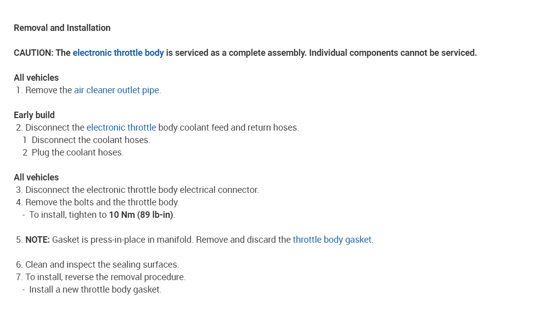

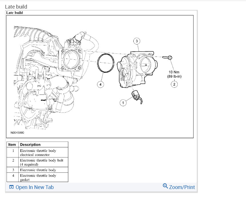

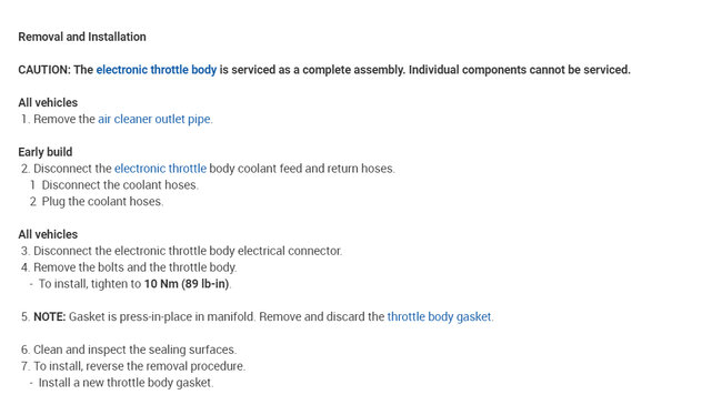

You are on the right track with the throttle body, that is the free place I would look, and it is not too bad of a service to perform. Here is a guide that will help you and I have left instructions in the images below on how to do the job on your car:
This guide may help as well because it could be a vacuum leak. Only do this test when the engine is cold:
There doesn't seem to be a throttle relearn so you should be okay, if it does start and stall feather the throttle until it relearns. Please let me know what happens.

I am going to pull the throttle body when I get home and inspect and clean it. I do have a smoke tester, but I don't know if you may agree the fact that it happened out of no where seems less likely of a vacuum leak. Also, the owner (my father-in-law) had some surging when stopped, I never experienced it, but I don't drive the car. I will update on what I find. Thanks

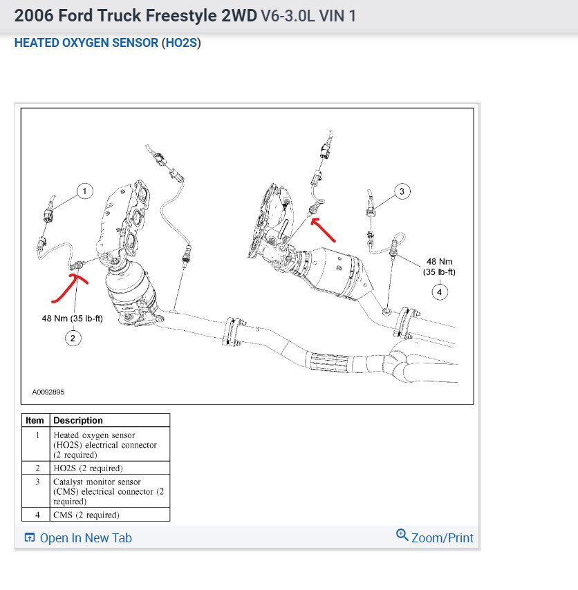

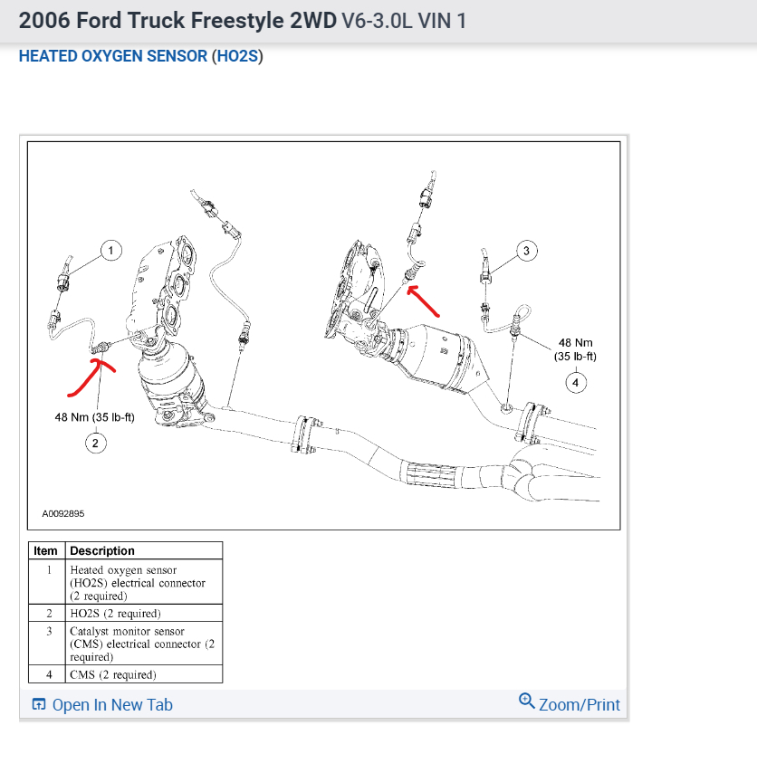

I am wondering if you have a clogged exhaust system or catalytic converter. Let's remove the primary oxygen sensors to see if it makes a difference. You want to have any power, but it should idle. Also, it might be a little noisy so be ready, here is the location of the sensors.
Feb 24, 2023 at 2:57 AM
