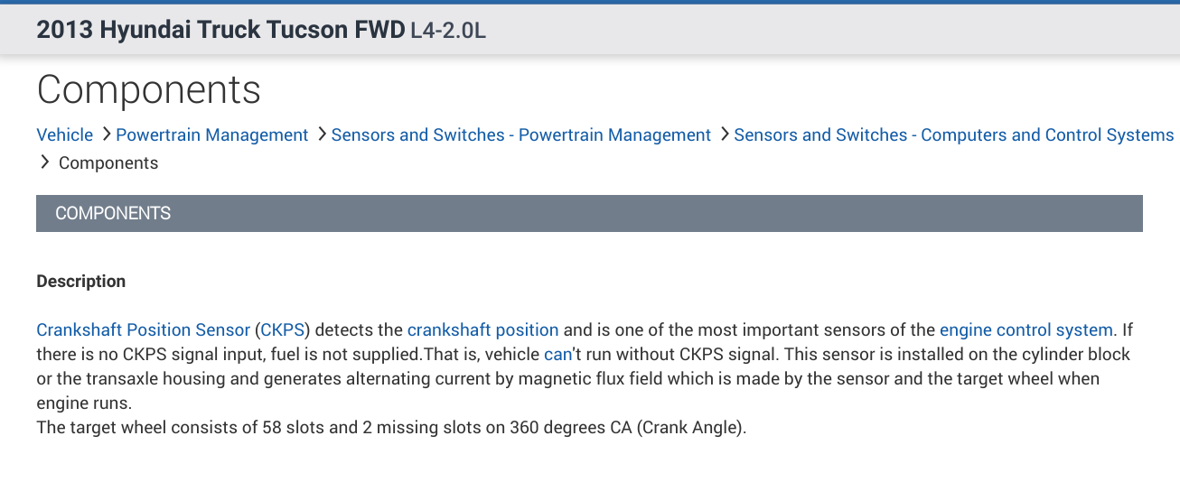

I just bought the car a few days ago. It was doing good until today. The car hesitated to start this morning at first. Second time it started normally. Then I went to Sonic to eat. While I was parked there the car cut off. I can’t remember if the radio and stuff was still on or not. The battery dash light and another dash light came on when this happen. I turned the key to off. I went to restart the car, it would crank but it wouldn’t start. I’m not sure if it would be the battery, starter, alternator, or what.

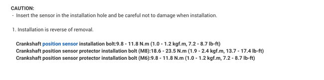

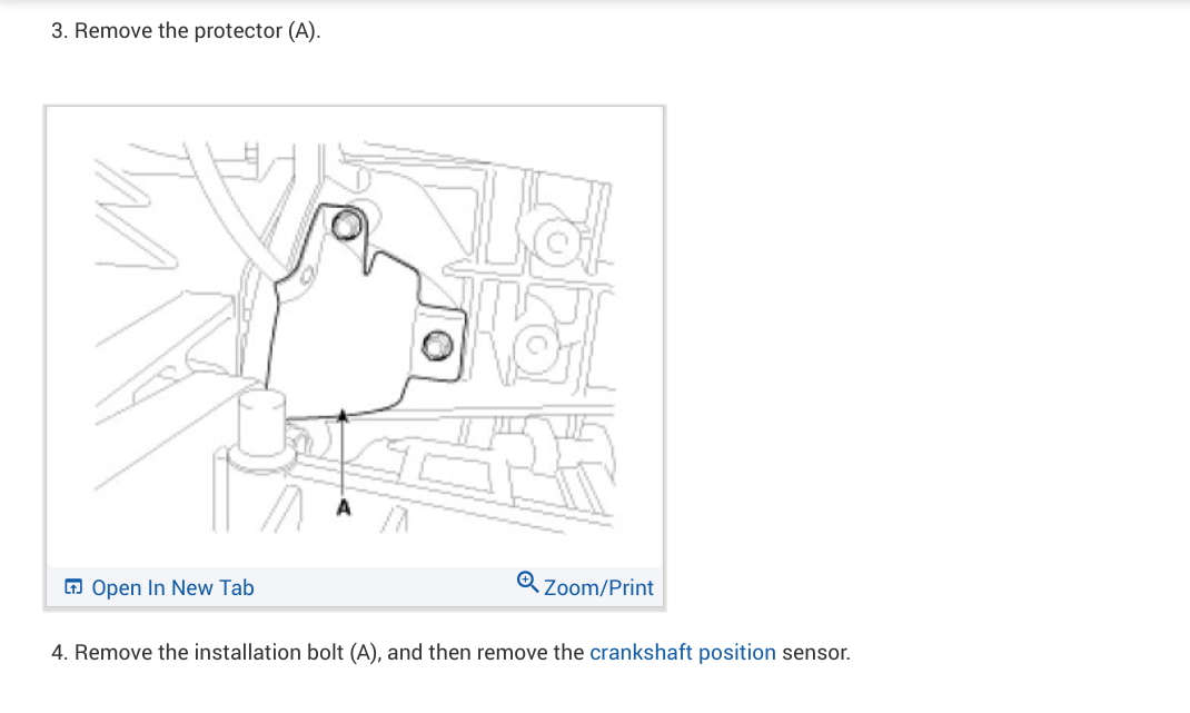

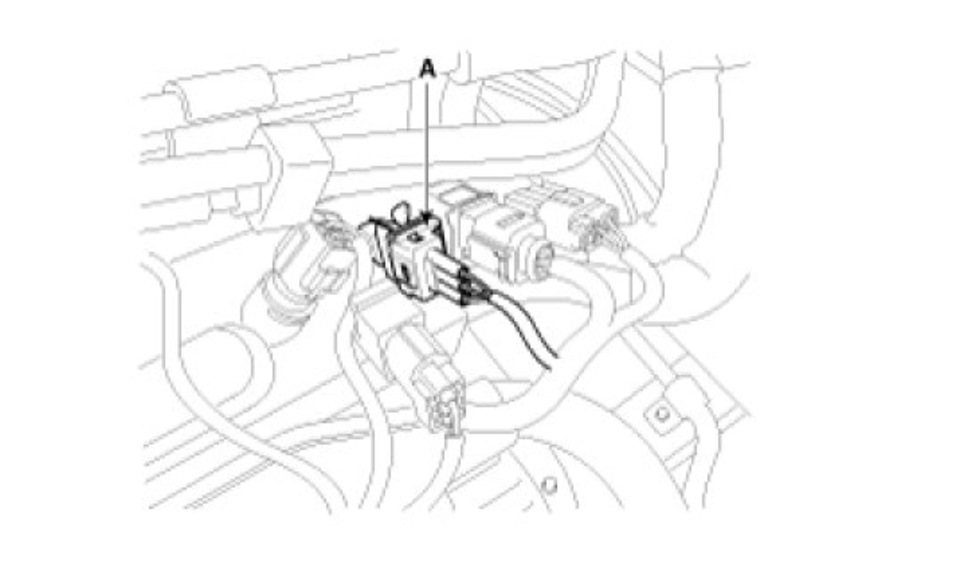

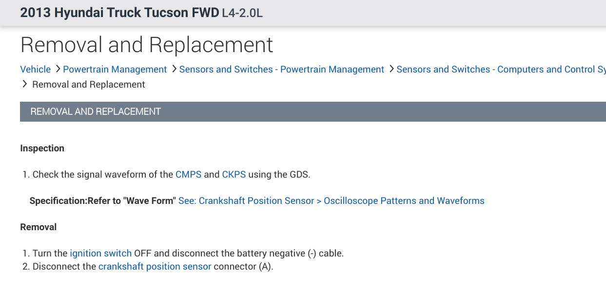

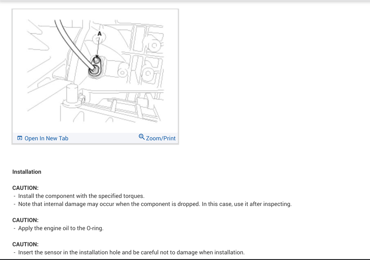

This could be a problem with your vehicle's Crankshaft Position Sensor[CKP]. In the diagrams down below I have included the description of operation and the instructions for the removal and installation of the CKP for your vehicle. Please go through these guides and get back to us with how everything turns out.
Thanks,
Alex
