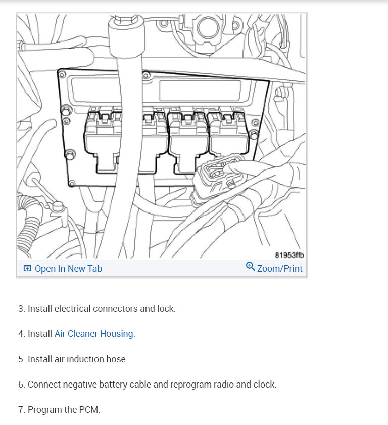

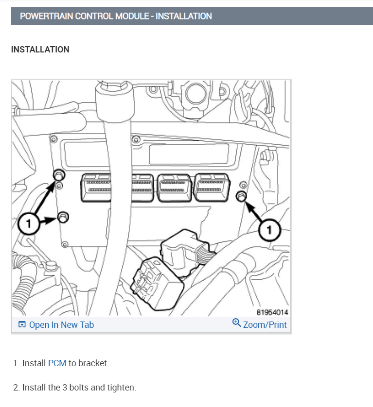

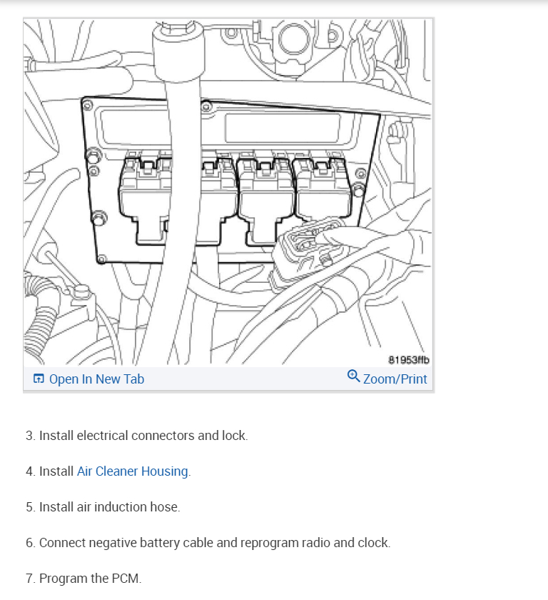

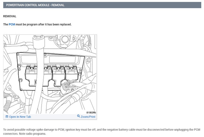

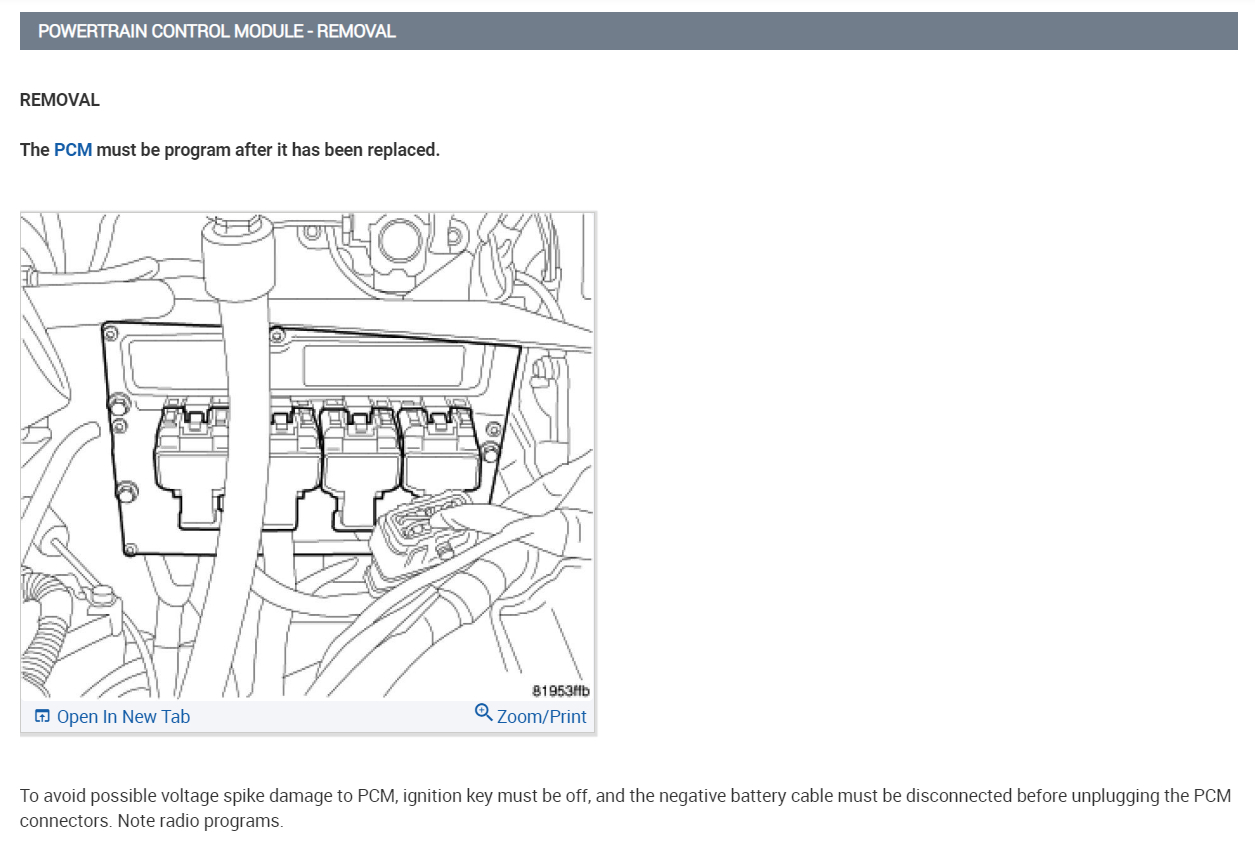

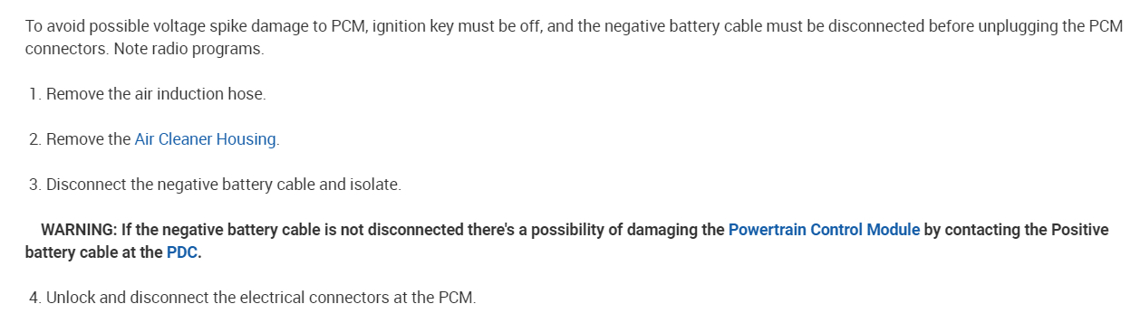

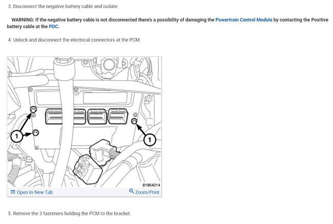

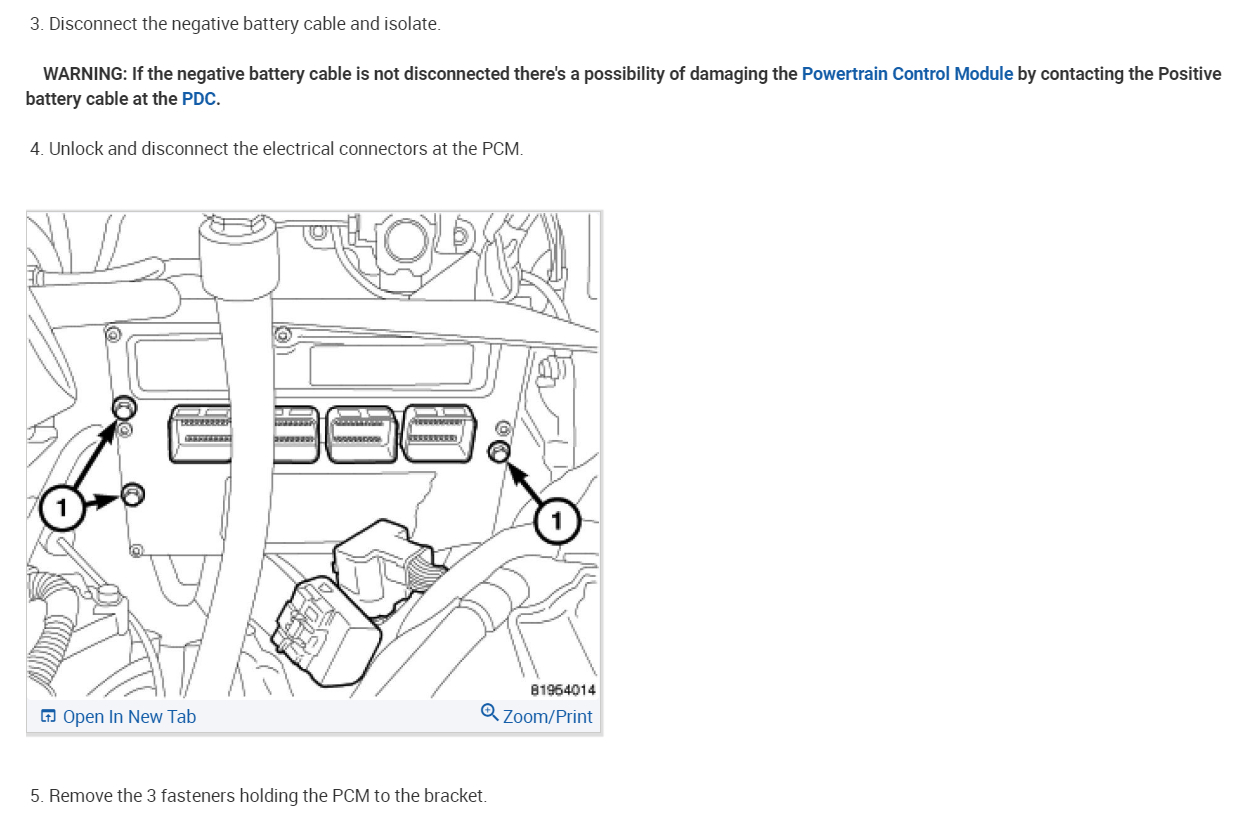

Hi Angela,
With this mean codes it acts like the PCM went bad, but to be sure let's clear the codes, then turn the key on to see which comes come back. do not start the engine, if none, start the engine for 15 seconds and run the codes again, what we are trying to do is see which codes pop up first. Here is the location of the PCM so you can check the wiring connector for corrosion and if okay replace the PCM. Check out the images (below). Please let us know what happens. You can get a rebuilt PCM by searching Google or eBay.
