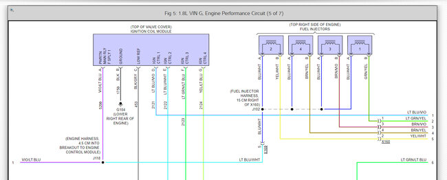

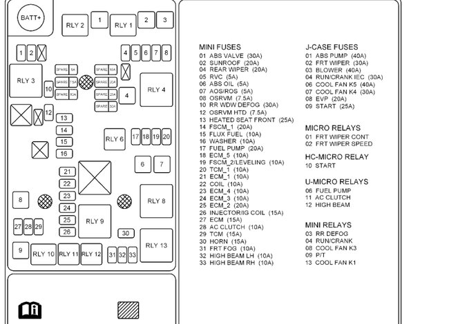

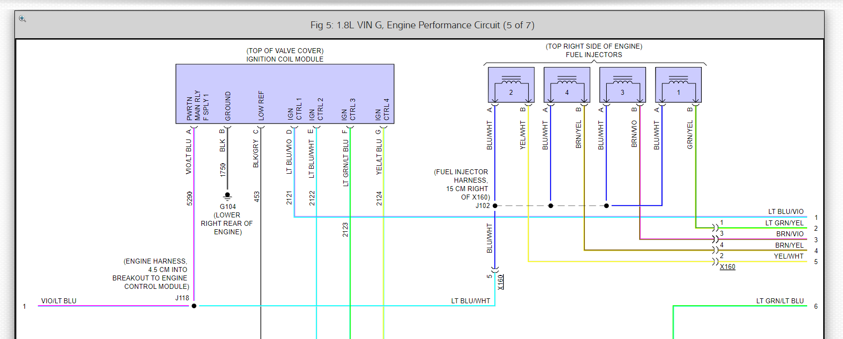

This mean the PCM went out or the power for the injectors system has a fuse blown. In the under-hood fuse panel please check the INJECTOR/IG COIL fuse, with the key on see if it has power are is a guide to help and the fuse location as well. If the fuse is blown you have a shorted fuel injector. With all if the injectors unplugged replace the fuse then plug the injectors in one at a time to find the bad injector.
P0261 low reference voltage number 1 cylinder fuel injector.
P0264 low reference voltage number 2 cylinder fuel injector.
P0267 low reference voltage number 3 cylinder fuel injector.
P0270 low reference voltage number 4 cylinder fuel injector.

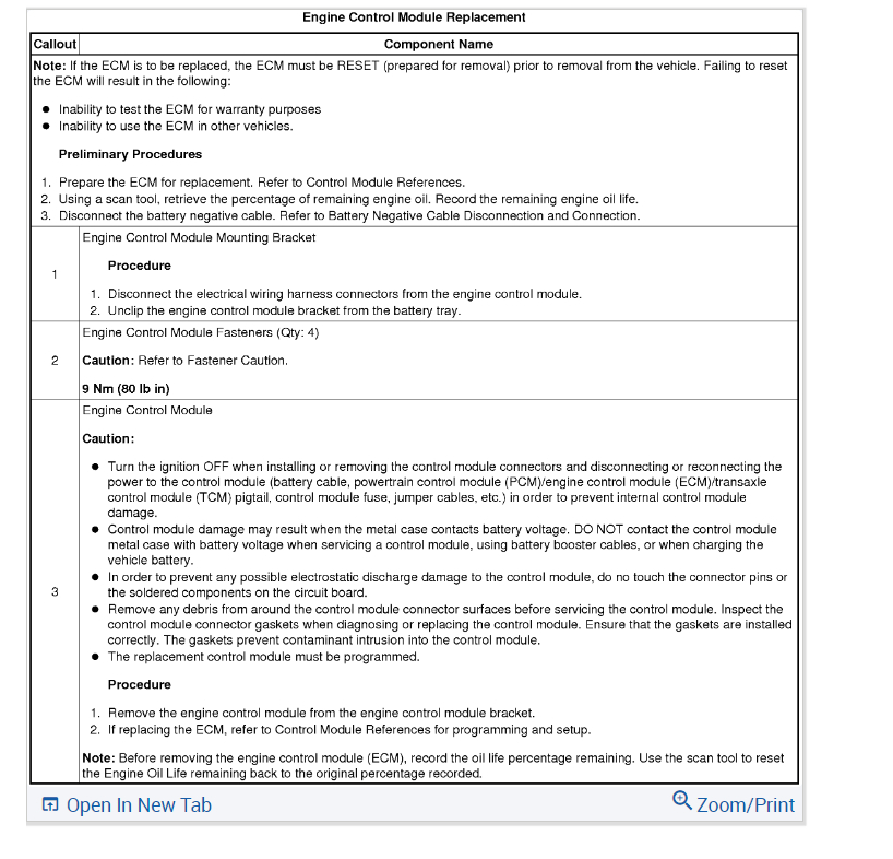

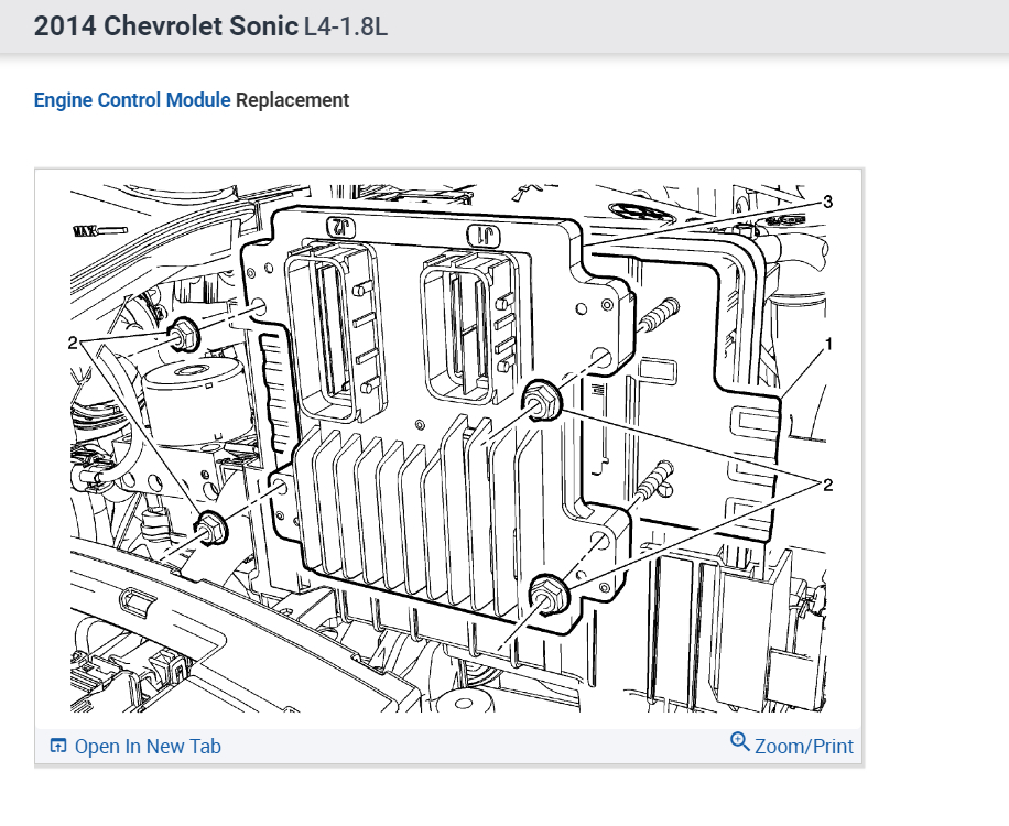

If the fuse is good and has power here is the location for the ground and how to replace the PCM in case, you need it in the images below. You can get a preprogrammed unit by searching Google or Ebay. Check out the images below and get back to me please.
