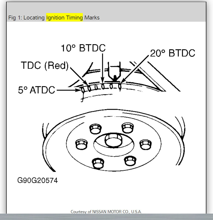

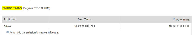

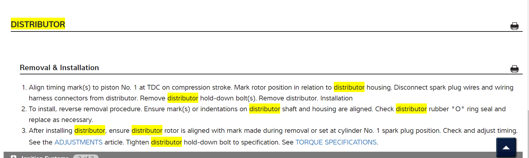

I understand that but is it the same size as the o-ring on the distributor base shaft. If I pull the distributor to replace the o-ring do you have a video for checking timing?
Tuesday, June 18th, 2019 AT 10:20 AM
SCGRANTURISMO
  • 4,897 POSTS

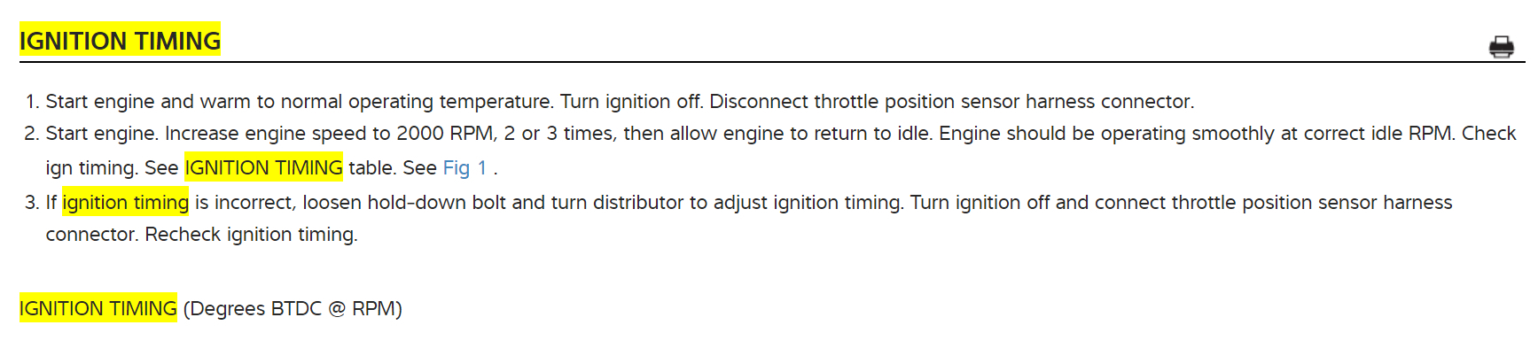

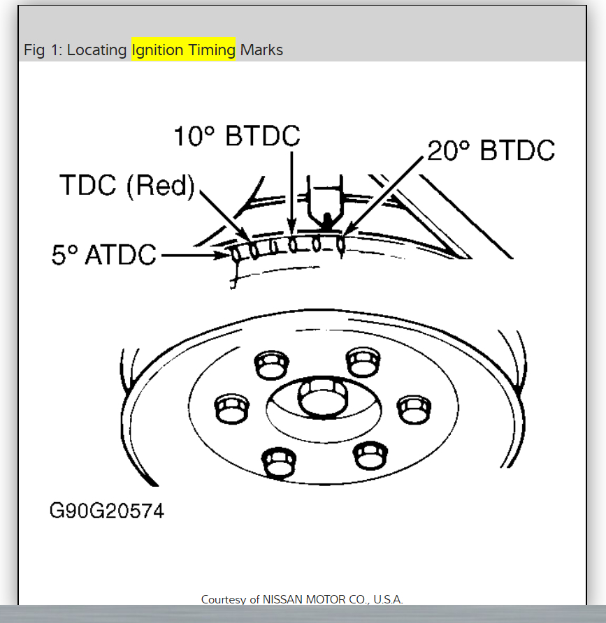

Hello again,
I don't believe we have a video of how to do a 1996 Nissan Altima ignition timing, but I have included the step by step directions from Nissan in the diagrams down below. Please go through this guide and get back to us with what you are able to find out.
Thanks,
Alex

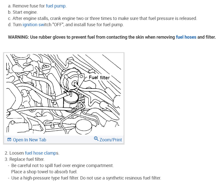

Thanks for the video, it sounds like you have a weak fuel pump or clogged fuel filter. Here is the fuel filter guide and location so you can change it with a guide to help you test the fuel pressure:
https://www.2carpros.com/articles/how-to-change-a-fuel-filter
and
At Idle With Pressure Regulator Vacuum Hose:
Connected .................... Approximately 235 kPa (34 psi)
Disconnected .................... Approximately 294 kPa (43 psi)
+1
Thursday, July 18th, 2019 AT 9:26 AM
JEFF HERMAN
  • 449 POSTS

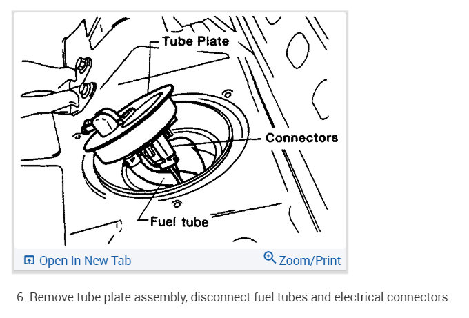

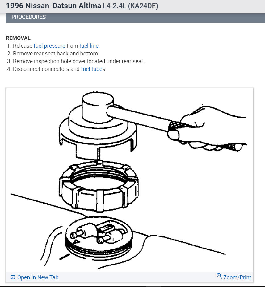

I tested the pressure and I thought it was very low but your specs are different then those online. Other sites say 50 psi. Mine was about 35 and 45 respectively and I just changed the fuel filter very recently. The car will fire without pressing the accelerator after a few seconds. It's just easier to give a little gas. No engine lights and no stalling recently? Still at a loss but looking for a newer car anyway. I would still like to know what's going on here though.
Sunday, July 21st, 2019 AT 2:32 PM
KEN L
  • MASTER CERTIFIED MECHANIC
  • 48,363 POSTS

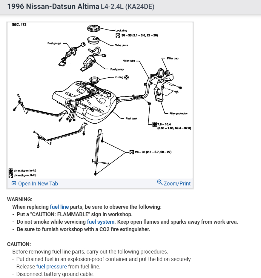

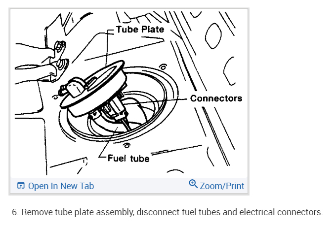

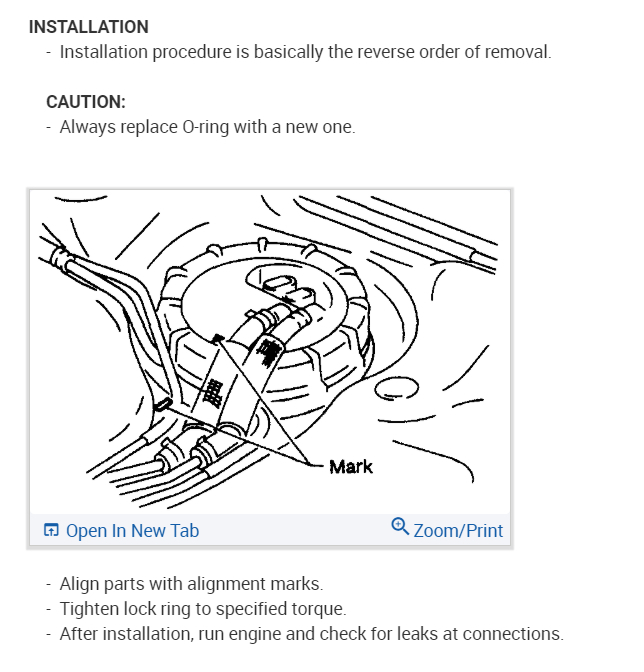

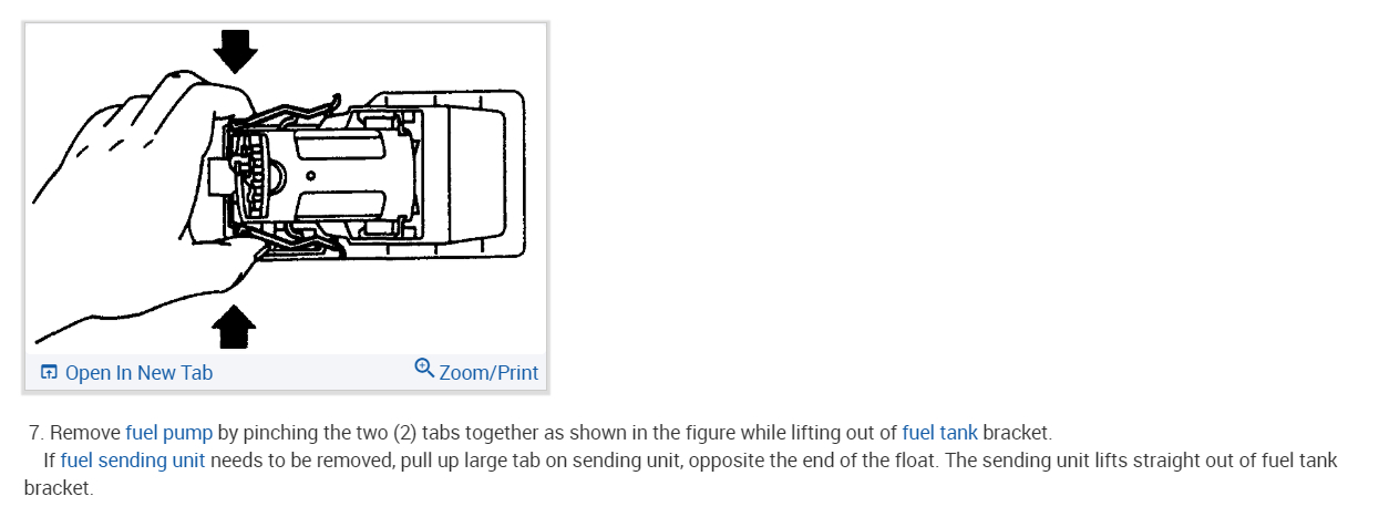

35, 45 psi is too low, I would replace the fuel pump here is a guide to walk you through the steps with diagrams and instructions below to show you how on your car.
https://www.2carpros.com/articles/how-to-replace-an-electric-fuel-pump
