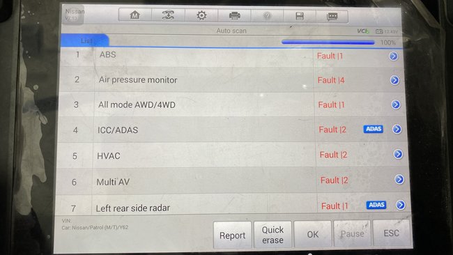

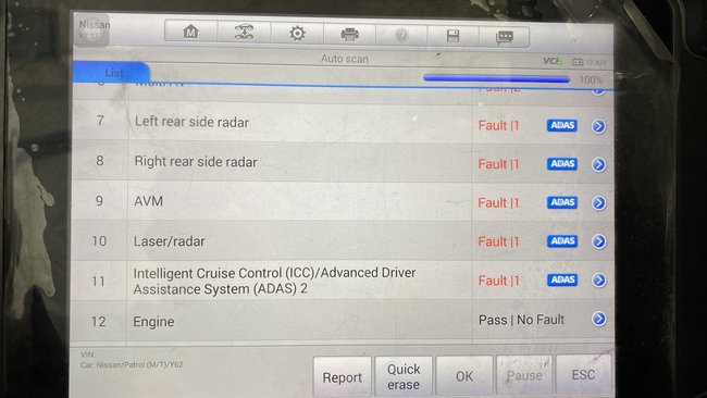

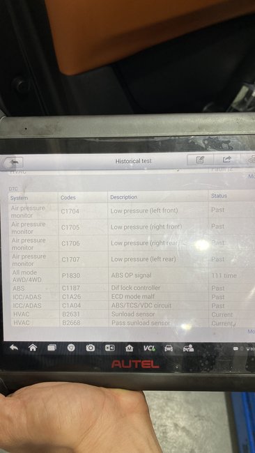

Thanks Kase, it’s great that now we are on the same page. There’s a development in my case, before I go to the dealer I decided to make OBD scan for the car and I got faults in the ABS system as shown in the photos. The technician who scanned the car told me it’s something minor probably programming error. He engaged and disengaged the “diff lock” system multiple times after that I drive the car and it feels very normal but I’m still confused to why there were faults in the ABS system showing in the OBD scan and no indication or warning lights on the car dashboard and what guaranteed it won’t happen again without indications. Anyway I’ll take the car to the dealer knowing for sure that there’s or at least there was something wrong with it.
May 23, 2021 at 12:43 AM
More than likely they disconnected something when they were inspecting it for the delivery to you when you bought it. Most of them look like they are no longer active or current so that means the issue is not current. This is why the lights would not be on. Those codes can stay in there for months as they are informational for the mechanic to look at when you bring it in. In other words, they want to keep the codes in there so that if the issue is not happening by the time you get to the dealer, the mechanic can still try and figure it out based on the codes that are in there.
However, I agree with you that this needs to go to the dealer and have them check it out. Please keep us updated with what they find.
