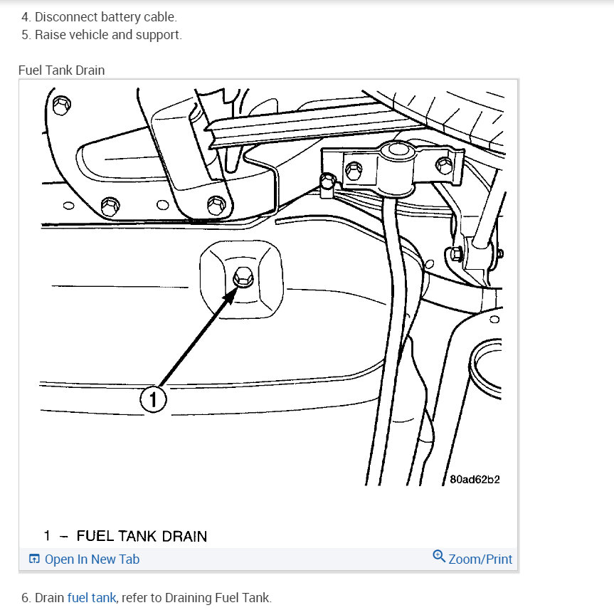

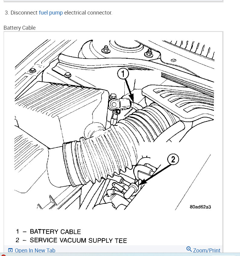

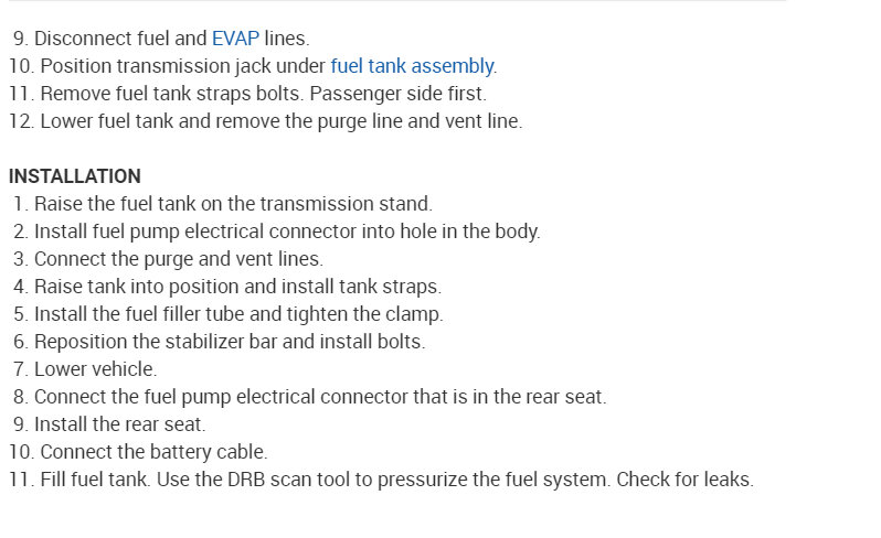

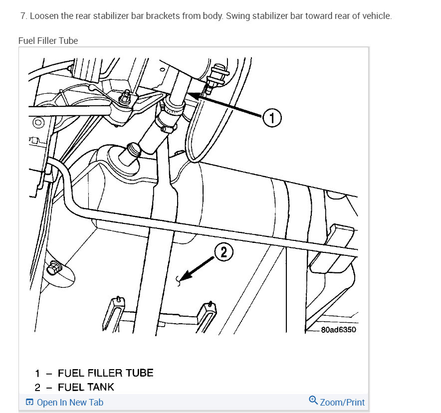

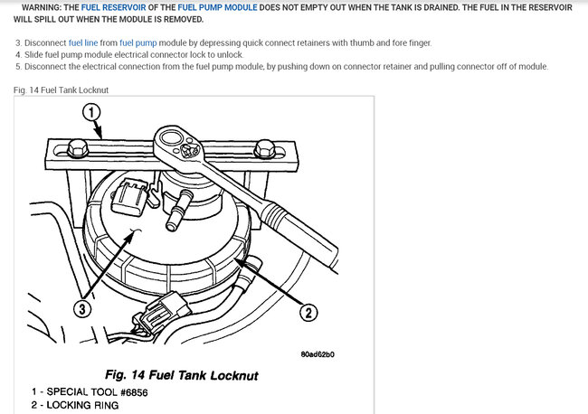

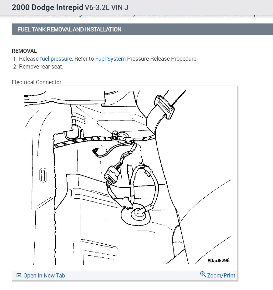

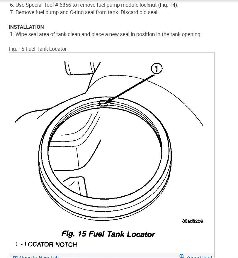

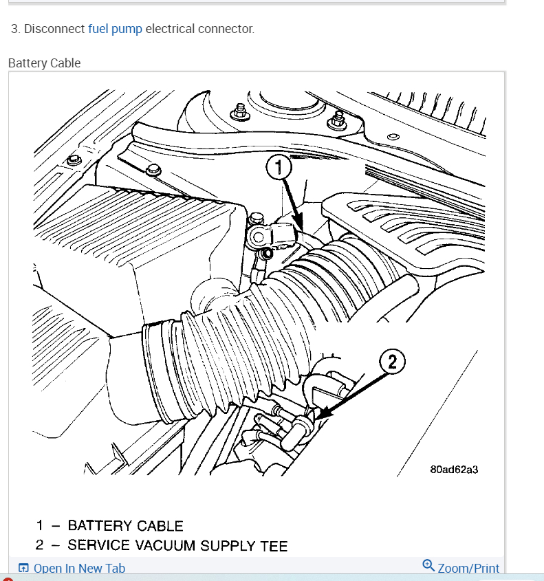

I put new crank and cam sensors on it yesterday, but still the same problem.
Jan 4, 2023 at 2:53 AM
  • 55,691 POSTS

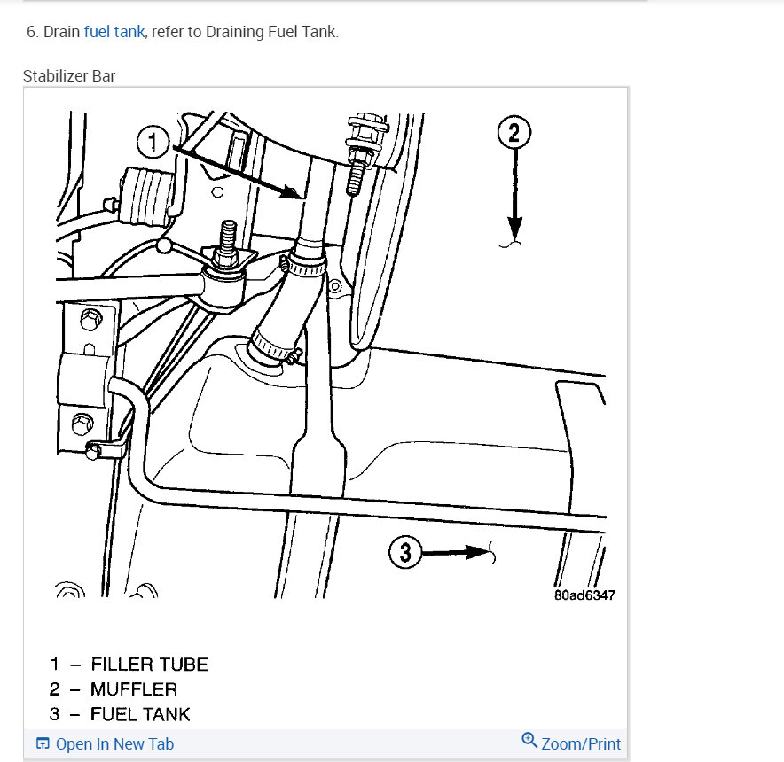

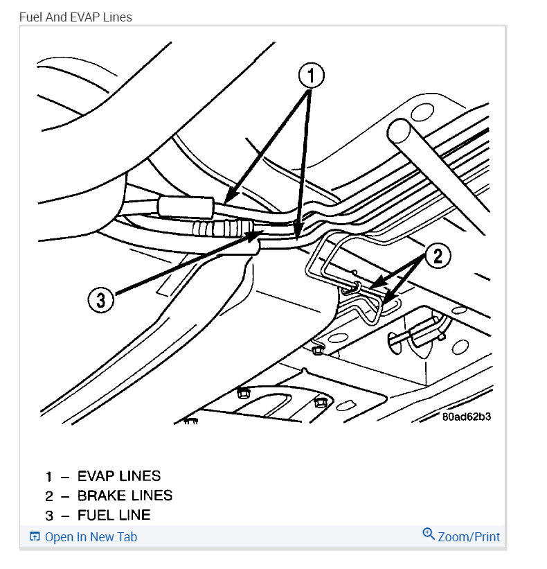

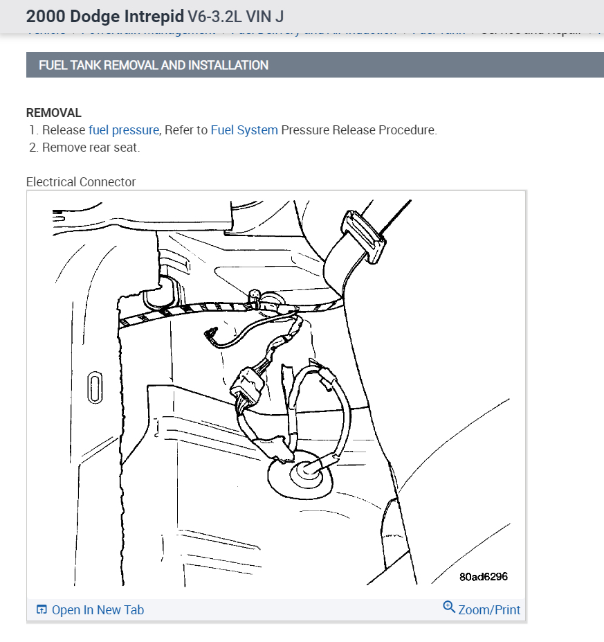

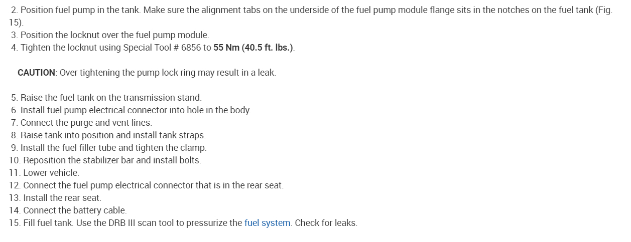

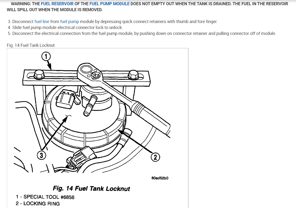

This sounds like the fuel pump is going out. here is a guide to confirm the issue with how to change the pump out in the diagrams below. You can get a pressure gauge from the auto parts store for cheap or free in most cases.
Deadhead Pressure 130 PSI
Regulated Pressure 58 PSI
This guide can help as well:
https://www.2carpros.com/articles/engine-cranks-excessively-before-starting
If the pump fails here is how to change it out. Check out the images (below). Please let us know what happens.
