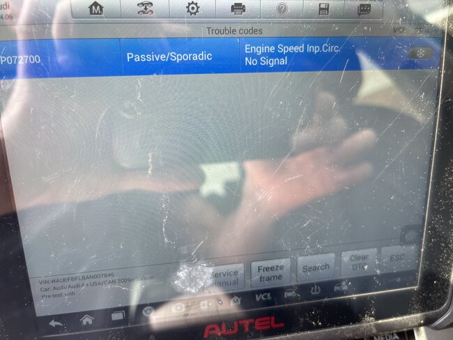

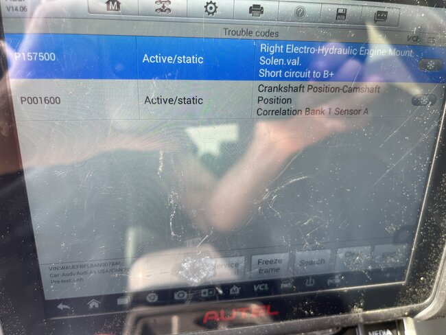

The car was fine, drives excellent, went to start it yesterday and it took a while to start, then went to move it and the engine is bogging, very little throttle response, takes forever to move at all, then stalls many times when put in gear. Based on these codes do you think it's the crank shaft sensor? Codes attached.

I did some reading on both codes. The 0016 indicates a correlation issue between the crankshaft position sensor and the bank one intake camshaft position sensor. Most commonly, it is a stretched timing chain, a failing timing chain tensioner, an electrical issue, and even dirty engine oil.
At this point, I recommend not driving the vehicle until this is resolved.
So, has anything been done to the timing chain recently? Is the engine oil maintained, clean, and full?

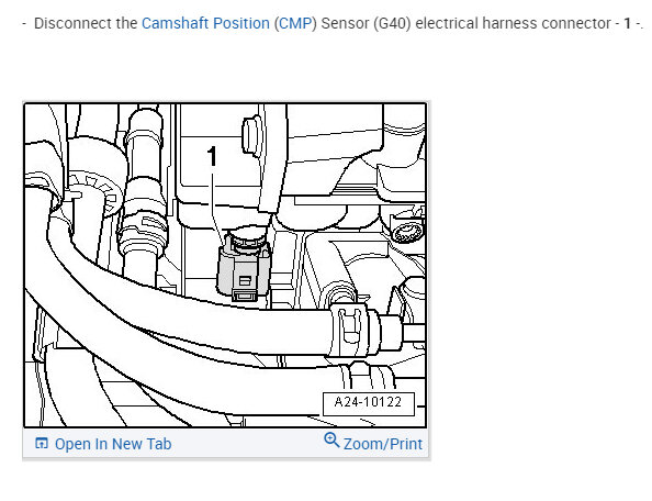

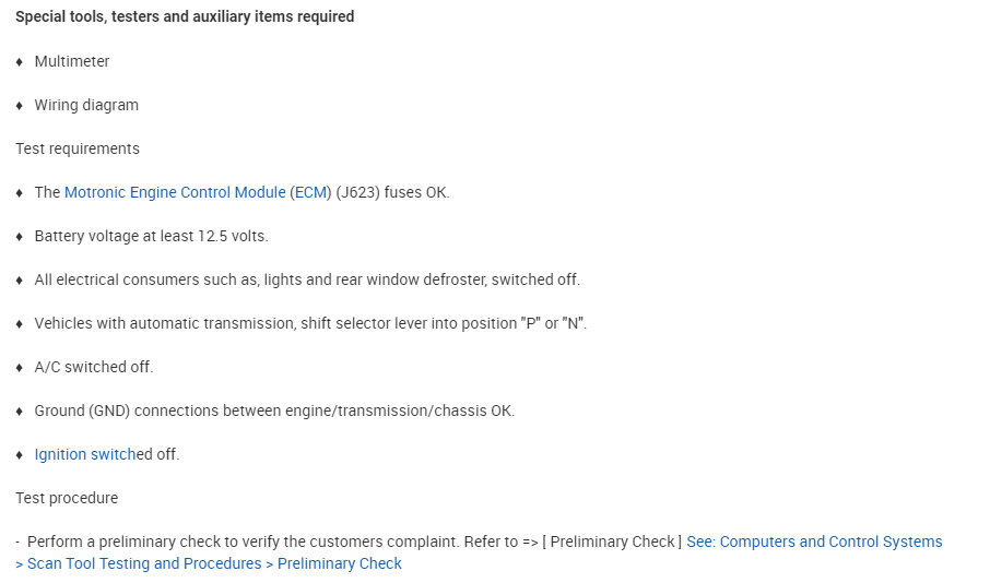

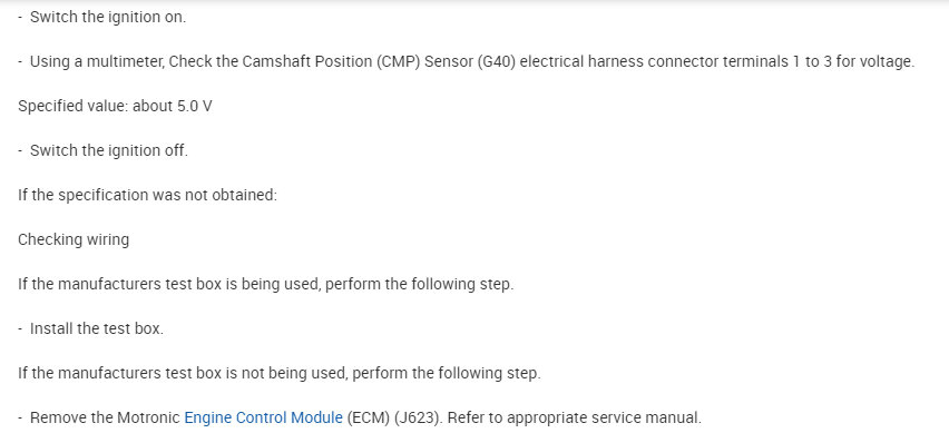

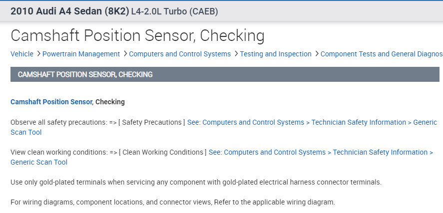

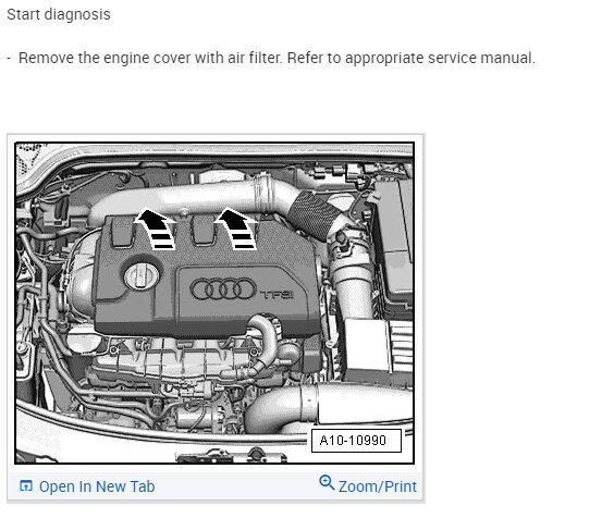

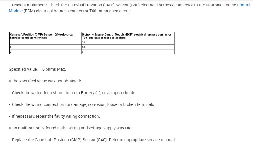

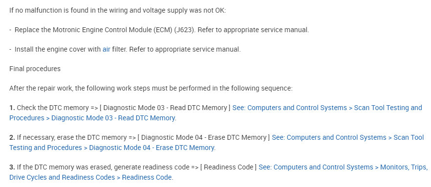

If you look below, I attached the diagnostics specific to the code as far as the electrical aspects. Take a look through them and let me know if you are comfortable performing them.

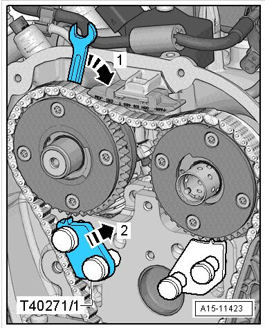

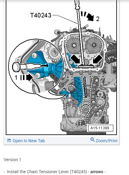

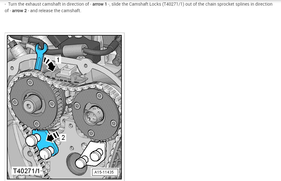

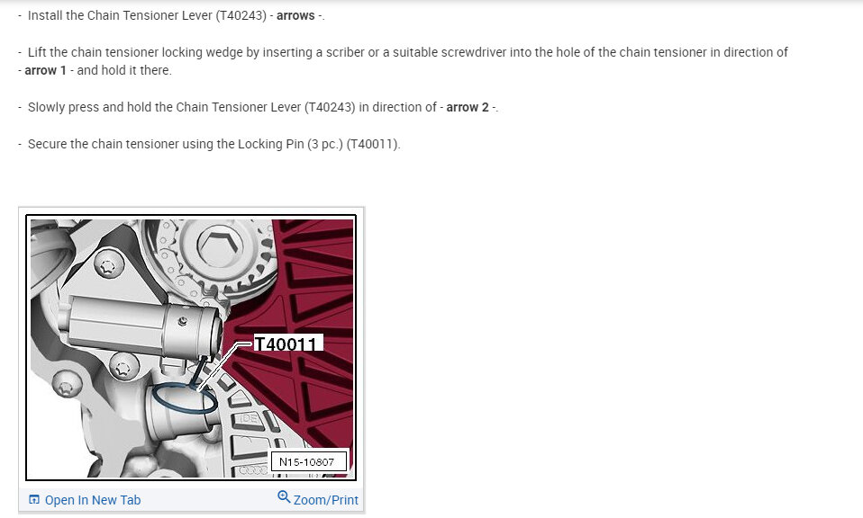

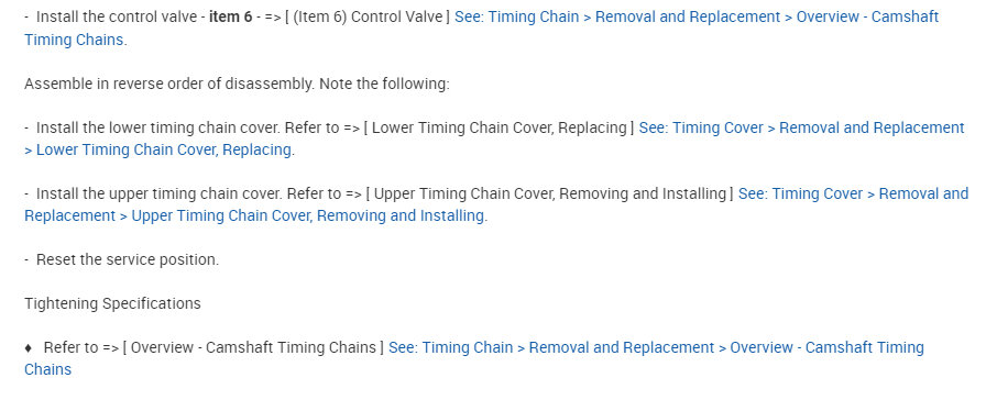

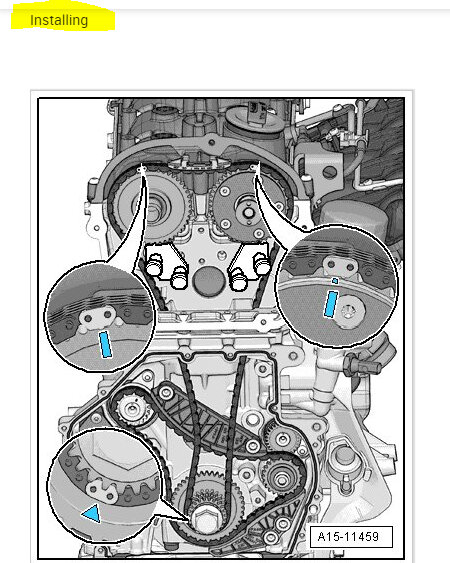

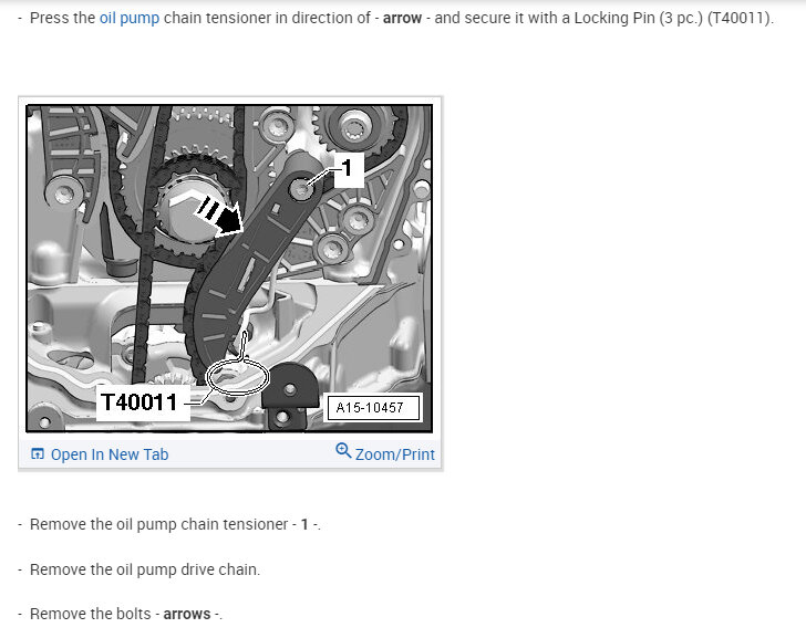

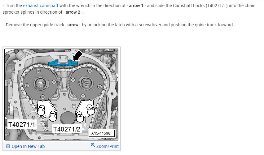

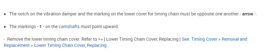

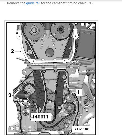

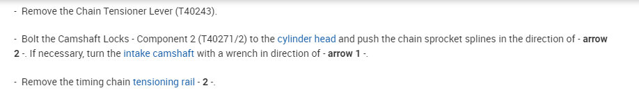

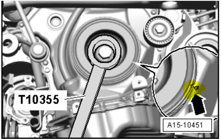

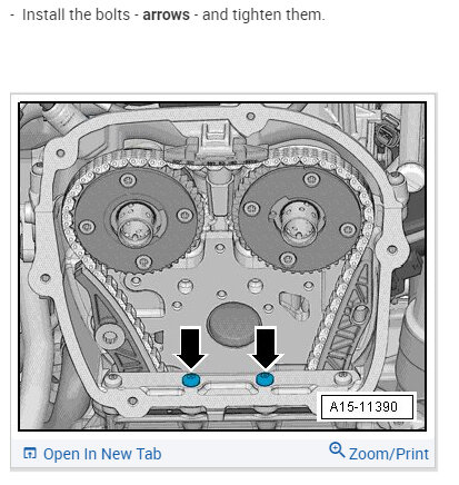

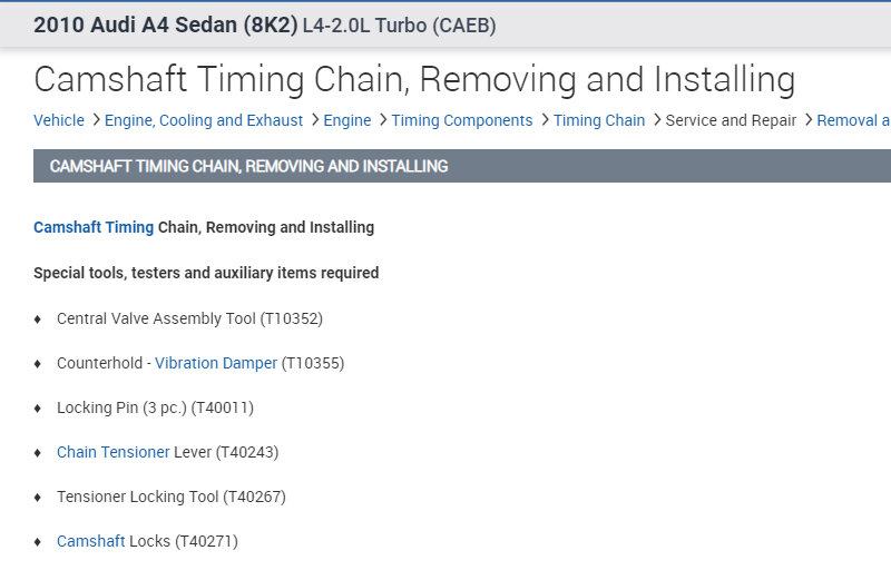

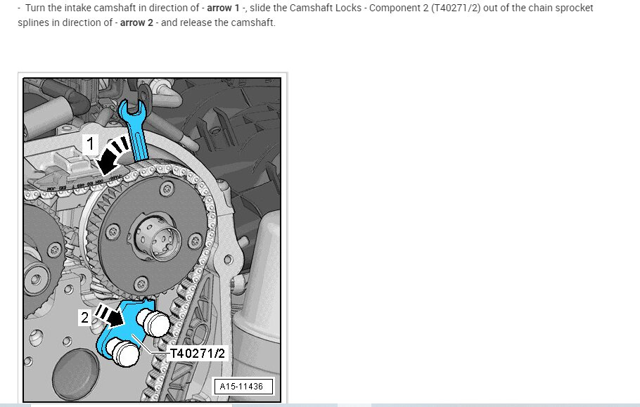

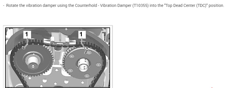

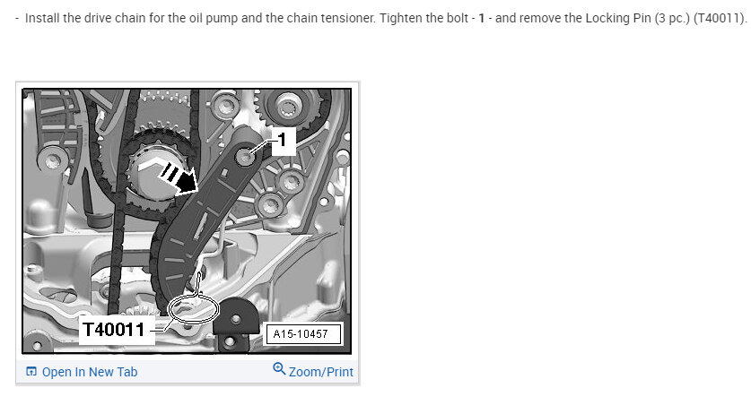

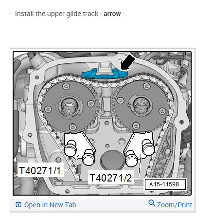

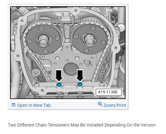

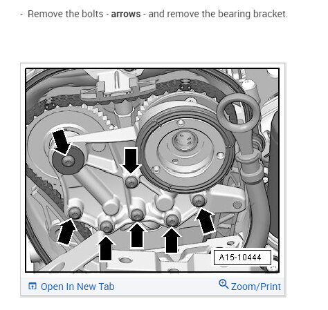

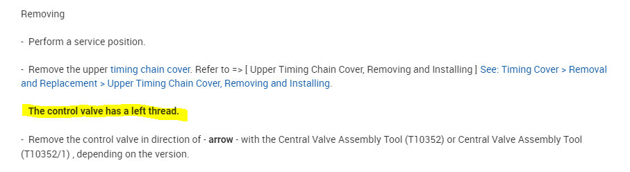

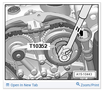

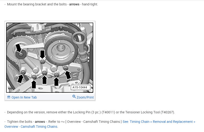

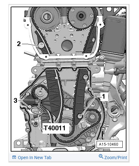

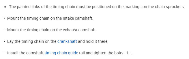

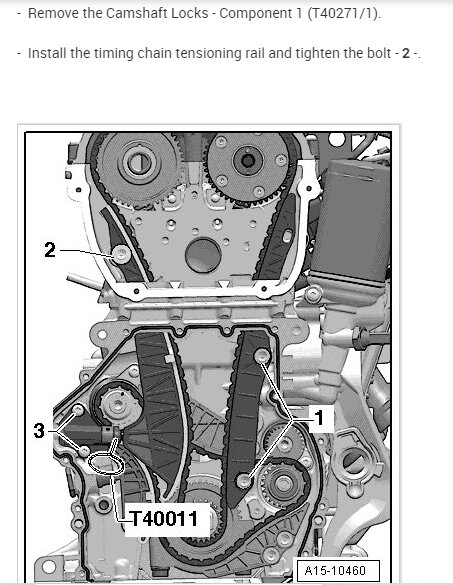

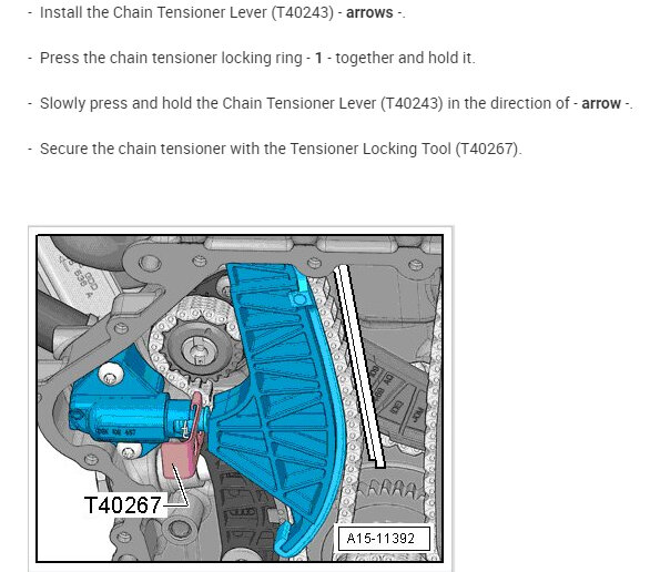

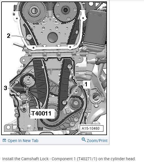

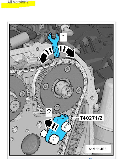

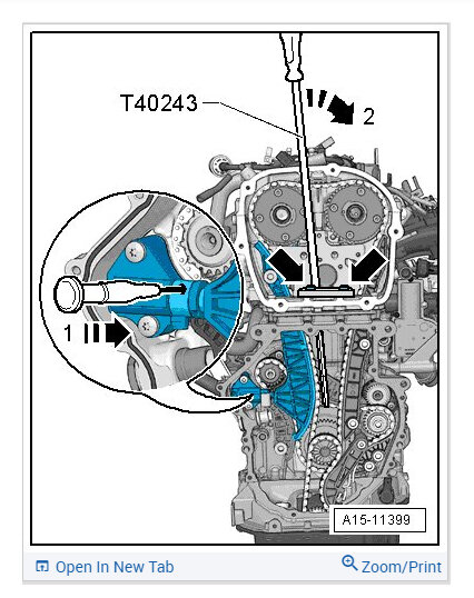

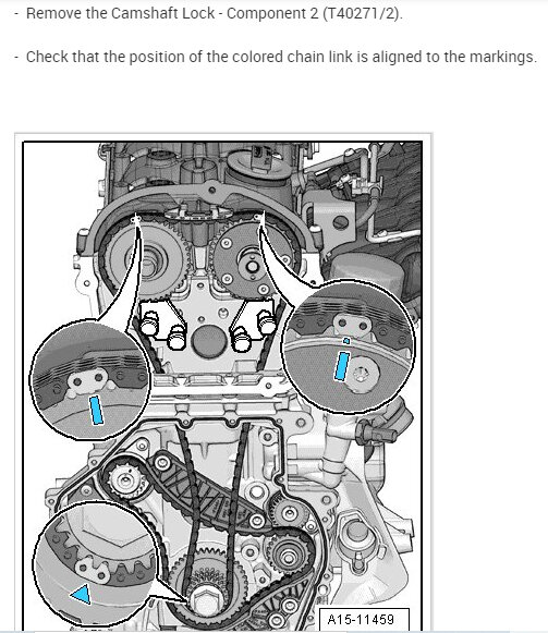

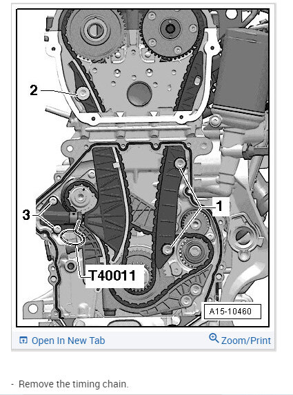

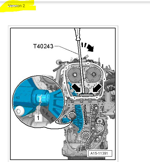

Is the timing chain something you plan to replace? If you are, I attached the directions below. Take a look through them and let me know if you have questions.
Also, there are two different versions of chain tensioners possible. Both are indicated in the directions.
Let me know if this helps.
