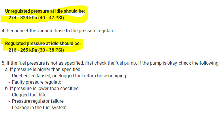

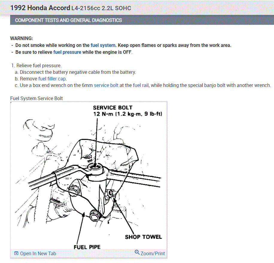

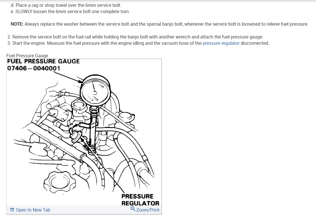

One Honda specialist said the fuel pressure drops below 10 PSI when this occurs and suggested the fuel pump. This same mechanic replaced the ignition switch (the problem was present then but not this bad) and said that the ECU was losing signal and was causing the car to stall out. But, i don't get codes for anything unless I unplug a sensor. The car also had the catalytic converter removed with the 02 sensor and i do not get a code for this. I know the ECU works because it gives codes for other sensors.
