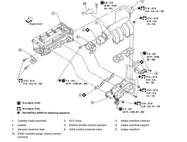

I have the car listed above that runs well except for about every 6 weeks it will stall out. It's always when I'm at a long red light. It starts up again right away, and then there's no problem again for the following 6 weeks. I took it to a mechanic who couldn't find thing wrong with it. Any ideas?
Nov 16, 2022 at 6:08 AM
  • 55,721 POSTS
This can happen if your engine has a vacuum leak, or the throttle actuator needs to be serviced. Also, did the mechanic run the codes? If not, we should do that as well.

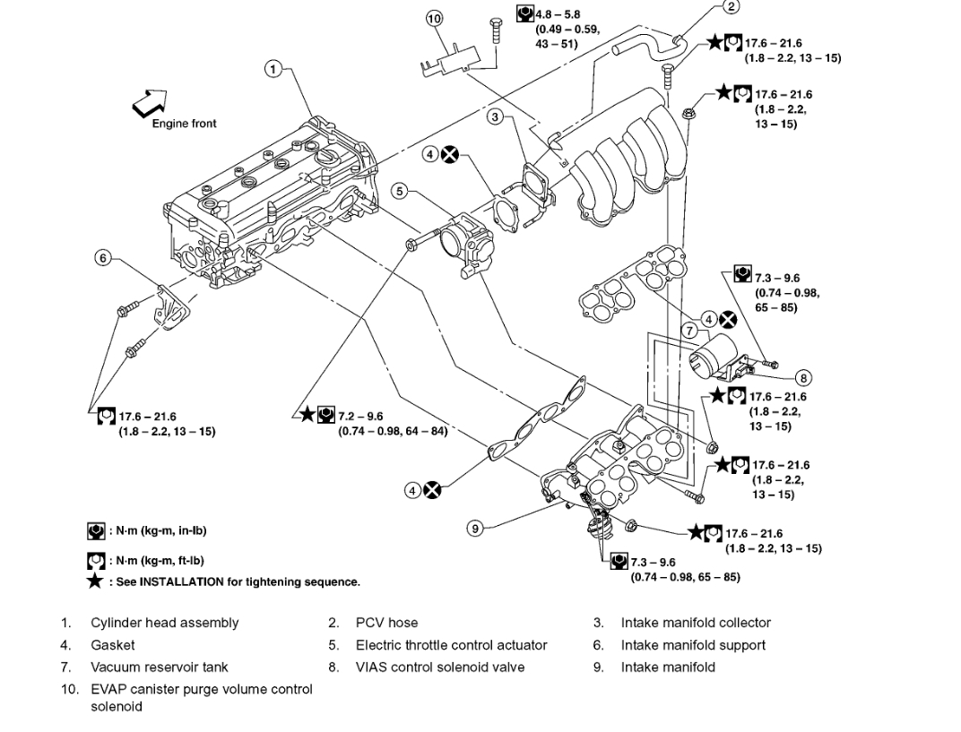

Check out the images (below). Please let us know what you find. We are interested to see what it is.
