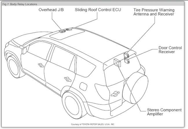

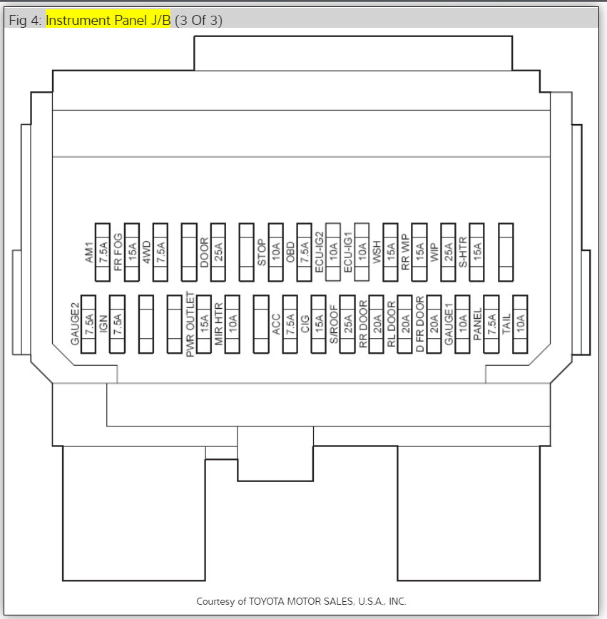

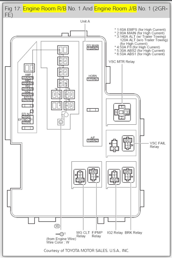

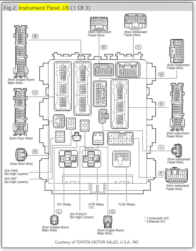

Can I get the code numbers please? Also have you checked all of the fuses? Here is a guide to help with that and the fuse location as well, test them with the key on.
Check out the images (below). Please let us know what happens. You might have burned up the main body ECU. I would do a CAN scan.
Feb 5, 2023 at 3:36 AM
