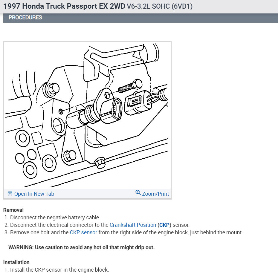

The car turns off out of nowhere, then it will only start back up after it has sat for about an hour. Then it starts and the same problem repeats. I need help!
Aug 30, 2022 at 3:41 AM
  • 55,433 POSTS
When it stalls can you hear the fuel pump running in the tank? If so, then I would run the codes and if none comes up replace the crankshaft angle sensor.
Here is a guide and the location of the sensor in the images below:
