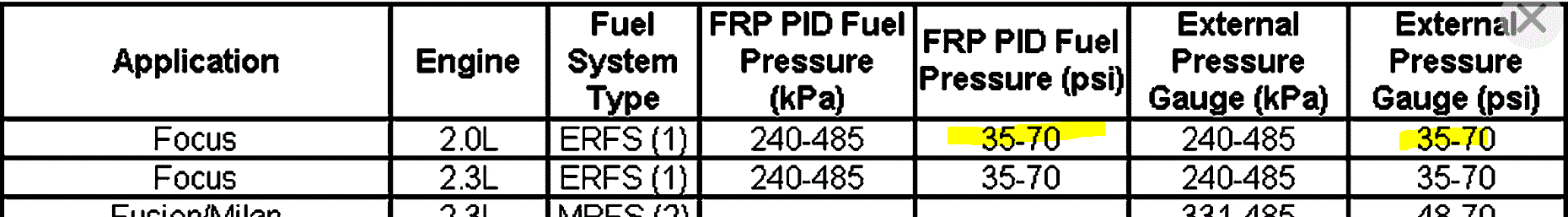

Car is a little slow starting in the morning. But on occasionally it will stumble and shut off.it did get a check engine light once. The Ford dealer told me it was the pressure switch on the fuel rail. I changed that still have the same problem. A private owned shopped looked at did scans, drove hooked up to a laptop couldn't find any problem. When it shuts off in just a few minutes it will fire back up and drive fine. On the couple of accusation it light the light. After driving it the light resets.
Feb 26, 2020 at 7:22 AM
  • 110,244 POSTS
If the light came on, there should be codes. Since it is slow starting in the morning, it sounds like a fuel pressure related issue. That is where I would start.
I need you to check fuel pressure to confirm it is within the manufacturer's specs. Here is a link showing how it's done:
The attached pic shows pressure specs for this vehicle.
Let me know what you find.
