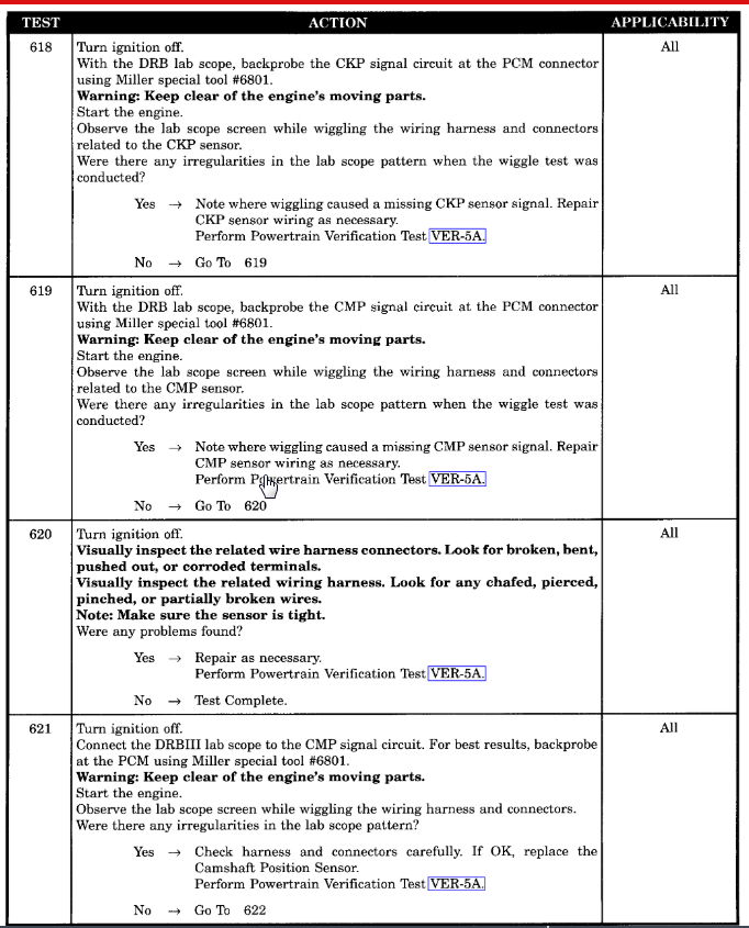

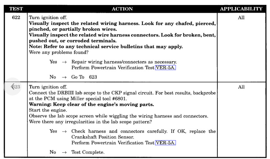

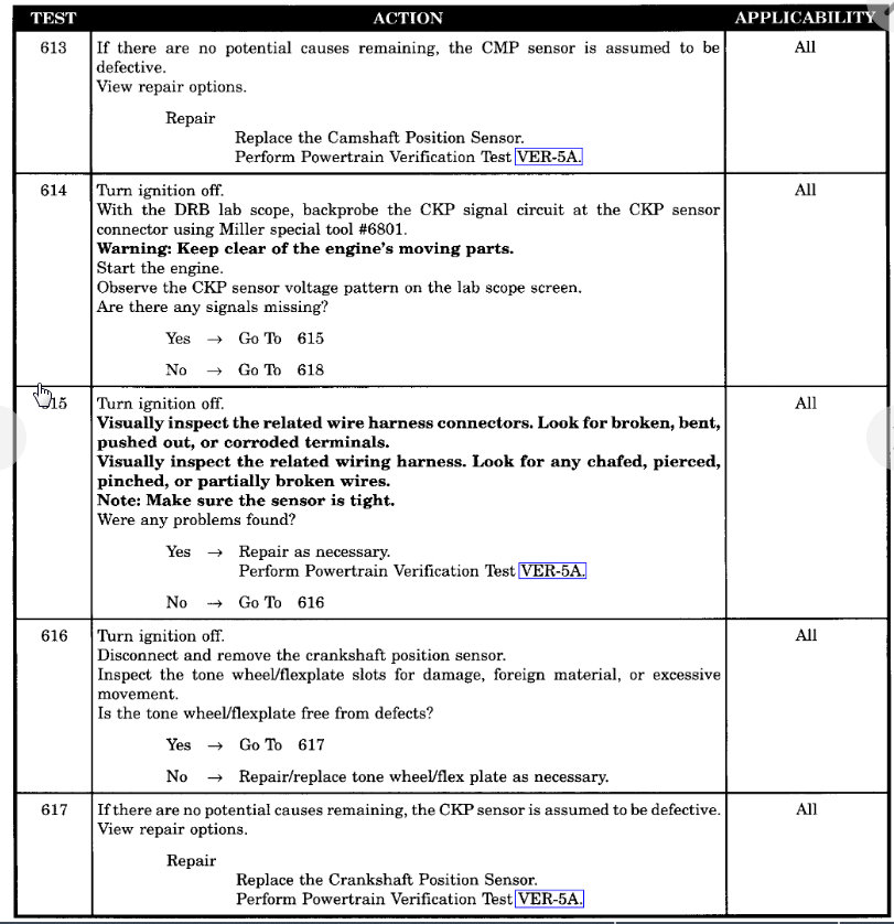

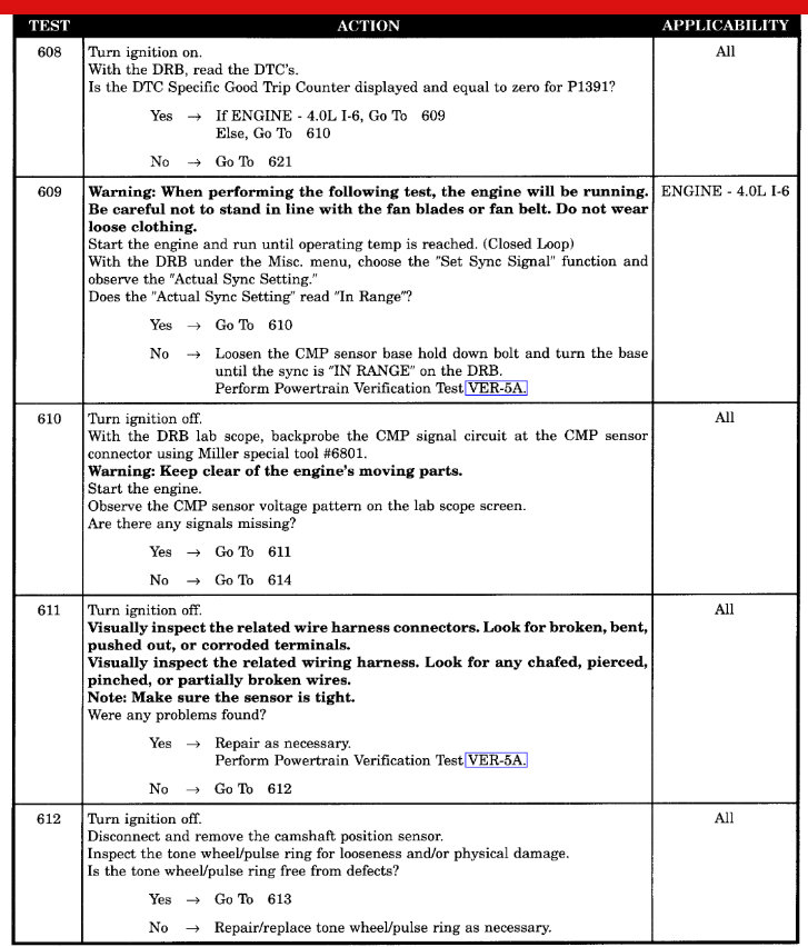

Morning, thank you for the information. I did send it to a mechanic, it gave me 2 error codes; 1495 and 1391. please advise on these error codes.
Oct 1, 2019 at 5:29 PM

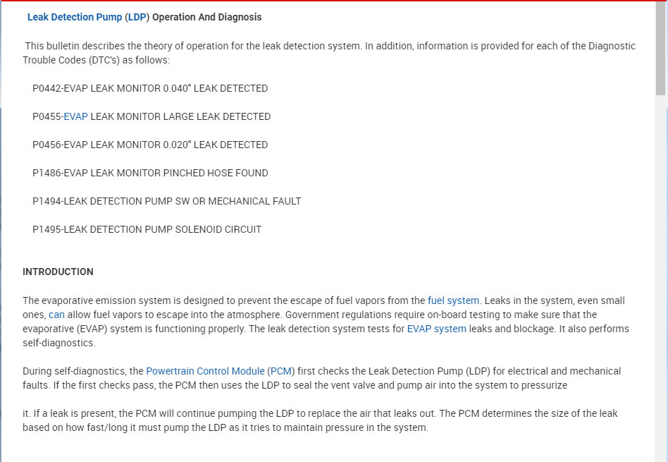

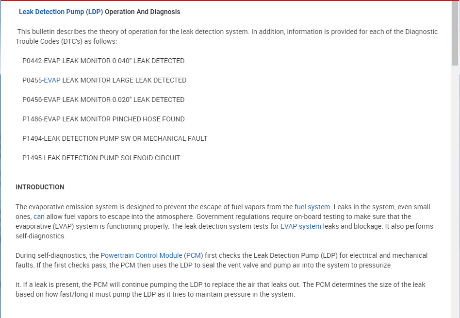

Attached are the details about these codes. Your stalling issue is most likely related to the P1391. The other code is just an emission code and while it should be addressed, it is not going to cause a stall issue.
Run through the test for the P1391 and let me know what you find. Let me know if you have more questions. Thanks
