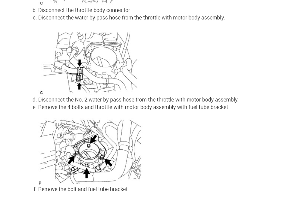

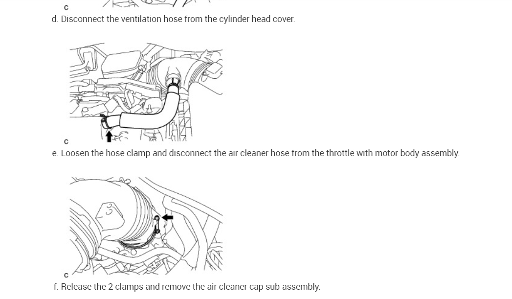

Car has stalled twice while going slow (turning at an intersection?.
Jan 30, 2023 at 11:22 PM
  • 55,691 POSTS

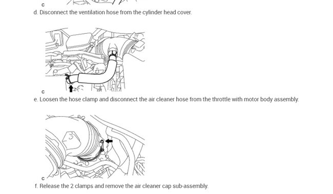

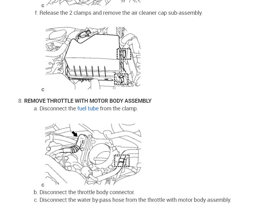

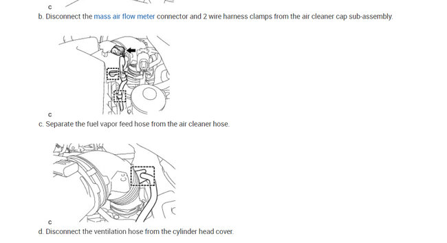

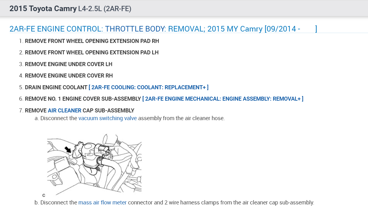

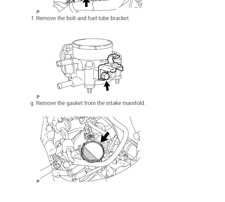

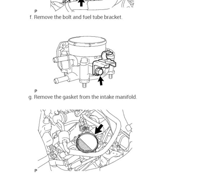

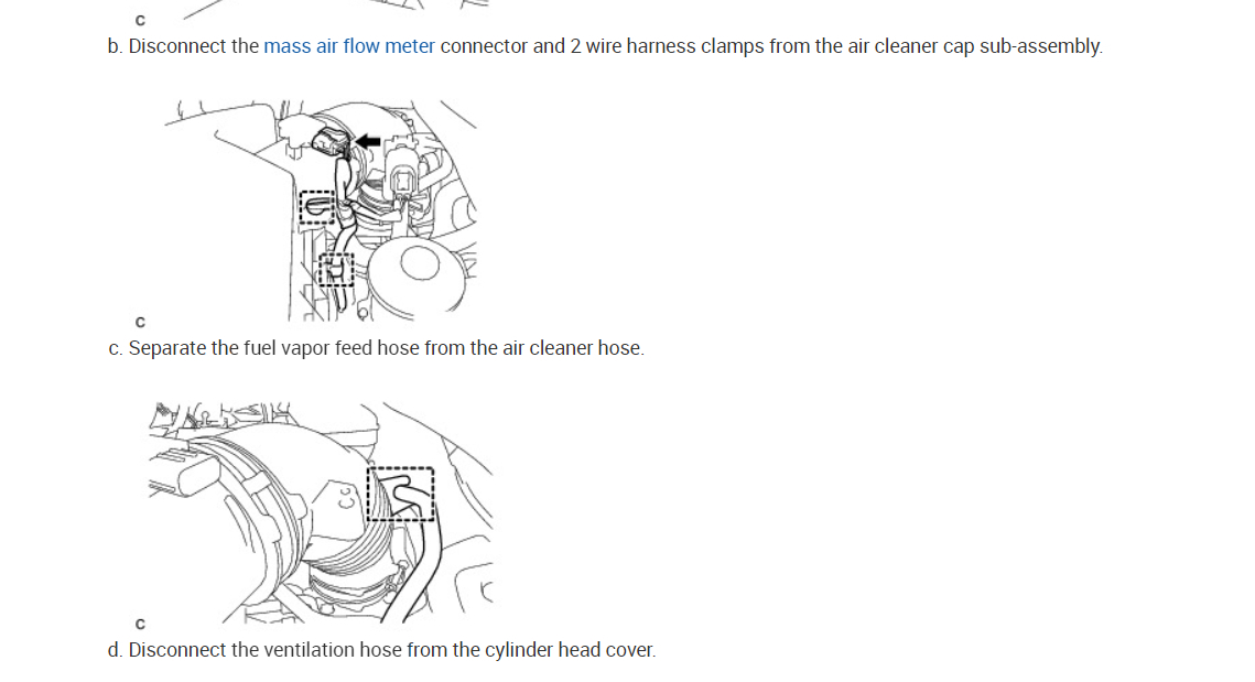

This is common when the throttle bore is dirty and needs service or you have a vacuum leak. Here are guides to help us fix it with instructions in the images below to show you how on your car:
Please use this guide when the engine is cold only:
This guide can help as well:
