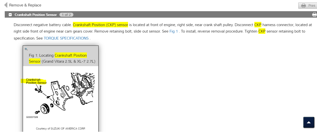

It isn't an uncommon issue. As far as replacing it, it's a little tight, but not hard to do. Here is a link that explains in general how it's done.
If you look below, I attached the manufacturer's directions.
Let me know if this takes care of the issue.
See pic below.

I realized that I forgot to add the link for replacing the sensor. Ugh! I'm getting old. LOL
Here it is:
I hope that helps. Let me know if you have questions and if that takes care of the problem.
