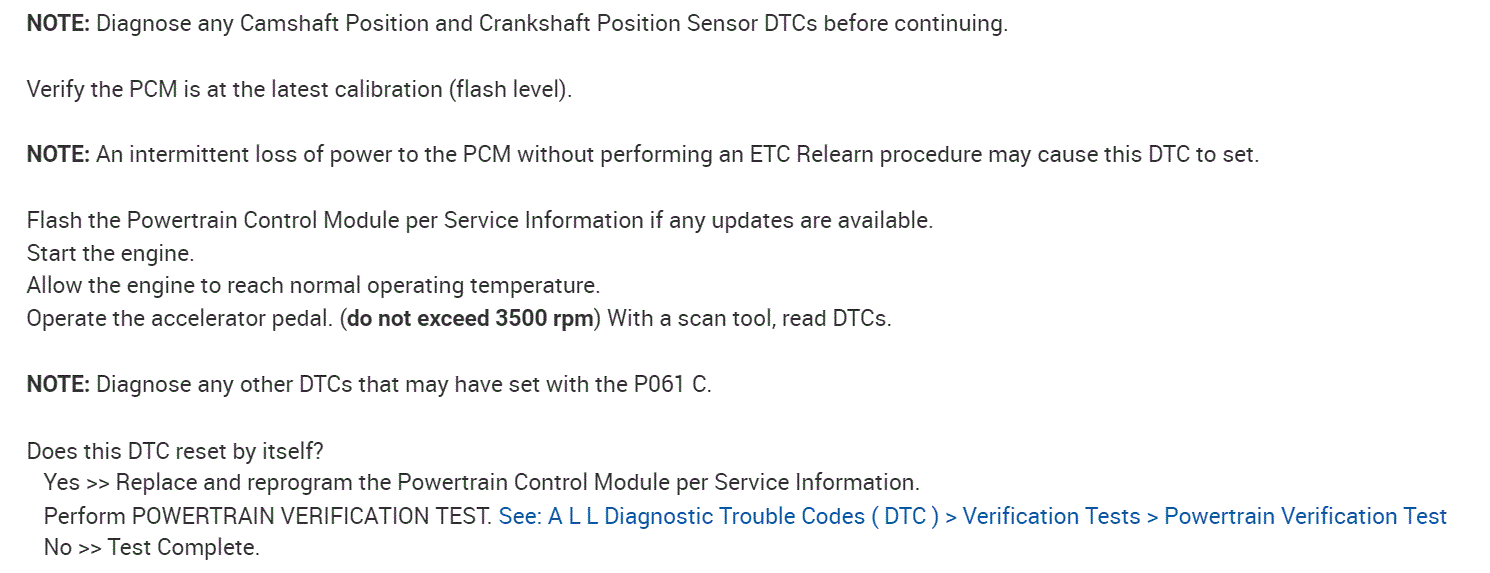

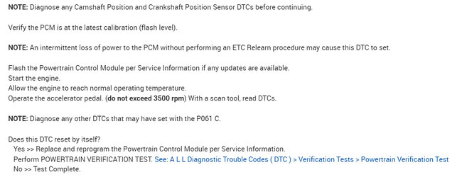

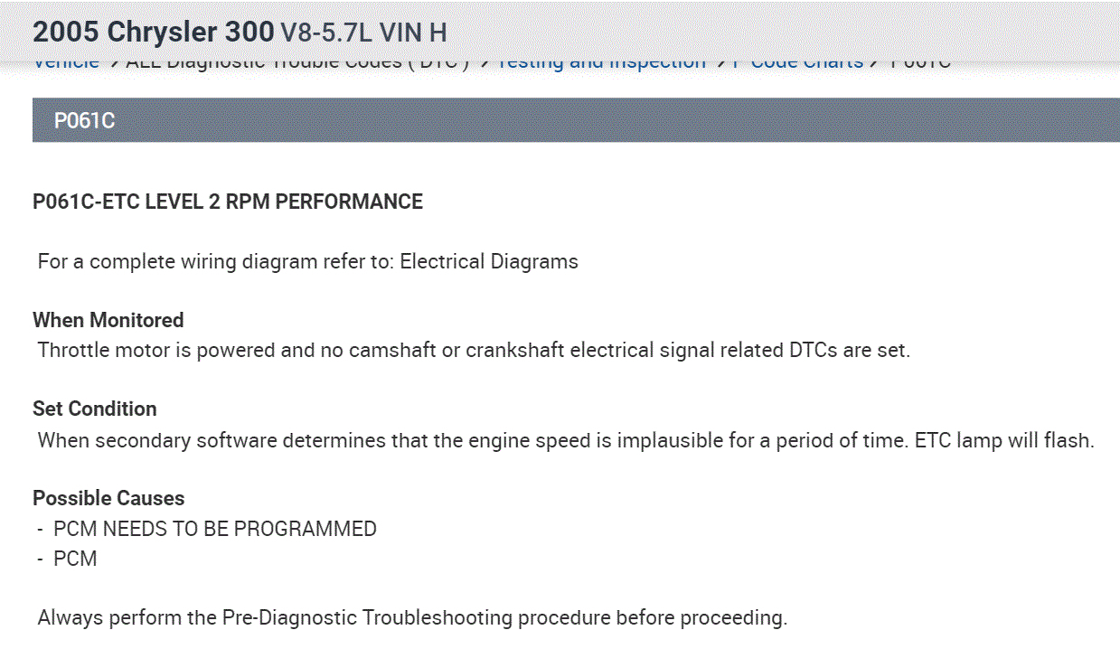

The interesting one is the P061C. This code is related to the electronic throttle control (ECT). I suspect there is an issue with the PCM. Either it needs to be flashed (reprogrammed), there are connection issues, or the PCM itself is bad.
I attached the directions for programming below. Let me know if this is something you have the tooling to complete. I realize the code may not have returned, but this is the direction I would suggest.
