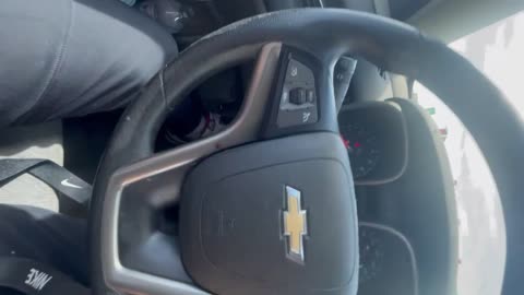

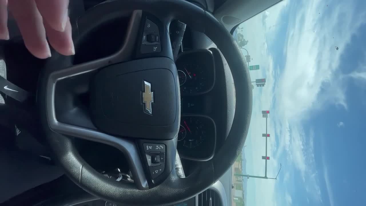

I drive the car listed above LS model. For about a month now my car has been stalling on me. When I turn it on for the first time it turns on with no problems. Once I drive it for about eight miles and I come to a stop at a red light it completely stalls and when I try to turn it on it sputters. It also tends to vibrate a lot. That’s really all I see.
PS. Sorry for the A/C and music in the video.

Hello Joe! Thank you for replying! No there is no smoke or odor coming from exhaust. Also, I have had a couple mechanics throw on the code scanner and no codes popped up at all. I should mention that I feel like my fuel is wasting too fast. I added the video.

Once it turns back on, I rev the engine a little so it doesn’t turn back off.

Hello Joe, it’s me again. So, I replaced the crankshaft position sensor and even cleaned the throttle body sensor. But unfortunately, the car keeps stalling. I did notice something that I did not notice before. Every time the car stalls the battery voltage drops from 14.3 to 12.5. Could it be a wiring issue, alternator or battery problem that may be causing this? Seems like no mechanic can find a solution. Thank you for your time.
