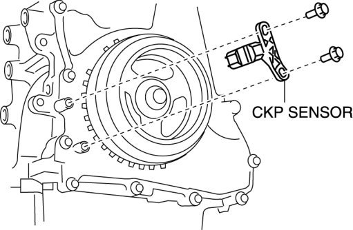

4. Disconnect the CKP sensor connector.
5. Remove the CKP sensor.

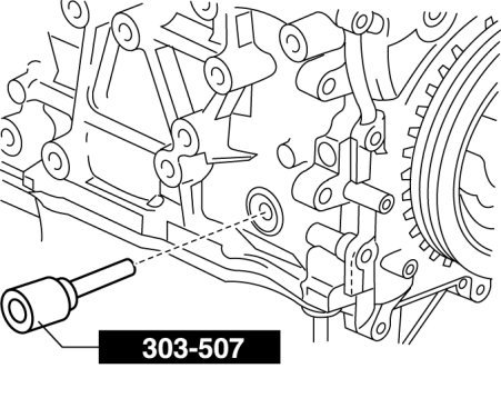

1. Perform the following procedure so that cylinder No.1 is at TDC.
a. Remove the wheel and tire (front right side).
b. Disconnect the drive shaft (RH) from joint shaft, set the drive shaft (RH) out of the way.(MTX)
c. Remove the cylinder block lower blind plug and install the SST.
pic 2
d. Rotate the crankshaft pulley clockwise until the crank weight contacts the SST so that cylinder No.1 is at TDC.

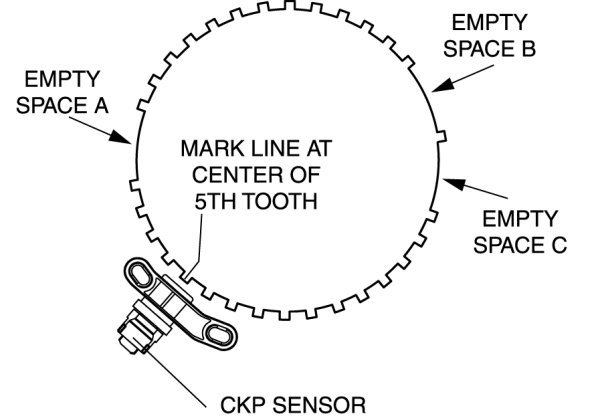

2. Fit the center of the CKP sensor with the fifth tooth (counting counterclockwise from the empty space A as shown in the figure) of the pulse wheel.
pic 3

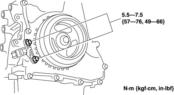

3. Install the CKP sensor fitting bolts.
pic 4

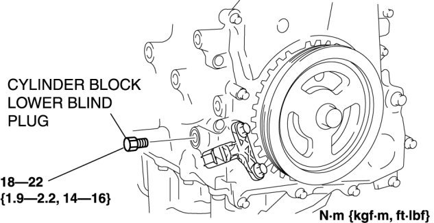

4. Remove the SST then install the cylinder block lower blind plug.
pic 5
