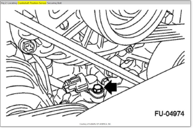

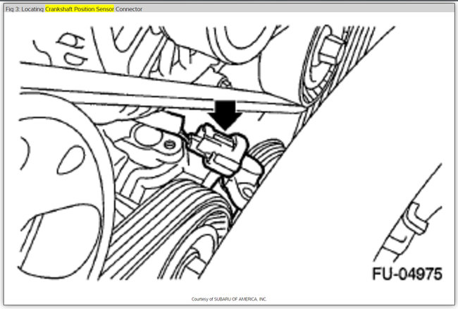

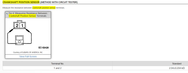

It sounds like your crankshaft angle sensor is going out but we should run the codes to see whats comes up first. Here is a guide for that.
If nothing comes up the crankshaft sensor can still be bad becasue it not always sets a come for a intermittent sensor failure which stalls the engine.

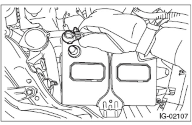

Here is a guide to give you an idea of what you are in for when doing the job.
Also when the engine doesn't start check for spark, if it does have spark its not the crankshaft angle sensor.
Here is what it will be like on your car (below)
