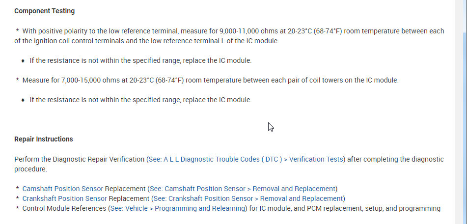

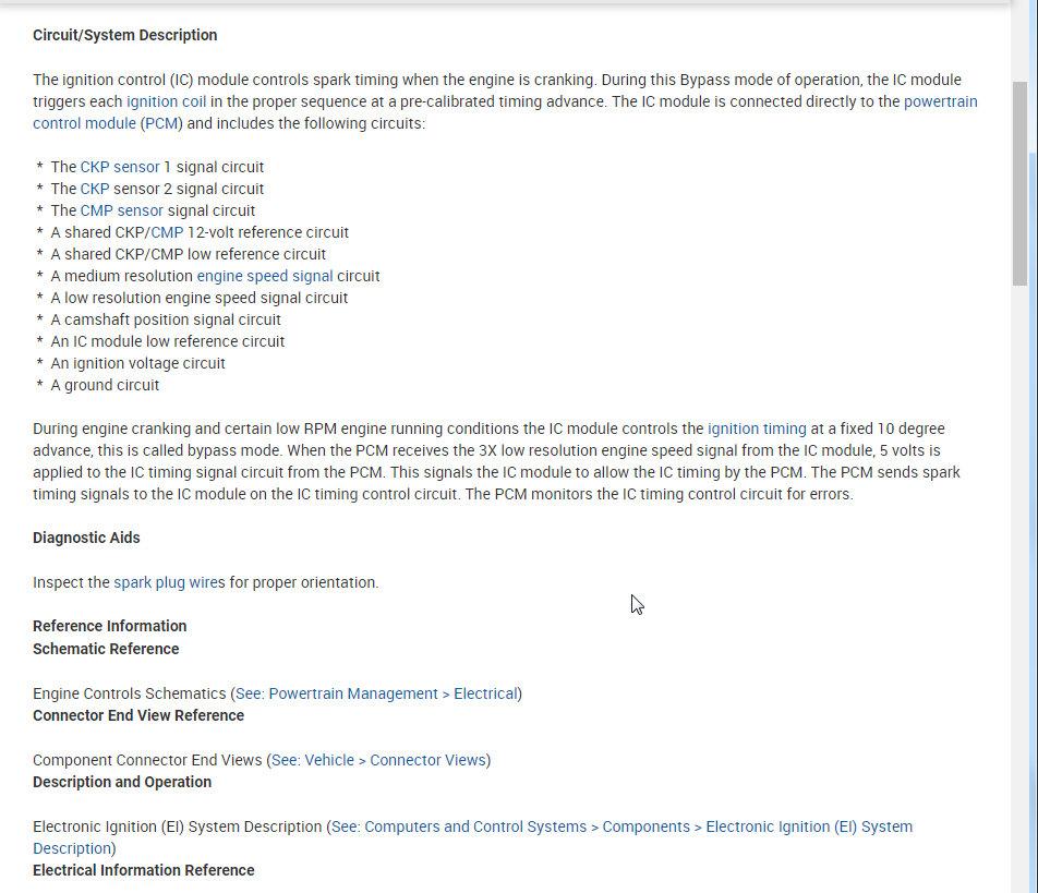

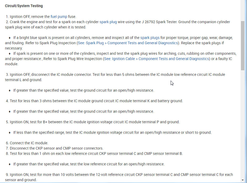

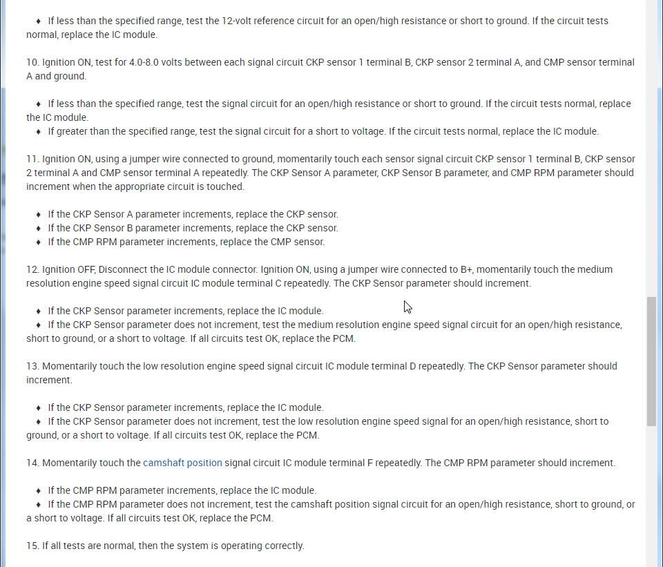

Okay. The most common thing is the crank sensor. However, I attached the testing that we need to run through to track this down.
Here is a guide that gets into more detail about this issue:
Let's run through this testing and see what turns up. Clearly there are other things that can cause no spark but as I said the crank sensor is the most common but I would not guess at it and run through this test.
