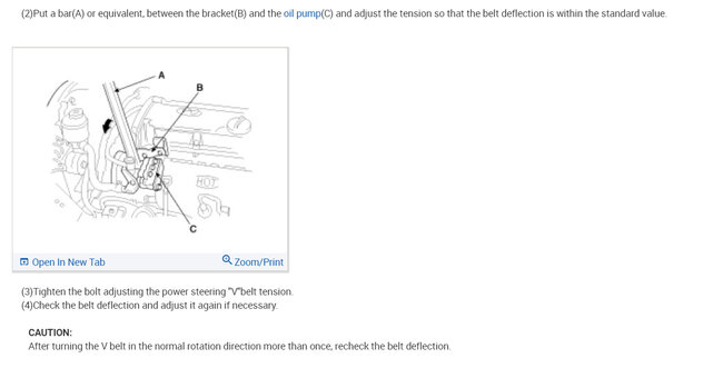

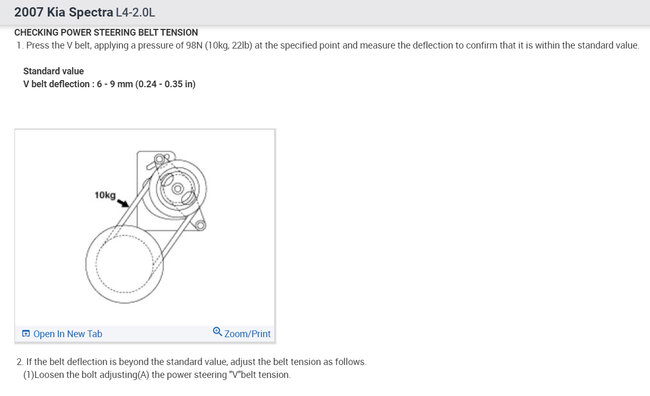

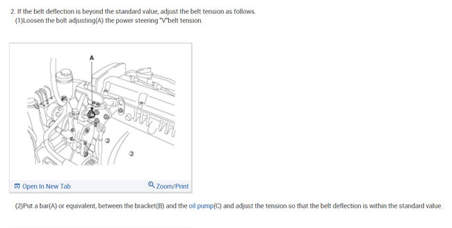

If you can upload a short video of the noise, I can tell for sure what's going on, but it sounds like a belt tension issue. The belt might look okay but if it is loose, it will make noise. check out the images below to see what I am talking about. Check out the images (below). Let us know what happens and please upload pictures or videos of the problem.

Thanks for replying, so a mechanic told me that and we did adjust it and still same the belt is not loss we already check it out the belt not cracks or anything belt conditioner didn’t make any difference, I googled symptoms of bad rack and it’s a lot of the stuff the car has I’m going to reply video .

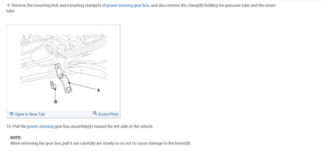

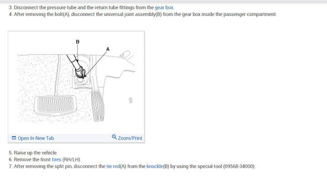

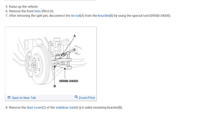

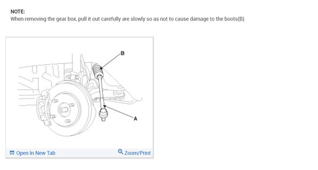

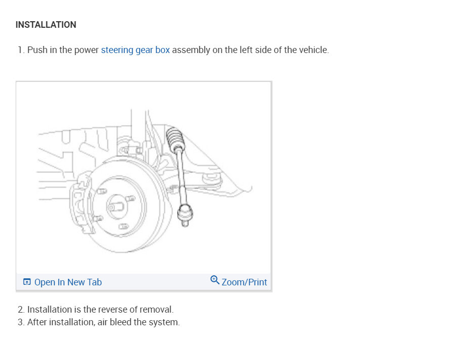

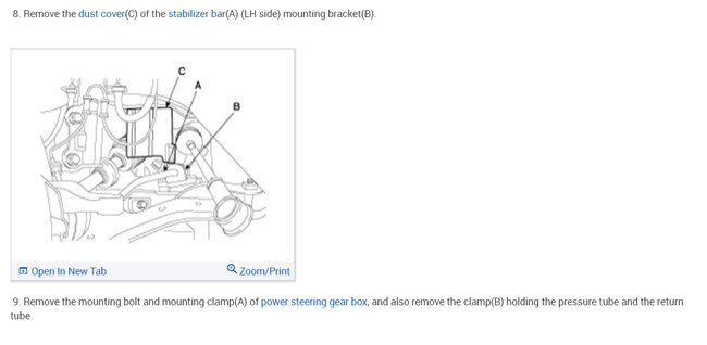

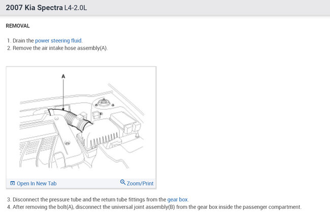

Yep, that looks like the rack or pump is bad, have you flushed the fluid? It seems like the power rack selector valve is bad which is laboring the pump. Here is how to change the rack out and you will need to have the toe adjustment done for the alignment. Thank you for the video. Check out the images (below). Please let us know what happens.
