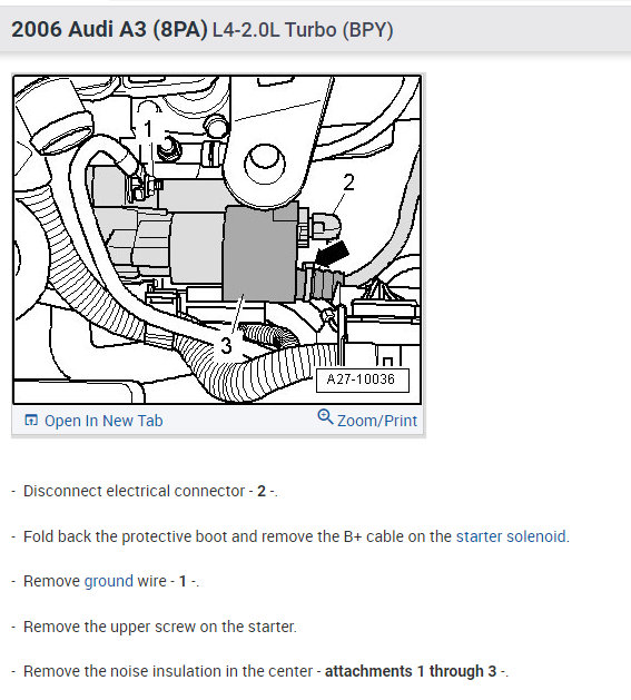

The car can not crank the engine over?
Dec 4, 2014 at 3:48 PM
SQM
  • 6,383 POSTS

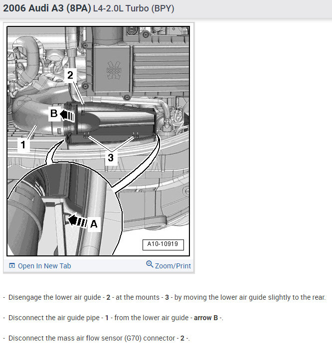

Just so that we cover the basics, have you tried to jump start the car?
If you are able to jump start the vehicle and it runs normal, then you likely have a bad battery.
https://www.2carpros.com/articles/how-to-jump-start-car-battery-using-jumper-cables

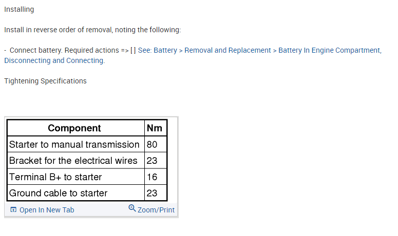

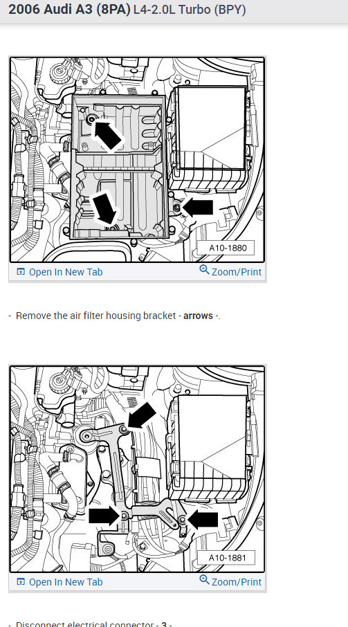

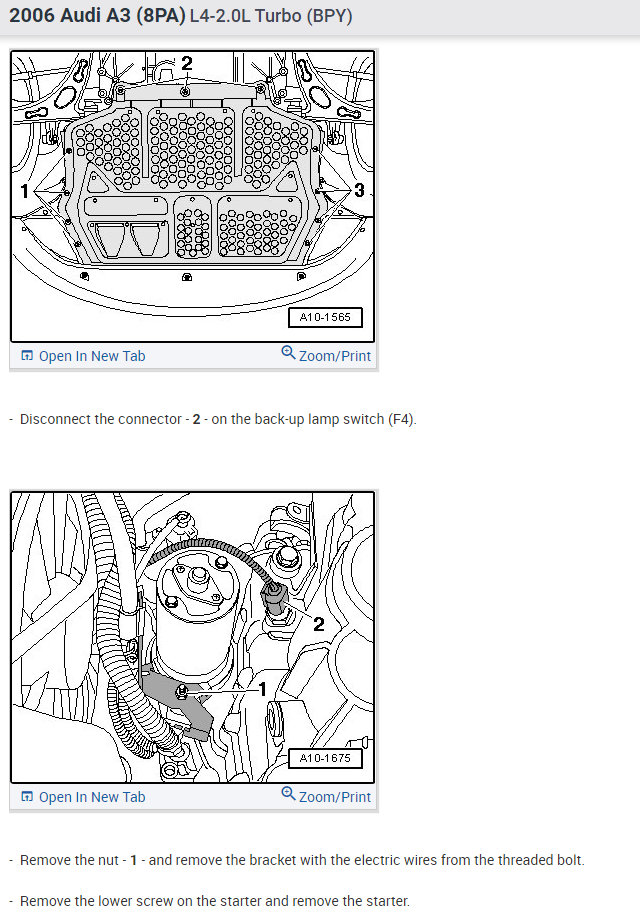

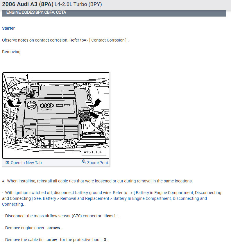

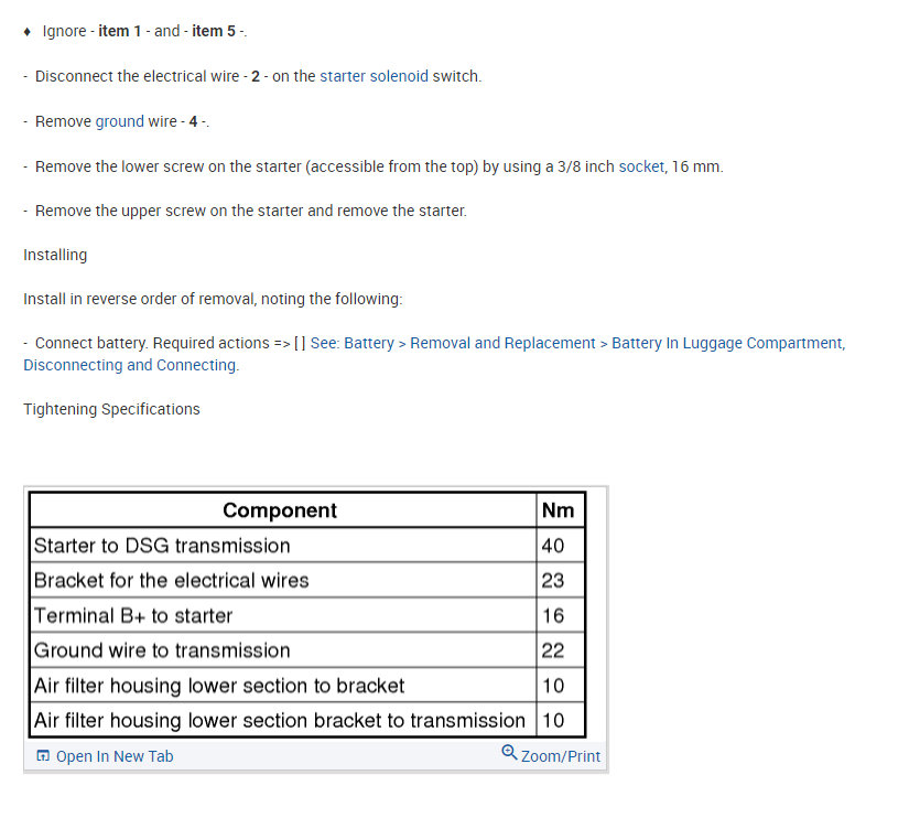

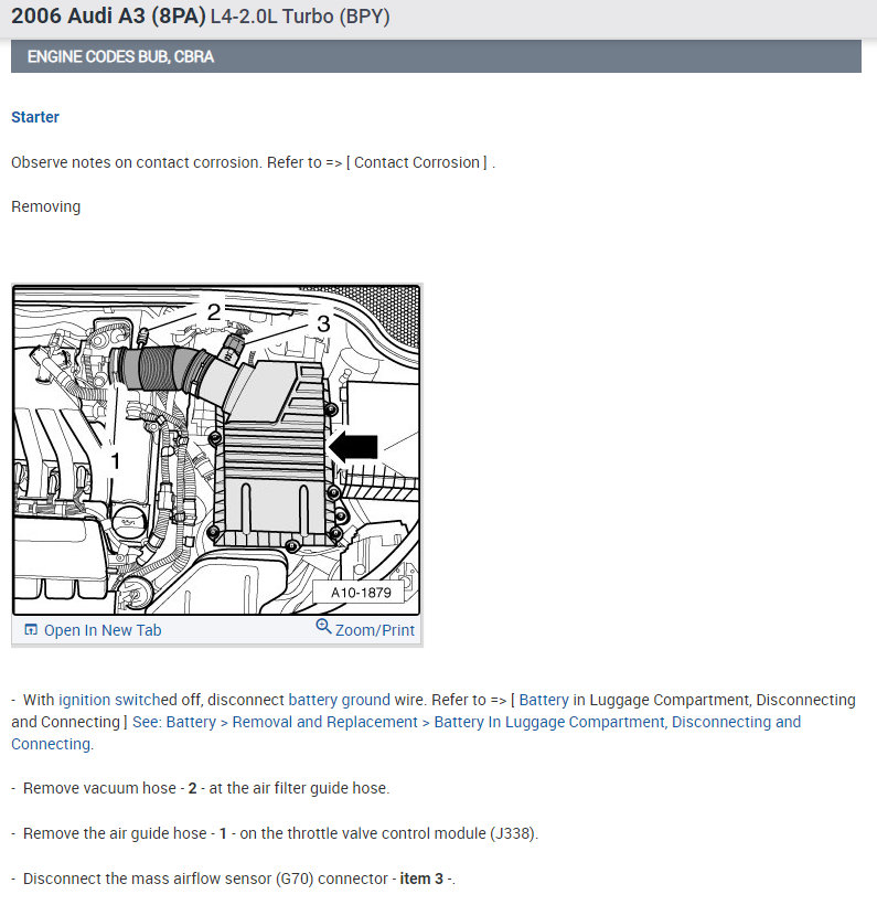

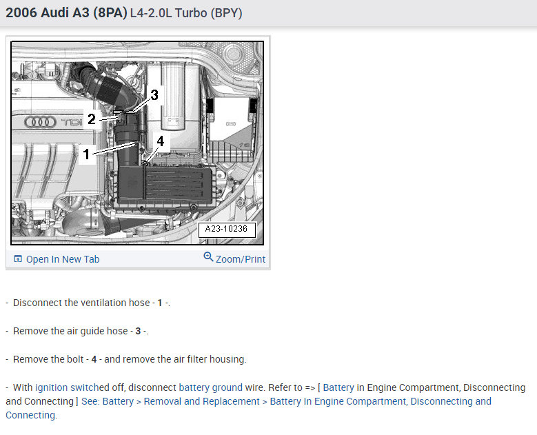

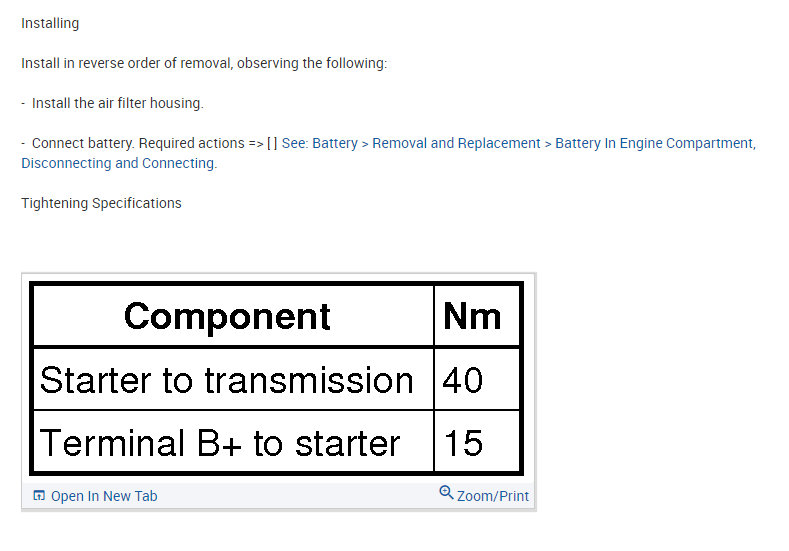

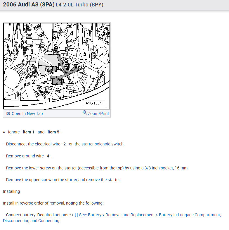

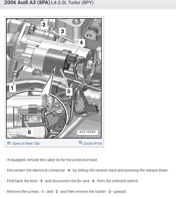

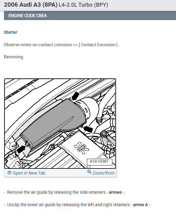

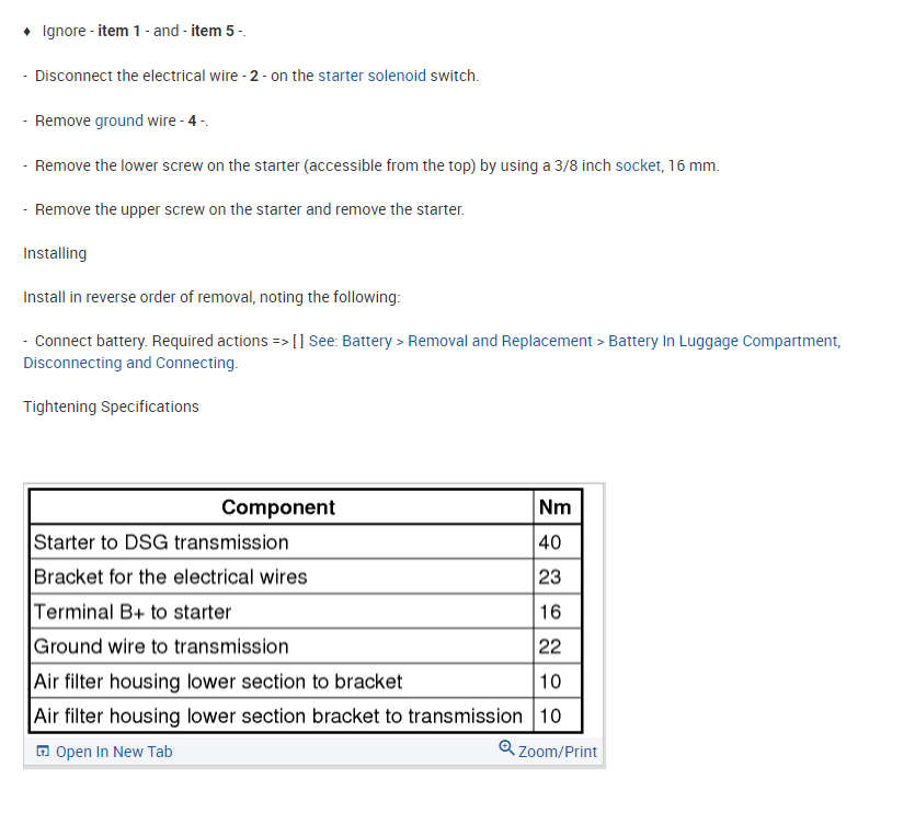

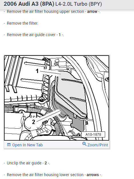

If you are unable to jump start it and the starter only clicks and does not crank the engine, then the starter is likely the issue.
Here is a helpful guide:
Depending on the engine code of this A3 there are three different starter and replacement procedures. I have attached all three for your reference.
