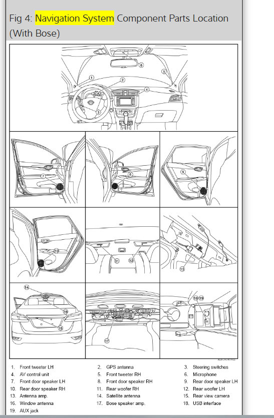

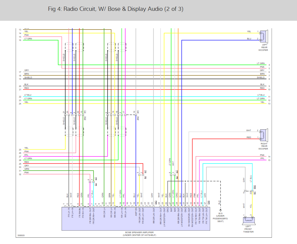

When I try to turn my radio on, I get a loud static noise from the speakers. The noise will not stop unless I turn the car off. Could I have a blown fuse? Or a bad speaker?
Mar 17, 2019 at 4:50 AM
  • 55,224 POSTS

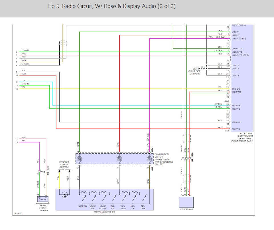

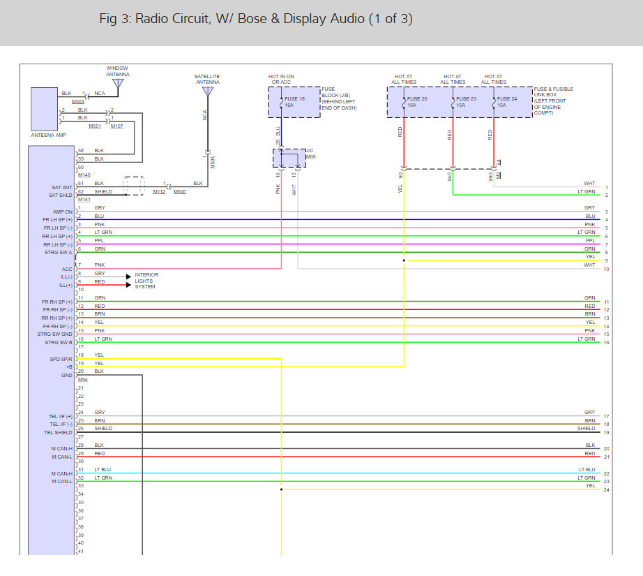

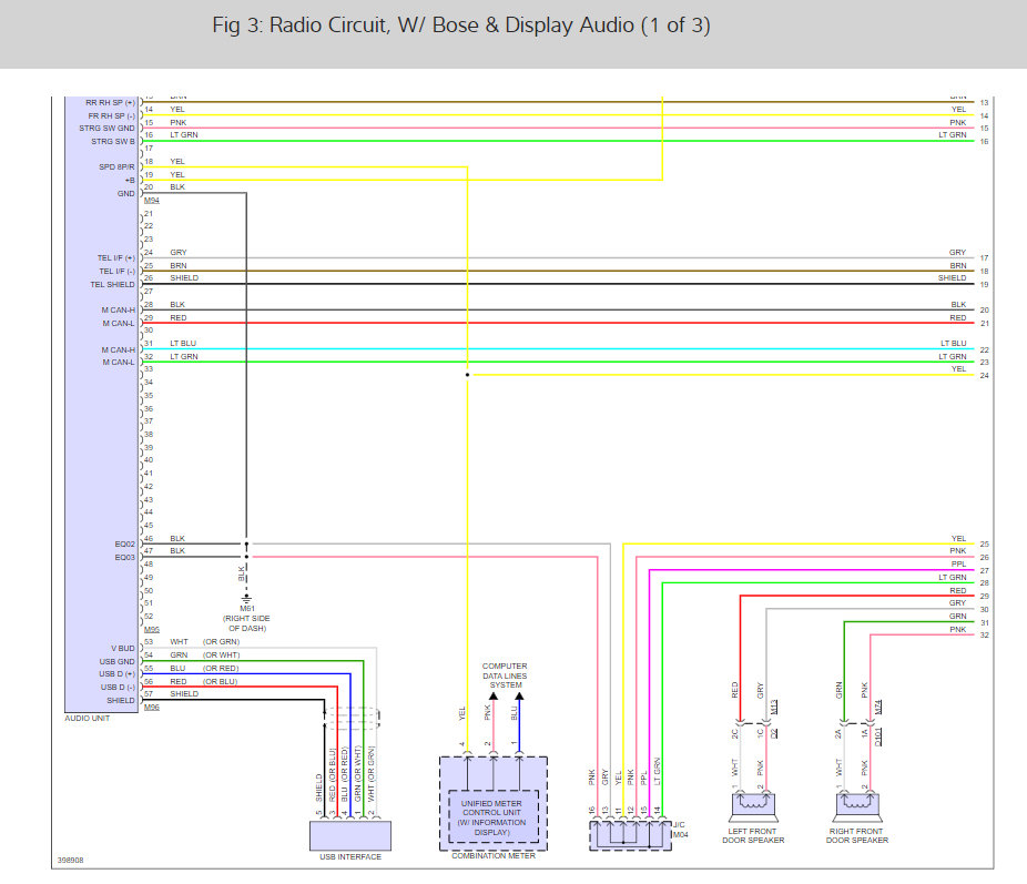

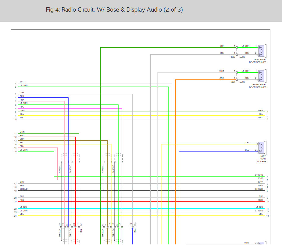

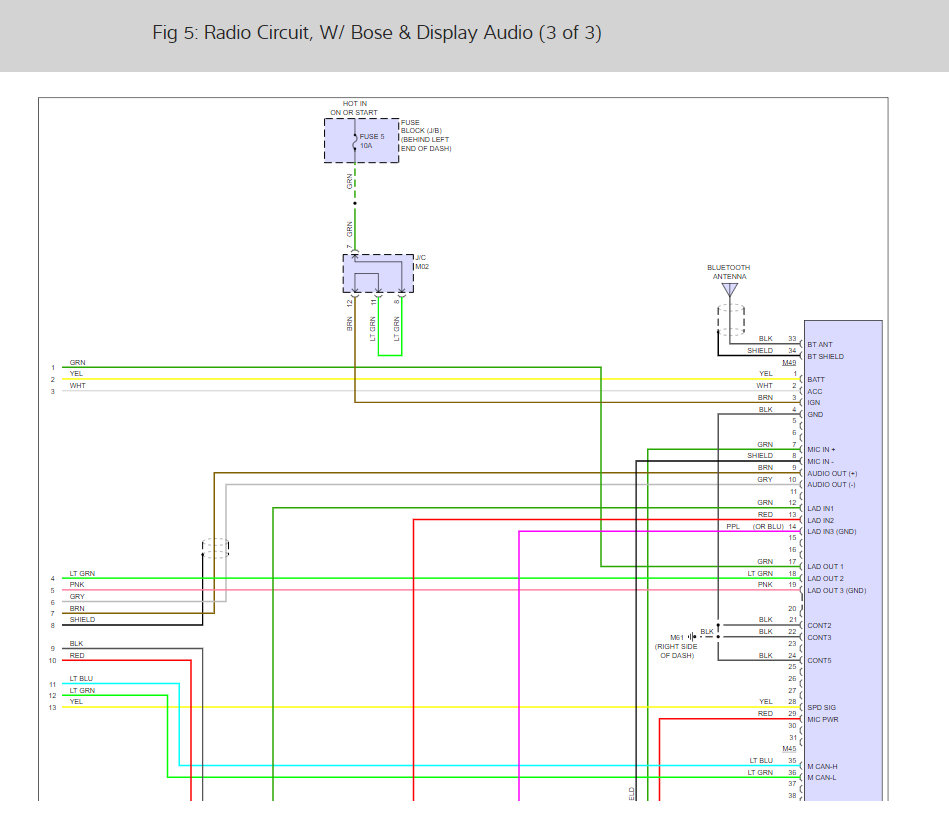

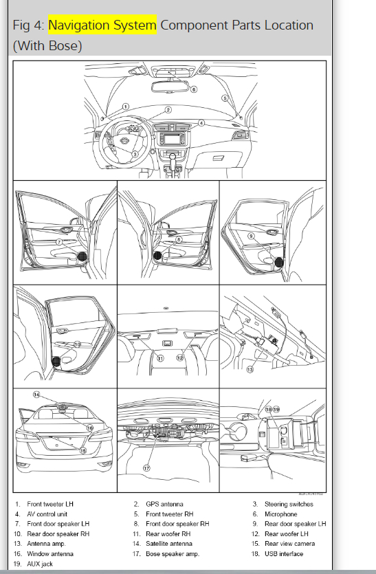

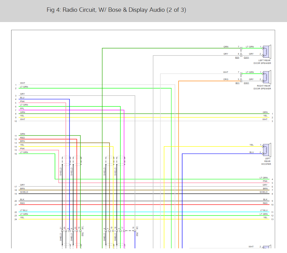

It sounds like the amplifier has gone out. but to be sure lets unplug it to see if the noise stops. Here is the radio wiring diagrams so you can see how the radio works and the location of the Bose speaker amplifier. Check out the diagrams (below). Please let us know what you find. We are interested to see what it is.
