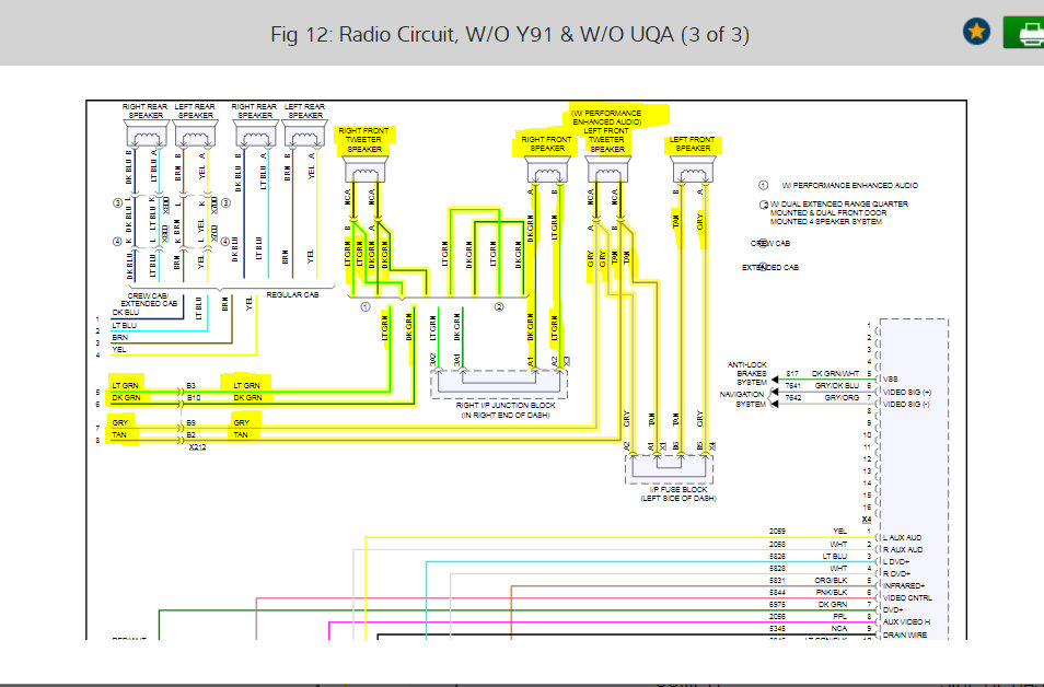

I was gonna buy a new speaker and and I was gonna just buy the 45 dollar speakers fro the front doors. i don't know if they are subs or not.

Okay, no problem. In the diagrams down below I have included the wiring diagram for the speakers of your vehicle. I have the wires going to the front speakers and the wire colors highlighted for you. Please us the wiring guide to install your new speakers and use female spade connectors on the snipped wires end to connect them to your new speakers. Please get back to us with how everything turns out.
