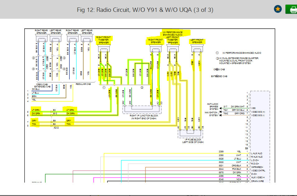

I have the truck listed above two door 1500. I saw your video on the car speaker installation and my question was can you please give a more in depth review? i don't want to damage my truck at all.

Are you just replacing the speakers or are you replacing the stereo as well. Are you installing a sub woofer and amplifier combination or a combination of any of the three or all three?

I was gonna buy a new speaker and and I was gonna just buy the 45 dollar speakers fro the front doors. i don't know if they are subs or not.

Hello again,
Okay, no problem. In the diagrams down below I have included the wiring diagram for the speakers of your vehicle. I have the wires going to the front speakers and the wire colors highlighted for you. Please us the wiring guide to install your new speakers and use female spade connectors on the snipped wires end to connect them to your new speakers. Please get back to us with how everything turns out.
Thanks,
Alex
